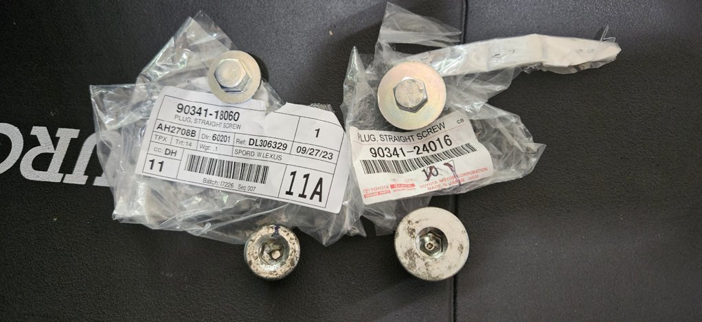

    And if you plan to swap the front fill/drain plugs for the Lexus ones, you'll need:
    Drain Plug: 90341-24016
    Fill Plug: 90341-18060
    vme and eurowner like this.

    I do already have a fluid pump. I'm hoping I won't need it with the oil coming in a bag.
    I also did order the gasket kit, will change those out too.
    Maybe I'll order the plugs to have in case.
