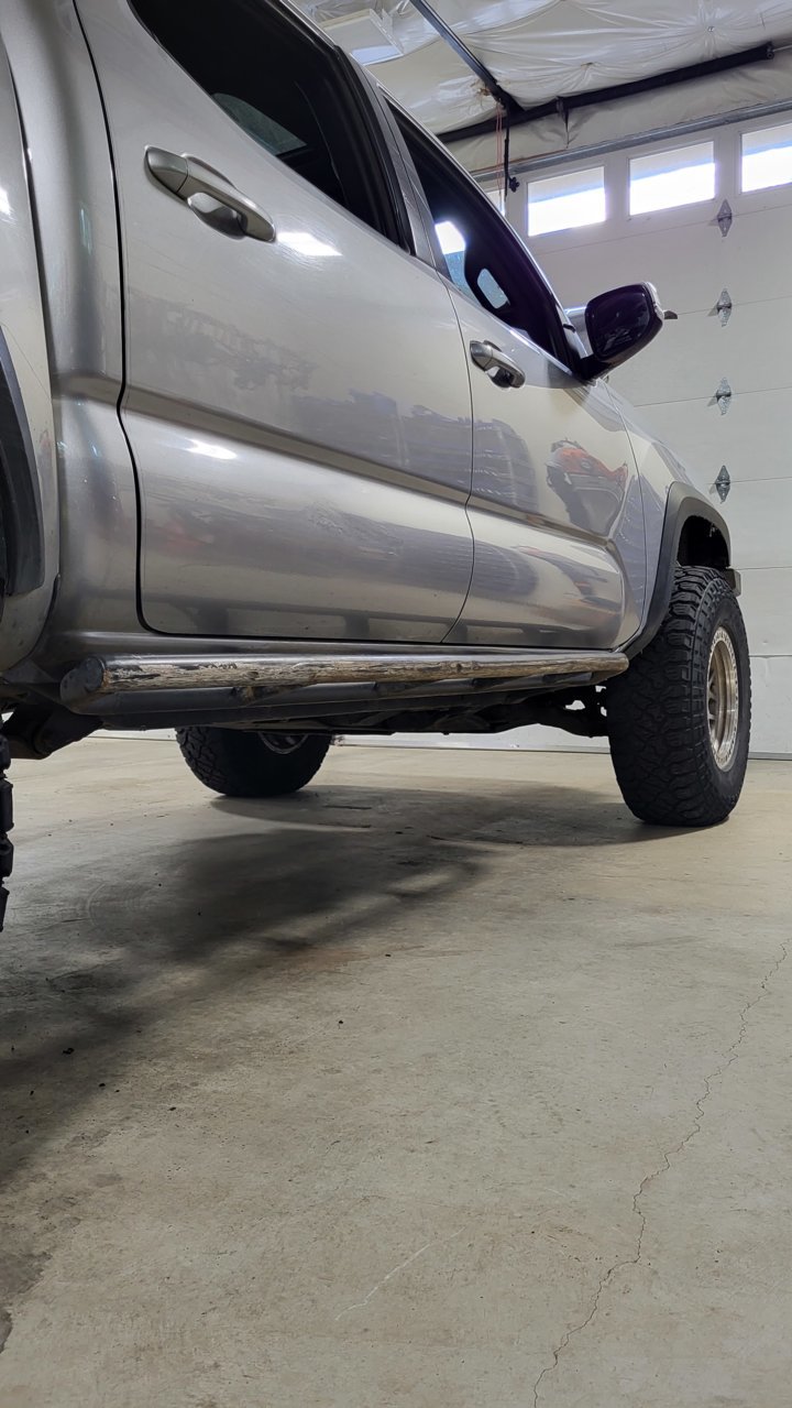

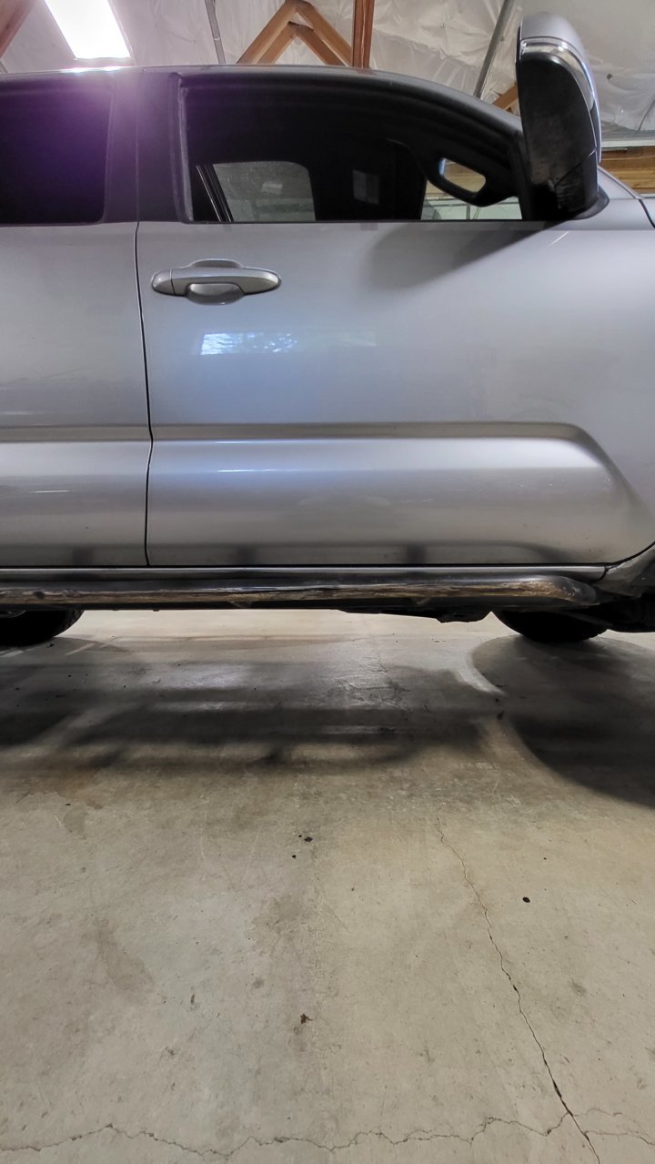

    My dom ones bent up and bent in a good bit, along with probably a dozen dents.
