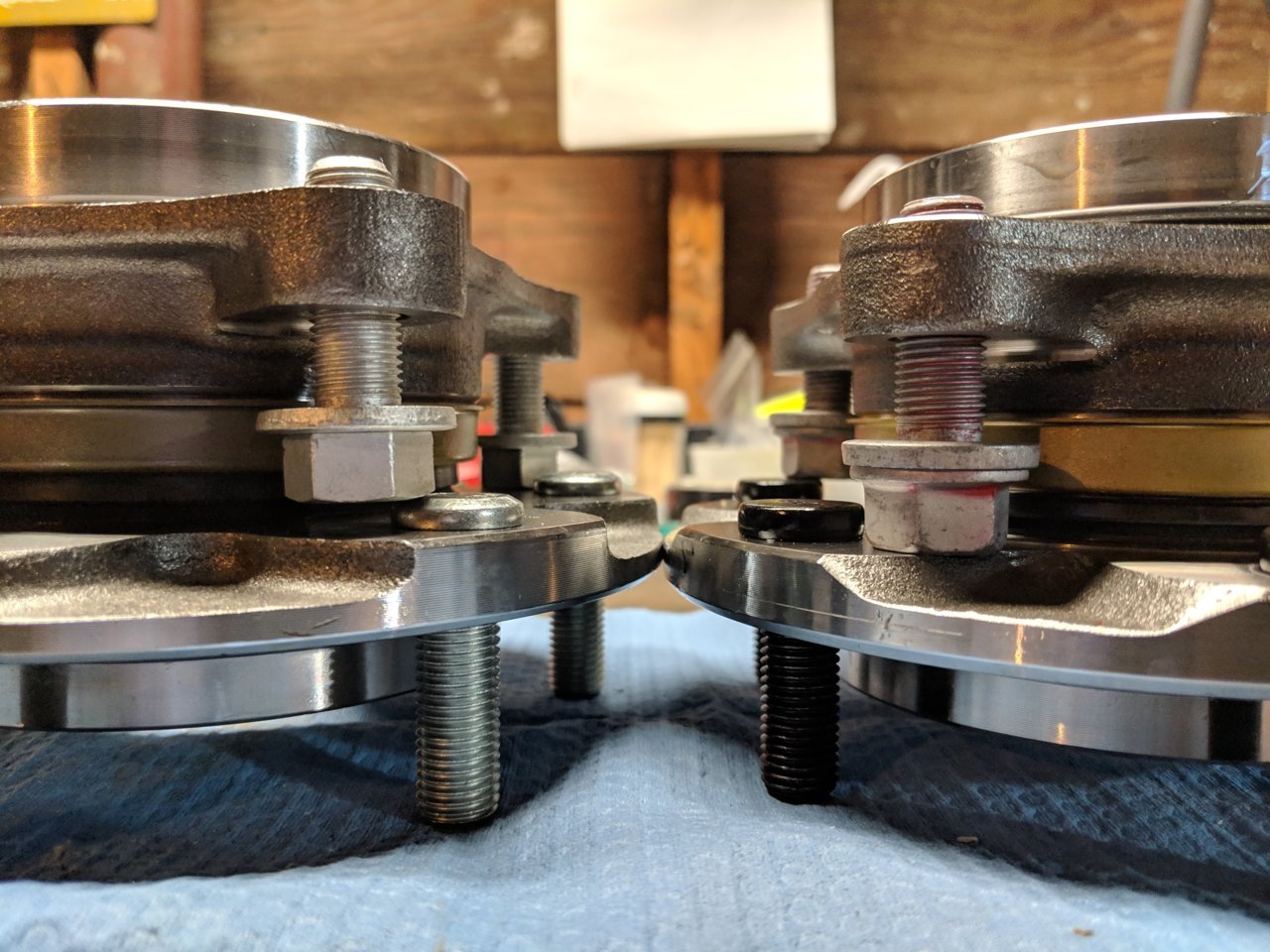

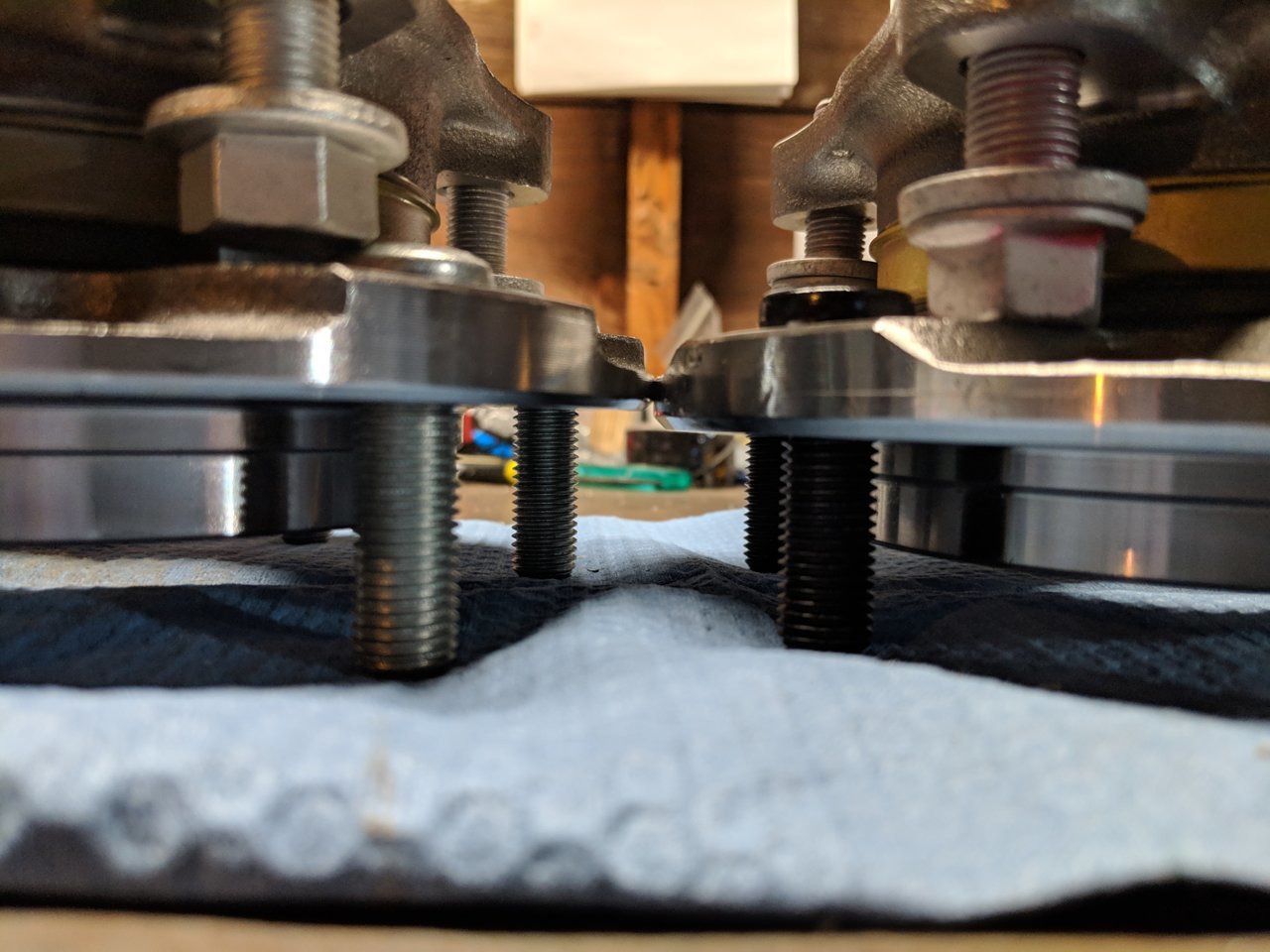

    The JBH are shown on the right in the photos and the left is the ebay unit:

    Now for the minor differences:

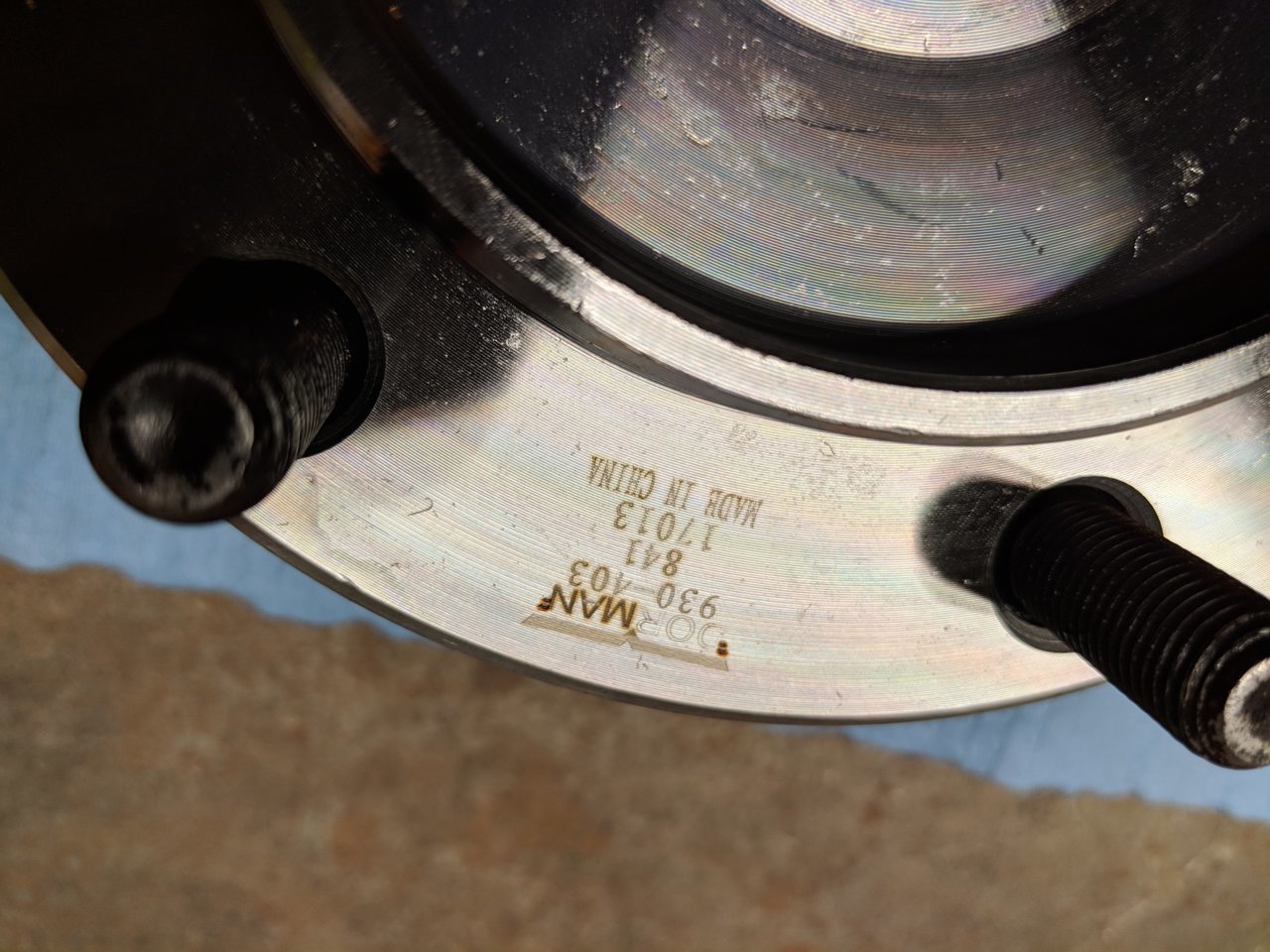

    Wheel Hub - Both come with grade 10.9 studs
    JBH uses the Dorman 930-403 wheel hub with shorter studs with a black finish
    Ebay uses an US Auto 930403 wheel hub with shorter studs
    In addition you can see below on the right (JBH) side the nut/washer uses a flared nut and washer combo vs the standard hex nut and washer on the left (ebay) side.

    JBH - Wheel Hub:

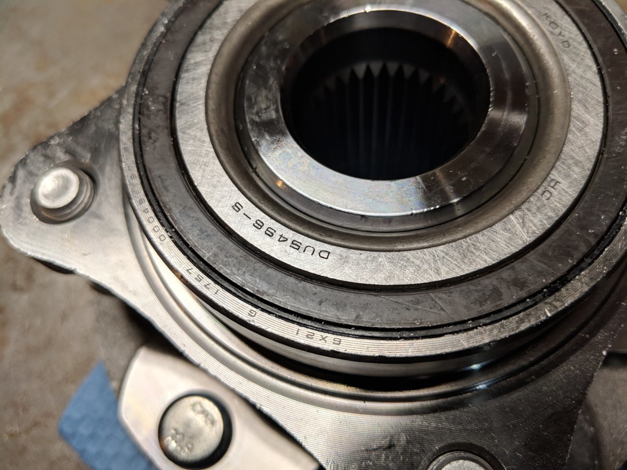

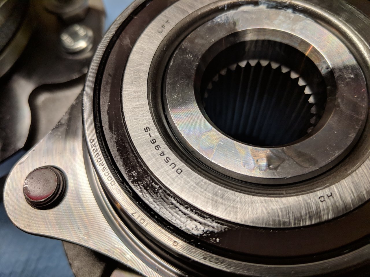

    Bearings:
    Both state that they are Koyo bearings however the markings of the Ebay hubs are different font wise. It's a hard call to see which is a real Koyo but as you can tell below there are differences in the bearing font and some of the details like the machining finish etc. I couldn't get the camera to focus on the surface close enough to show it but there is definitely a difference in bearing finish.
    JBH Koyo Bearings:
    Ebay Koyo Bearing:

    If you google koyo bearing counterfeits, a ton of stuff comes up. There are a ton of counterfeits out there, and telling which are which is very difficult. The best insurance is to get the bearings from an authorized KOYO dealer.

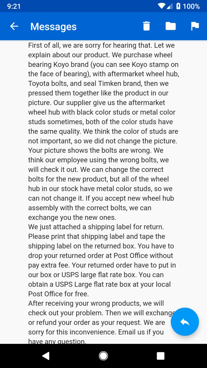

    From the vendor regarding the hardware and the authenticity of the koyo bearing. I'll be sending these back since it does look like a koyo knock off and will not be requesting replacements. I did some research online and have found similar looking photos of the font that authentic koyo bearings and these don't look legit. In fact they resemble the knockoff photos I was seeing online.
    Thanks for reading all just wanted to share my experience - sometimes pricing is just too good to be true!

    Thank you for researching this. That reply is from the Ebay seller correct? The bearings are almost certainly counterfeit.

    Yes that is straight from them
