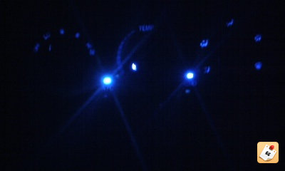

    Has anybody installed these to replace the Climate Control lights in the 2nd gen? I have one that burnt out but I was reading in the forum here and some people mentioned that the LED's are not as good as the bulbs. Any feedback?
    ⚫A/C Climate Controls lights - 2. $4.98
    http://www.oznium.com/corvette-c5-led

    Those are what I have. Here they are. y2y6ezeb_297606c804e05b23edf605ee3d3b1a12eae11761.jpg
    Picture doesn't do it justice on how good they look at night
