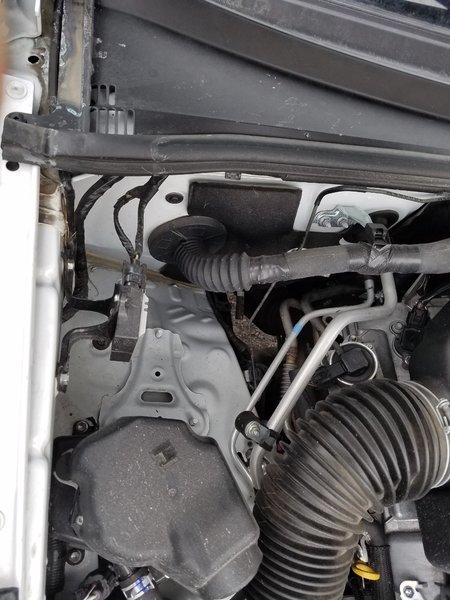

    M8 x 1.25 for the engine bay studs on the passenger fender (and the driver side blank holes high up behind the ground hole).
    T30 Torx for the bed pockets
