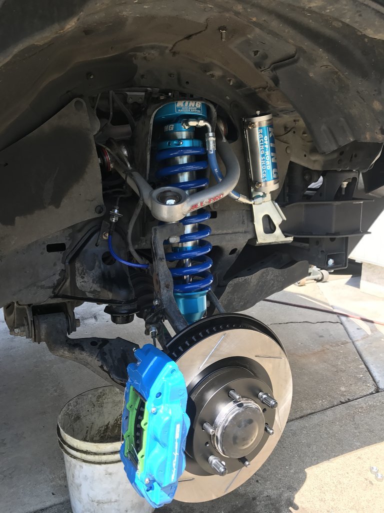

    With that the install is complete! We had some other work to do before we complete the after install test.

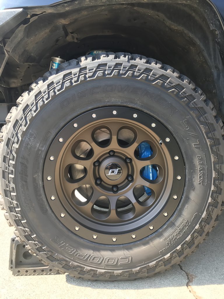

    The 4Runner setup looks bad ass behind @SCSPerformance Ray10's. Really fills up the 17" rim well. The StopTech Rotors are a nice touch.
    And with that we are done and off to record some post install stops. We also added the Dakar 29XL leaf to the existing Dakar Leafs. That will be the only major difference in the after install test.

    Ran into 2 problems doing mine. One was because of a flaw from the factory
    1. The short hardline from the factory caliper to rubber line, on the rubber line side the flare was all jacked up. I ran to the hardware store and bought an 8" pre fabbed line and bent it to fit. No big deal
    2. I went with EBC pads. Idk of it's the pads or the rotors, but the pads came with these sleeves that are the "shims" that snap into place in the pistons. With those in, the pads would not fit! I rebuilt my calipers so the pistons were bottomed out. With them removed the pads just barely fit. Once I "bed" in the pads I'm going to see if I can fit those shims in there. But I don't think it'll be a problem running them without them
    The initial bite is stronger. Not a big crazy upgrade, but I wanted to replace the rotors and pads anyway, and I wanted to build something or spend some free time working on something for the truck. I got the calipers on eBay for like $80 for the pair, so I took my time and smoothed them up, painted, sticker, cleared them. Because why not
    Thanks for the initial write up!
    I have the rear lines to swap as well, I just didn't do it because I was beat after today. Plus just pulling the clips and breaking the lines loose on the top end of the lines is going to be a pita probably

    Can anyone confirm this will work with sport 17" wheels?

    Should work fine. They work with stock 4 runner wheels.

    Looking good. Interesting if they need the shims. Curious if you have to have those. I almost went with the same pad.

    I hear a little bit of brake noise while creeping up at a stop light. This weekend Ill pull the front tires off and see if theres enough room to put the shims in. Im betting that since I rebuilt the calipers that the pistons weren't COMPLETELY pressed all the way in
