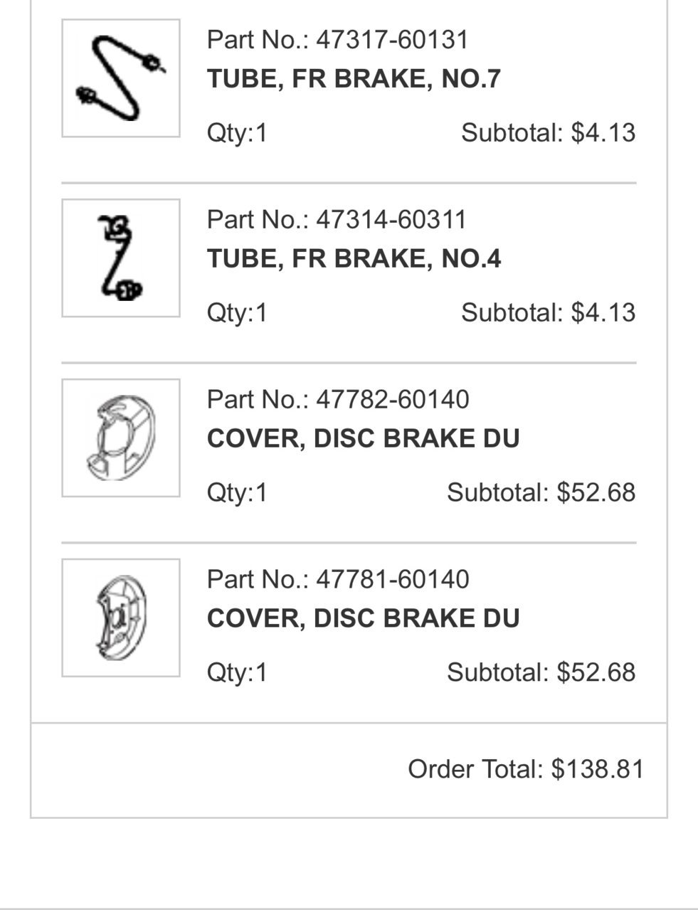

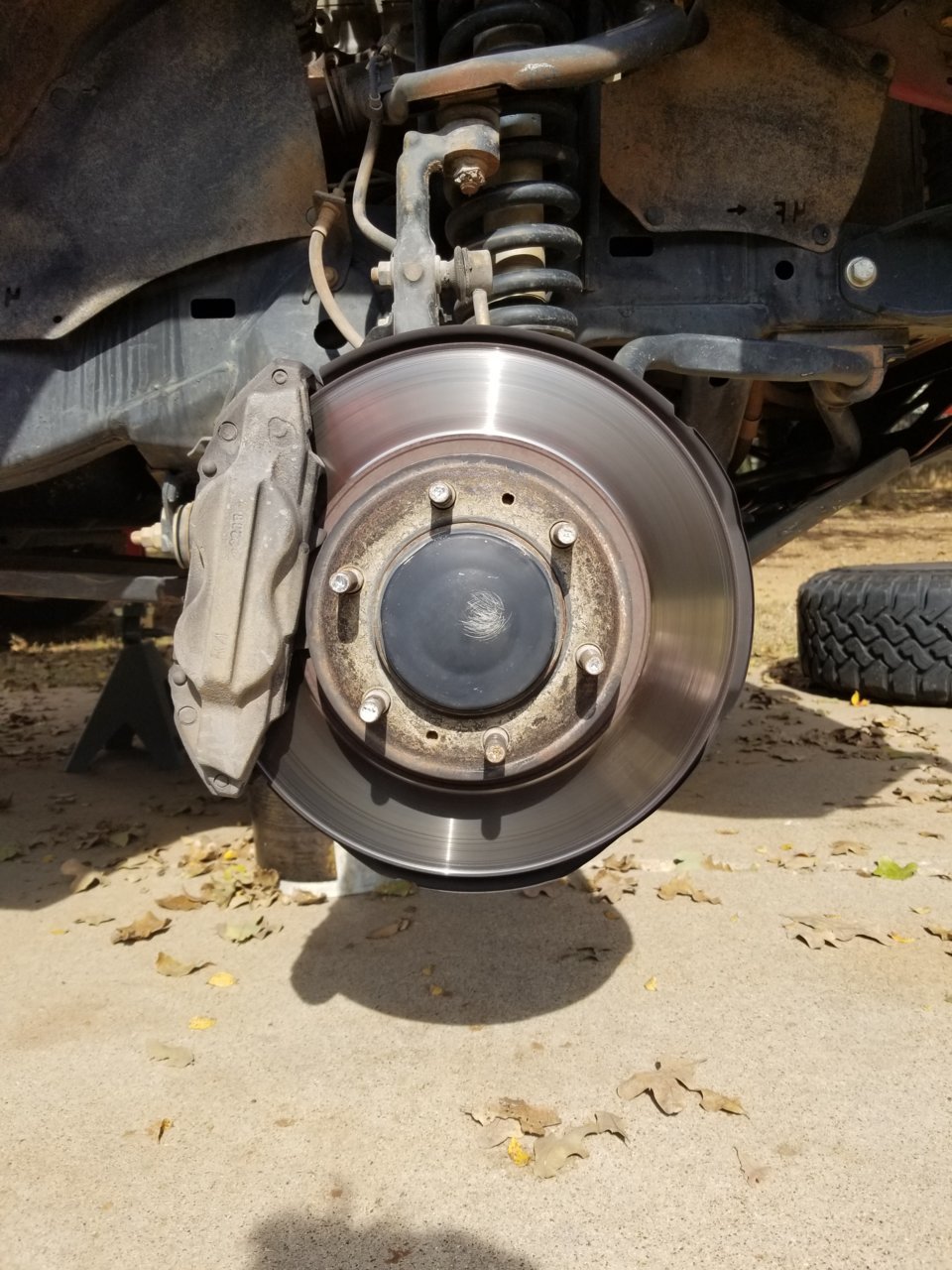

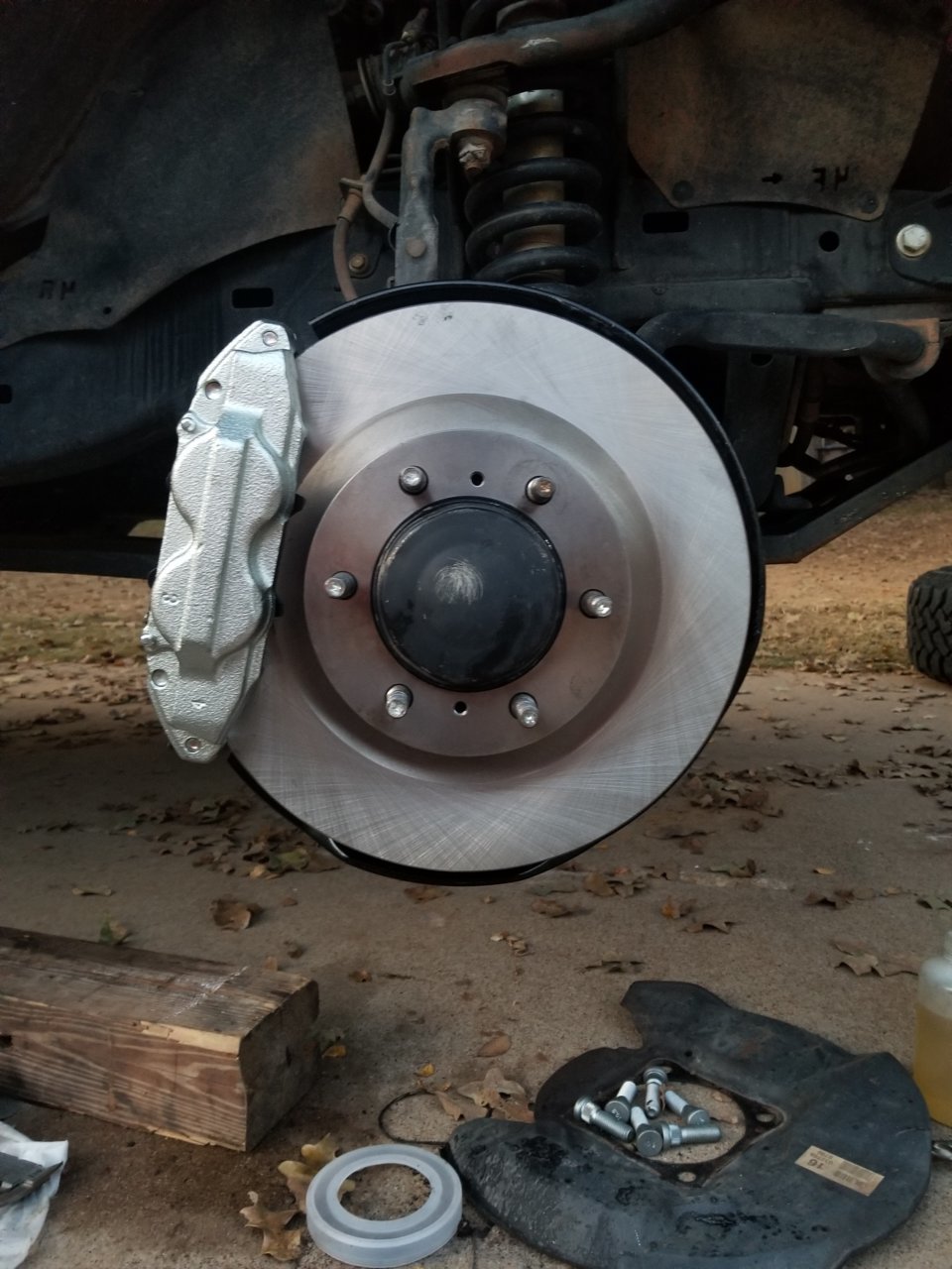

    https://www.ebay.com/ulk/itm/273524027454
    Just did my brakes on my 05 Taco so you do not need wheel spacers. And the link is what I order from EBay, comes with everything!! You only need to order dust shield (hassle of hammering things to fit) and *optional* brake tubes. That’s it.

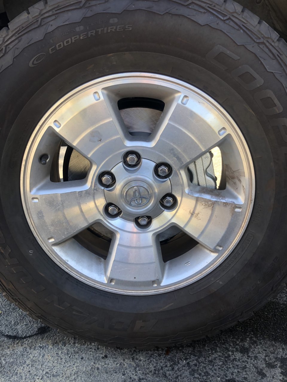

    I like the stock look but in the future maybe upgrade rims.

    Toyotapartsdeal.com

    Just waiting on my helper to get home so I can bleed them. It’s convenient that my fiancé drives a 5th gen 4Runner and happened to be needing brakes. So I stole her old rotors, had em turned and am out the door on this for less than $200. Also, if anyone has a good pair of tin snips and wants to save a couple bucks, you can trim the Tacoma dust shield and keep it 90% effective.
    Hopefully bedding in pads within the hour and can report back with results.

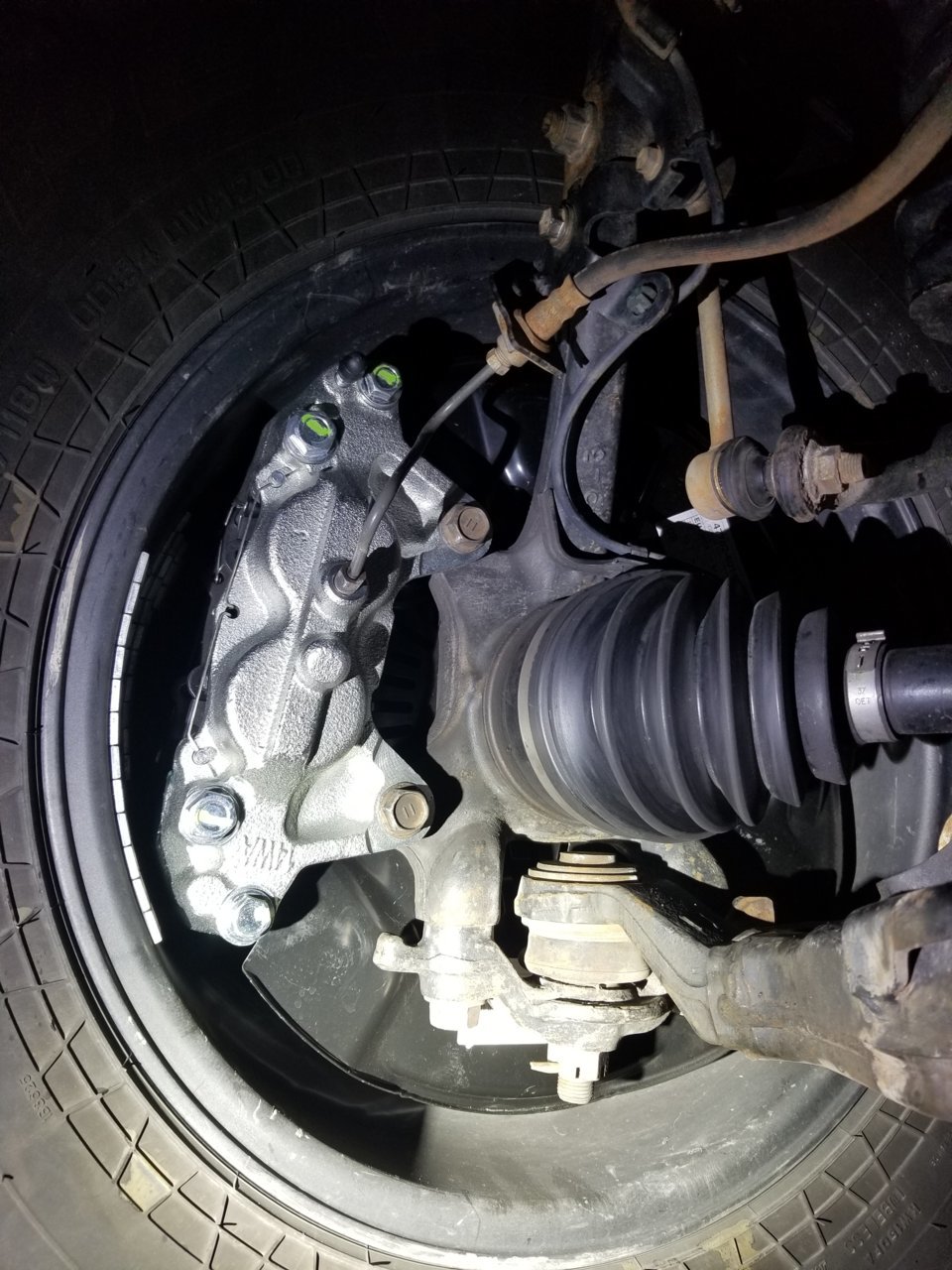

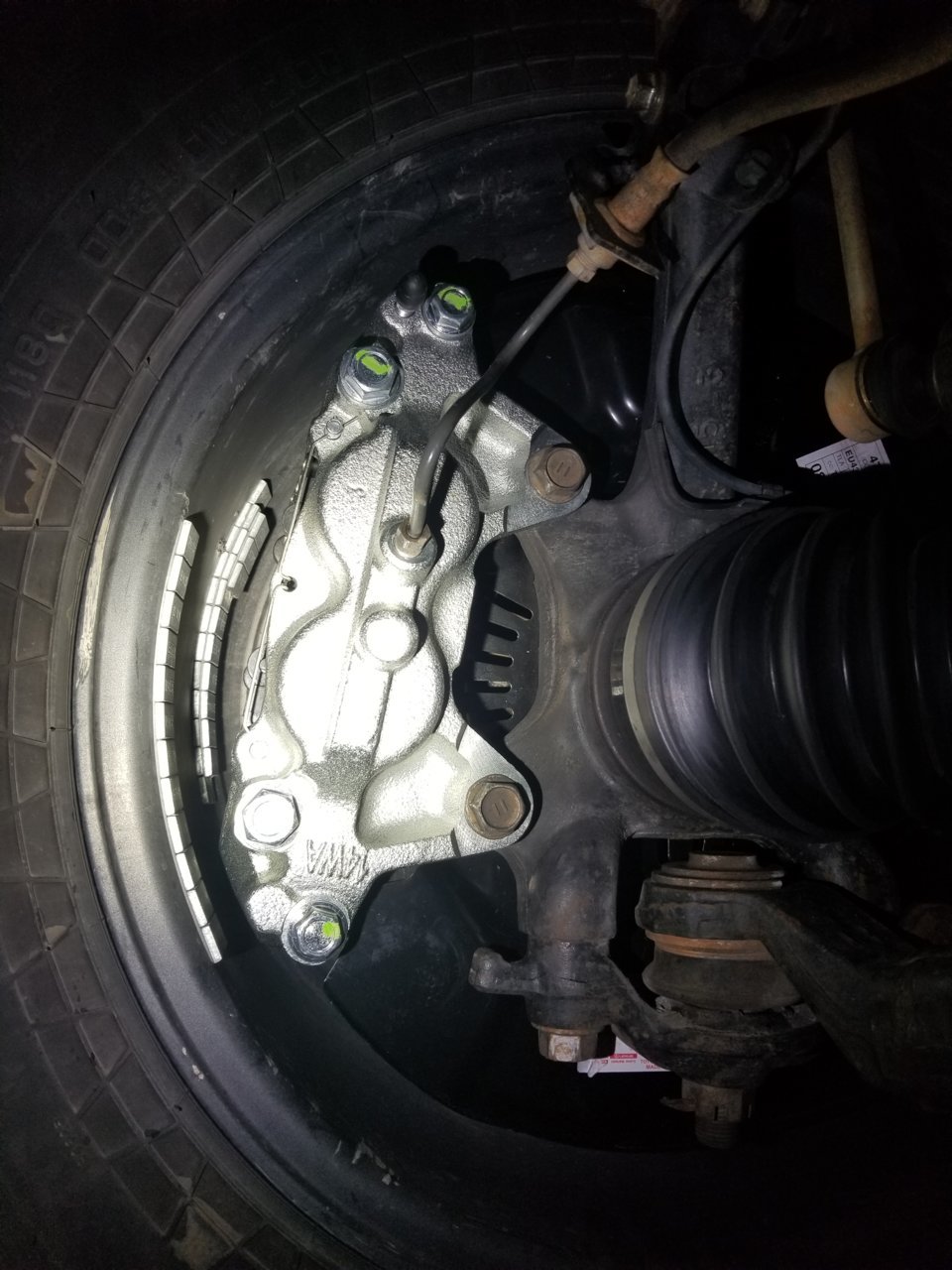

    What is the general consensus on doing a brake upgrade and leaving the dust shields off? I know they come that way OEM. I know there is some rotor protection that can come from a dust shield, specifically,,, dust. But it doesn't block any water, won't block any substantial mud, nor does it need to. Some claim cooling of rotor is improved with a dust shield but I cannot convince myself that airflow in the center of the rotor and out radially could be improved with a shield in place. inspection of both rotor surfaces, junk getting trapped, and an escape route for brake dust and better cooling due to more airflow are all potential benefits of leaving the shields off.

    Lots of people leave them off with no issues. My concern for someone that does some significant off roading is tearing the outer cv boot and getting grease on the pads. I’ve torn bolts several times and that’s the one reason why I have at least some or the dust shield still in tact.
