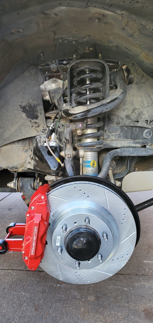

  5. Dec 7, 2019 at 1:06 PM
    #265
    Sch0227
    Sch0227 Well-Known Member
    Sep 6, 2017
    #229254
    446
    Steven
    Dallas, TX
    2017 TRD Parts bin
    Sharks with lasers
    Finally bolted these hotrods on my 2017 Offroad.. went Powerstop because ordering was easier. Look and stop reallll nice.

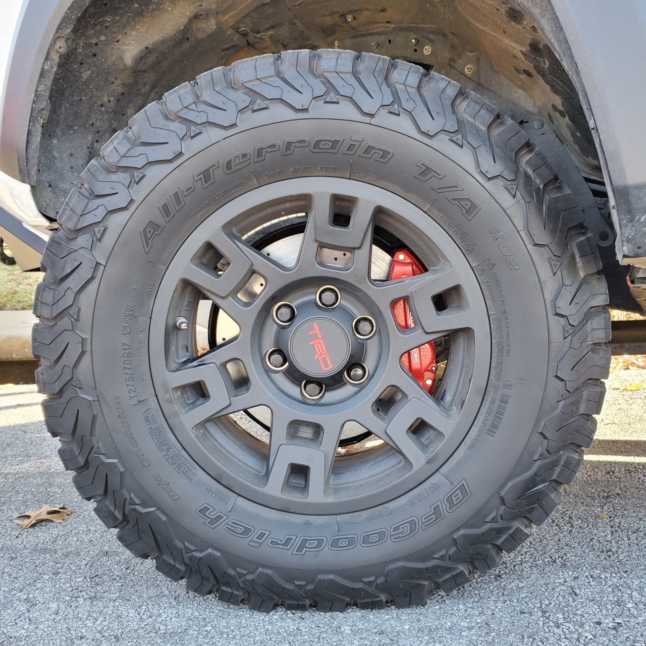

  15. Feb 8, 2020 at 6:54 AM
    #275
    Mach375
    Mach375 Habitual Violator of Wheeling Rule #2
    Sep 18, 2010
    #43428
    2,181
    Sathington "Alowicious Devadander Abercrombie" Willoughby (but you can call me Mud)
    Location: Satan's Stinky Butthole (SoCal)
    '11 DCLB 4x4 TRD Sport
    Too much to list, but enough to get me in trouble. Repeatedly.
    Stumbled on this thread while researching larger MC options. Saw a few comments asking about T4R parts and years and all.
    I have a 2011 DCLB Sport 4x4 with stock rear drums, spindle gussets.
    Front brakes are all 2016 T4R: calipers, pads, rotors, dust shields, wheels.
    100% bolt-up. Ever-so-slight bending of the dust shields to fit the spindles -- just some finger pressure after bolting them on, nothing more.
    If you're considering doing the T4R bbk upgrade, and want a solid and easy ordering experience, just spec a 2016 model year. Calipers, pads, rotors, dust shields are literally all you need (okay, fluid too), assuming you've already got 17" wheels (mine were 16").
    And if you want specifics on my brands: PowerStop calipers, Centric rotors, Porterfield pads, ATE Typ II fluid. Been running Porterfield R4S compound for years, and can't imagine anything on the market that's better.
