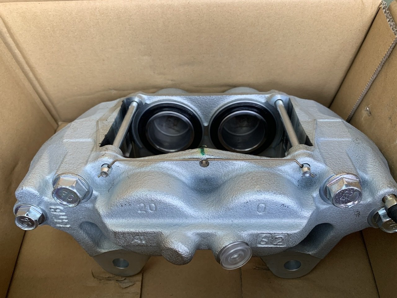

    Ok so this is what it looks like - if you buy a new OEM caliper for a vehicle that has 14WA it’ll be stamped a 14WB with a 12mm bolt hole.
    Toyota Part
    44730-60300
    44750-60300
    12mm hole 14WB casting
    Edit: My dumb ass bought the wrong rotors - I somehow put in the part number for GX460 rotors (2010+ good for 2nd gens) instead of GX470 rotors (2003-2009 good for first gens). Trip to the zone verified my mistake and they fit with the GX460 rotors. Note about quality and price. GX460 OEM rotors are $68 and Auto Zones are $72. Definitely going to order OEM rotors if I can wait to have them show up at my local dealership that also does online pricing and a $3 pickup fee.
    Here’s the Zone Rotor and OEM caliper. I ordered some shims as the caliper lies closer to the outboard edge of the rotor by 1/8 or so over the inboard edge.

    Also I’m waiting (said they’d be here yesterday but all the other stuff I ordered was here by Wednesday) for (my flipped due to rear steer) drivers side caliper - who knew they were so rare. :beavisd:

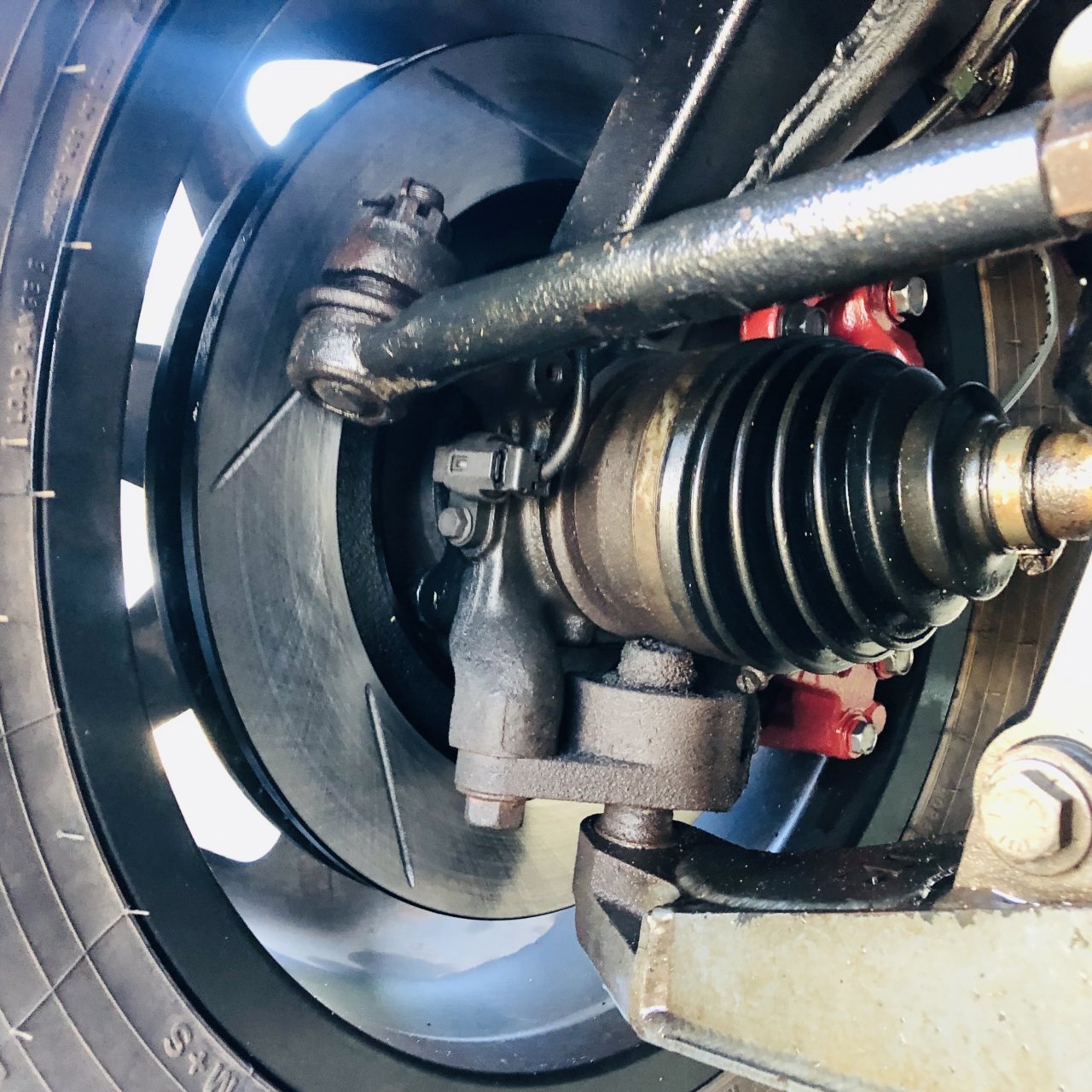

    my stock calipers were done (drivers side sticking),, was ready to replace, and my man Aaron shared your post and build...
    Twas like LEGO’s thanks to you, great write up, parts list and the pics, thank you.
    I’m now running your setup (340mm Stop Techs slotted rotors & 4Runner calipers).
    thanks to you the prep and what to get was so easy... and ya nailed it: for a few hundred bucks more (than stock) you can have a BBK
    and besides looking amazing:
    They stop amazing! Best part:
    No more Pulsing nor Fade with my 35’s
    again,, big time Mahalo’s from the rock
    shoots

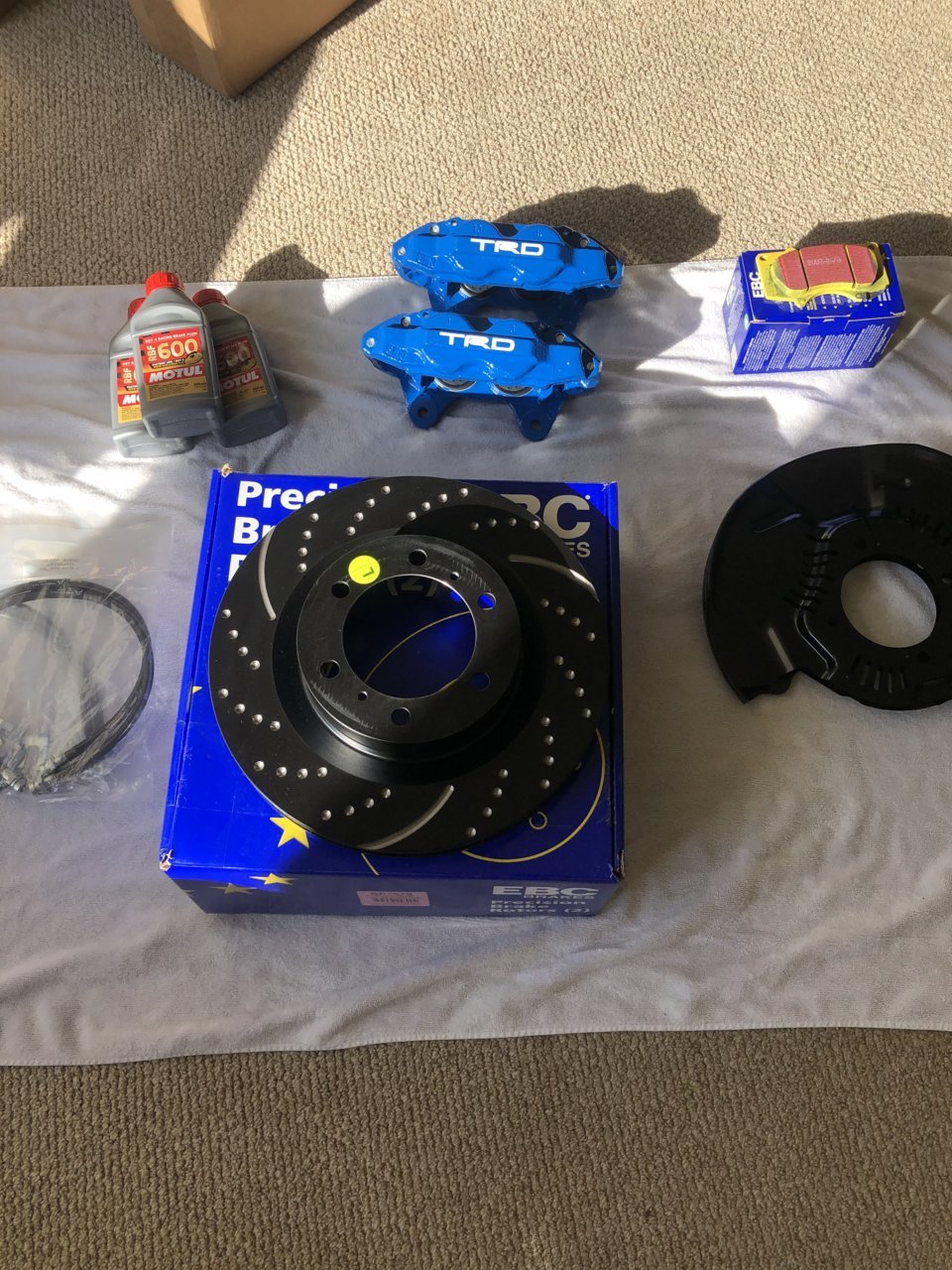

    I have everything at my house except for the caliper paint, I spent more than I probably should have for everything but wanted to do it exactly how I wanted to the first time around. Went with EBC slotted and dimpled rotors with yellow stuff pads, t4r reman calipers by raybestos through rock auto, ss lines through @HeadStrong Off-Road, t4r dust shields, motul rbf600 fluid, and g2 mustang grabber blue caliper paint.

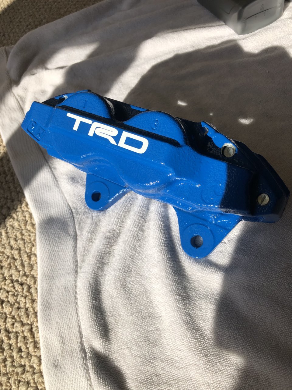

    4EA8DCE9-79D9-44F5-8617-DF906F819329.jpg Calipers painted and everything seems good to go in tomorrow 212F54F2-0F59-4F2D-8457-8817C7BBB000.jpg Went with Mustang Grabber Blue and they turned out wayyyy better than I expected.2E291580-D926-40FE-8FB6-DCBC50CB37A5.jpgI just now realized that only 1 of the calipers came with this pin that’s circled in the pic. Is that correct?
