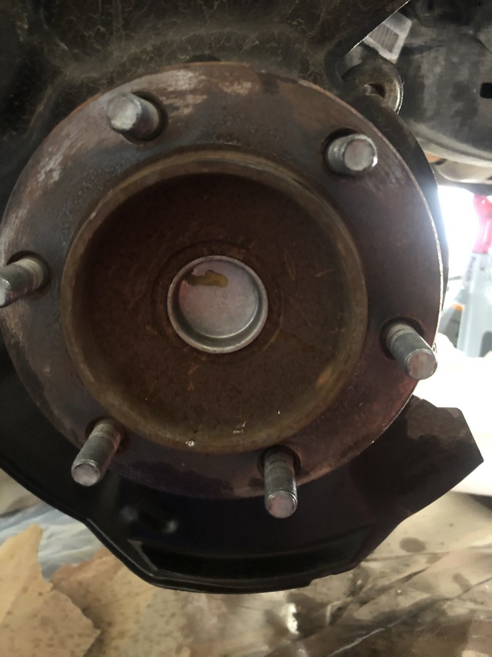

    96800483-FAB6-44A4-9B6A-AFF29180EDC1.jpgMy (Hub assembly, bearing dust cover?) whatever it’s called looks different than all the others ive seen and can’t figure out how to access the wheel bearing

    I think you just pry that cap off with a flathead screwdriver.

    That silver bit in the center?

    That’s wild ,, I haven’t seen one like that before either: that’s where the Nut and Cotter-pin should be. Maybe some had to put in a make shift dust cover ?

    Its because yours is a 2wd its all accessed from the back. No need to pry the silver cap off just loosen the 4 17mm bolts that attach it to the spindle.

    THANK YOU! Just spent 20 mins hammering for nothing lol

    and sorry I didn’t catch that for ya, I’ve had 3 Toyota’s, but all were 4x4’s lol.
