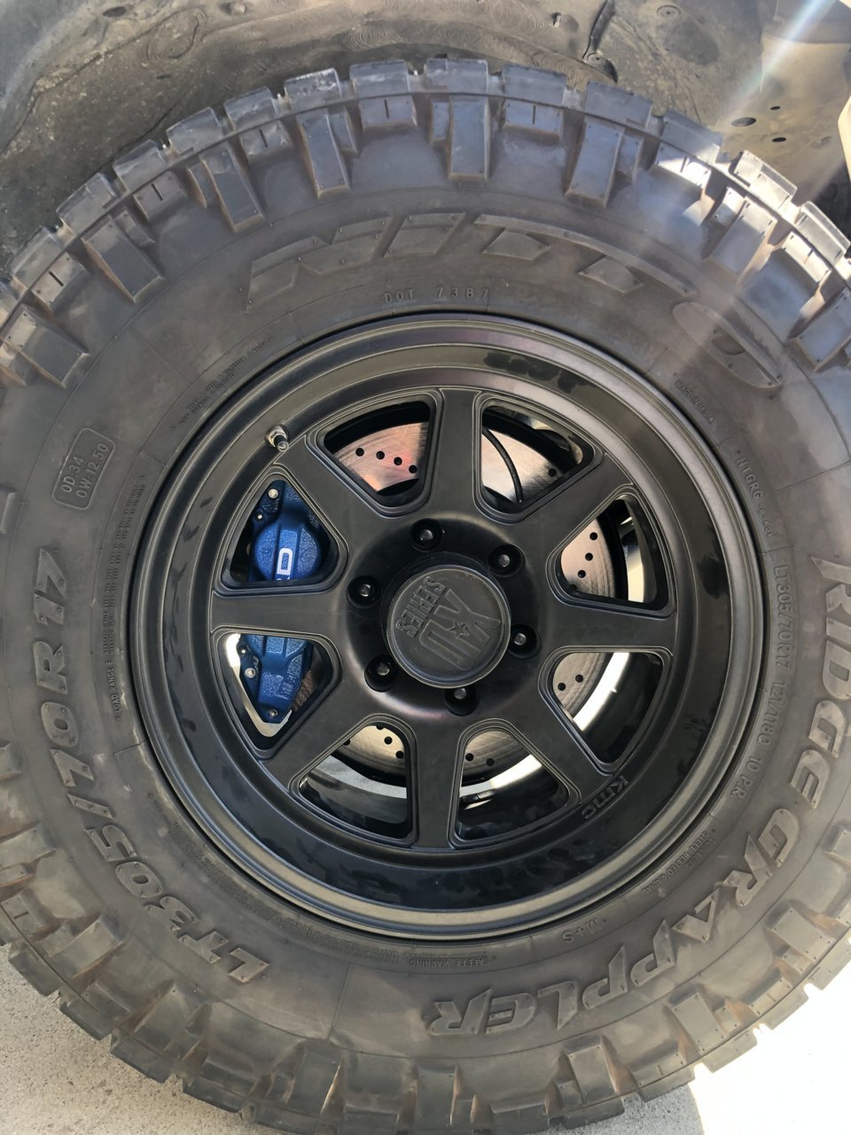

  20. Oct 14, 2020 at 1:23 PM
    #360
    DanaPtTaco
    DanaPtTaco Never-ending problems
    Mar 22, 2019
    #287601
    446
    Thomas
    Orange County, CA
    07 ACLB Prerunner 4.0 AT
    Finished!
    eljedi68 and VE7OSR like this.
