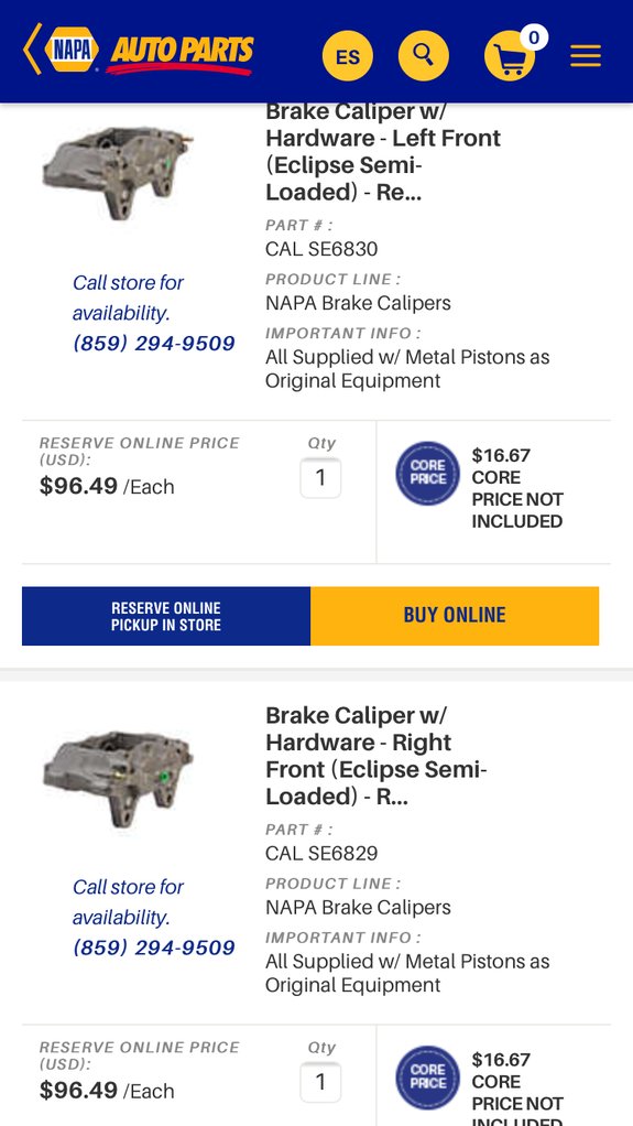

    @nudavinci64, this is a great thread, so thanks for all the research! I'm gearing up for this on my truck now, but am having a hard time finding any calipers. Is there a particular vendor/store that y'all went to? All I've been able to find online are rear calipers and none of the specification information indicates 14WA. I've been to all my local auto part stores too and they don't stock these...sorry, I'm sure this is something easy, but any help is appreciated.

    https://www.napaonline.com/en/p/SEBSE6829
    https://www.napaonline.com/en/p/SEBSE6830

  11. Oct 27, 2017 at 3:54 PM
