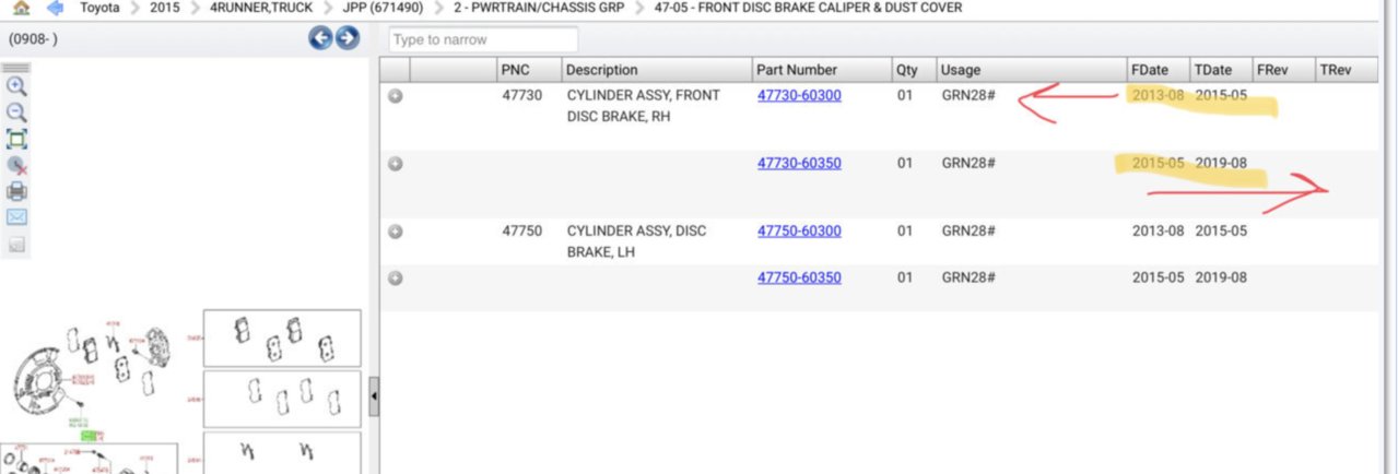

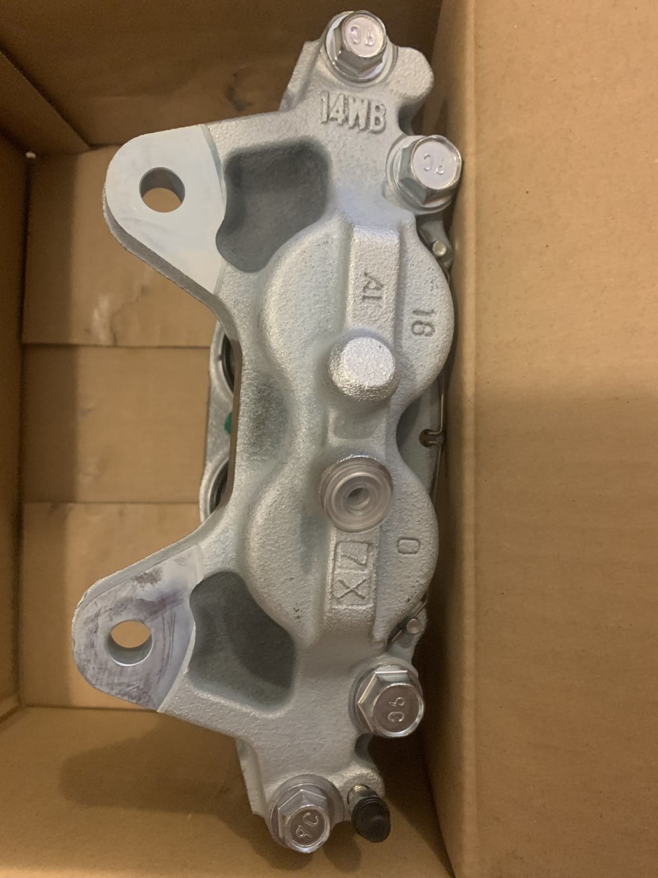

    The older ones are 14WA, the newer ones are 14WB. However, if you order new calipers from Toyota, they will say 14WB whether the have the 12mm or 14mm holes. They come out of the same mold and the holes are drilled afterwards. Look at the part number on the box to know if it's correct, not the casting number.
    Just to make it crystal clear:
    14WA: 12mm Holes
    14WB: 12mm or 14mm Holes
    Jeff

    I checked with a guy I know that works in the parts dept for Toyota and at least based on this it seems like either the parts guys do not know whats up. they use the same but in the system the part number are pretty clear and x300 (should have been only 13WA) is the pre 16 and xxx350 is the 16+ (was 13WB). If they are now 13WB thats a first i have seen 2 part numbers use the same.

    I just tested. PN 47730-60300 and 47750-60300-both14WB on them. I have a broken lug bolt form my brother-in-law's mini which is 14mm in diameter. It did not fit in the caliper holes. Can provide pix if needed.

    yah I believe it but def is confusing for those trying to pick up calipers. Even the part numbers in the toyota part DB show different and my understanding was that was the big difference 12 vs 14.
    So might be a bit trickier to identify it if someone has a set.

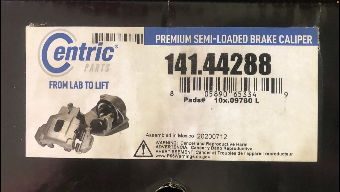

    Aloha, not sure if this helps.
    But these are the Calipers that I went with for my BBK conversion... direct fit, no machining required 5CB56B8A-917B-48BA-95C4-EA7F9D87908D.jpg

    I should go look at the boxes. I had Centric's on mine too (FYI for anyone Centric owns Stoptech)

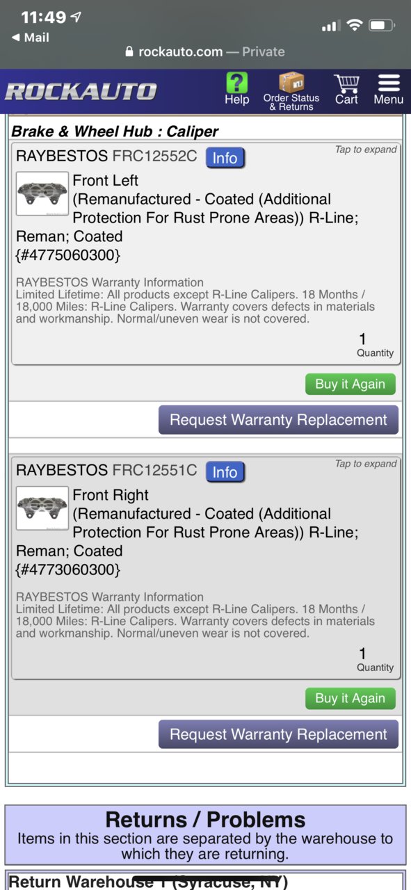

    Is it better to source used or reman?
    Having trouble finding a decent price on used
    is there a VIN split?
    When searching on carpart, it acts like there's a different version starting 2015
    but to my knowledge all 5th gen 4runners are supposed to use the same brake...

    Changed calipers but pads stayed the same I believe.
