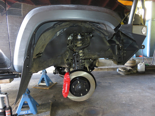

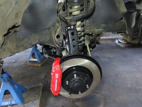

    Thank you to everyone who provided information in this thread. Got mine done.
    • StopTech 4Runner slotted rotors P/Ns 126.44174SL, 126.44174SR
    • Advics P/N AD0976 OEM-equivalent pads with shims
    • PowerStop P/N S6278 4Runner calipers including all the hardware
    • OEM 4Runner brake dust shields 4778160140, 4778260140 - they clear the All-Pro spindle gussets
    PWDgaquXzr0lyCoe0oe_DfRlEe7ffVgM67b-LaNU_1e34e024e9bc0bdf2592734dee348a8dbd4a90a2.jpg 20ued7OSyIpZMCB2mkRBc8CkT3hCcE9HSPFWhPQQ_9ae3d671df62bb350fe5262a65f603a7439ad403.jpg
    StopTech quality is slipping! The rotors wouldn't seat properly on the hub register. Once I sanded away the E-coat on the center bore with a Dremel, they fit correctly.

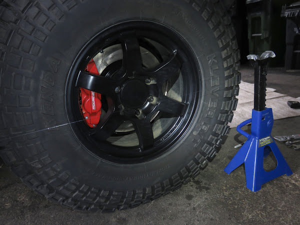

    The calipers clear the FN Konig Six Shooter 17x8" wheels with room to spare:
