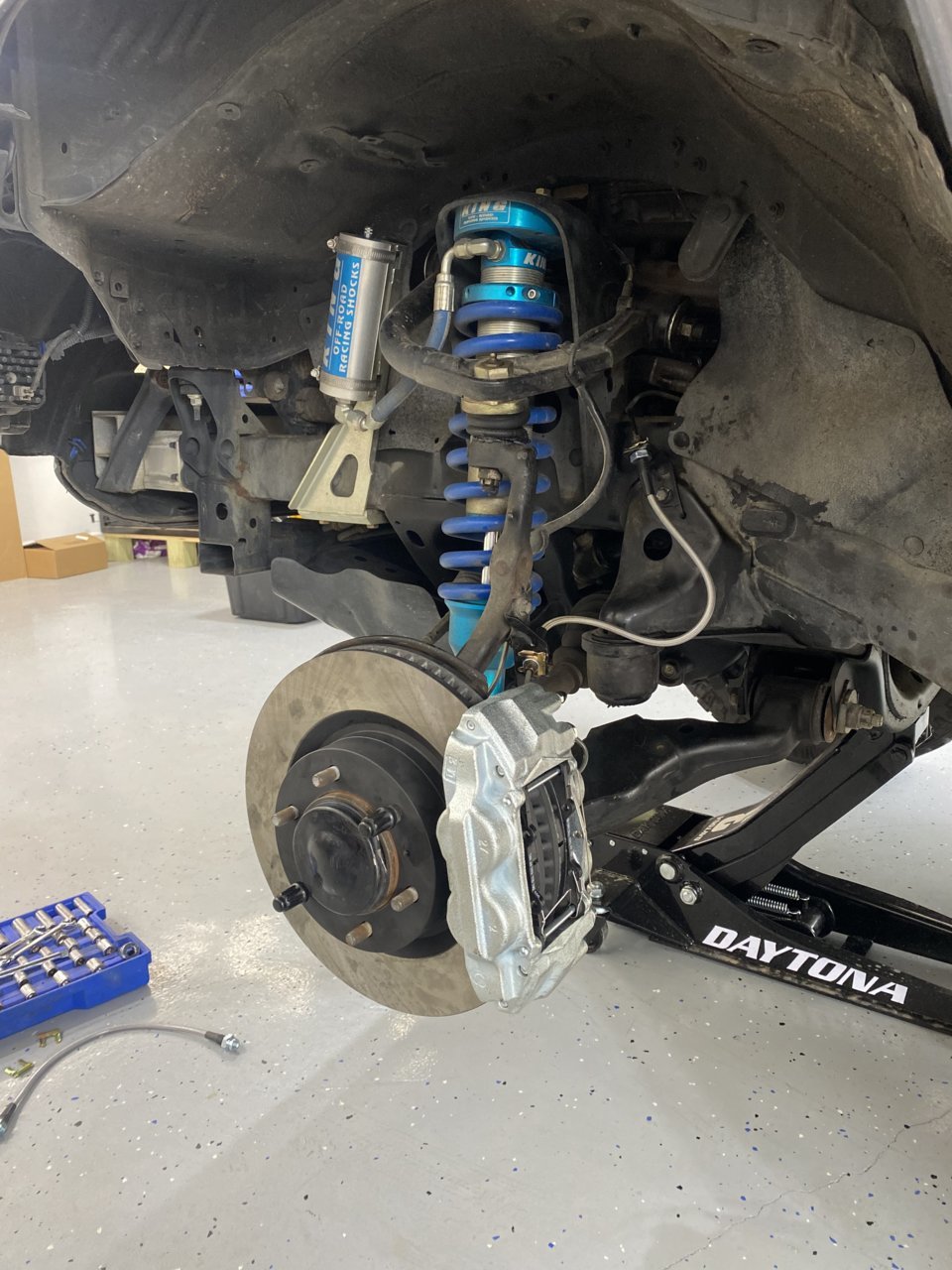

    Just got my 5th gen 4runner BBK done, thanks for all the help!
    I used all pro stainless steel extended length brake lines
    2014 4runner OEM brake calipers
    OEM rotors
    Duralast elite ceramic brake pads

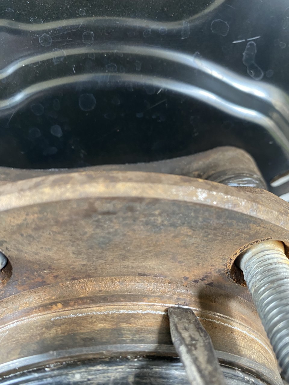

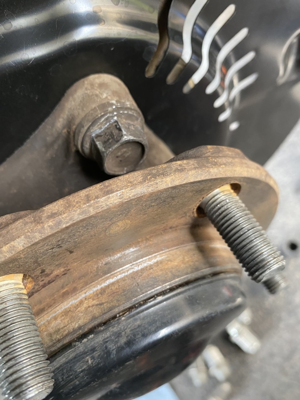

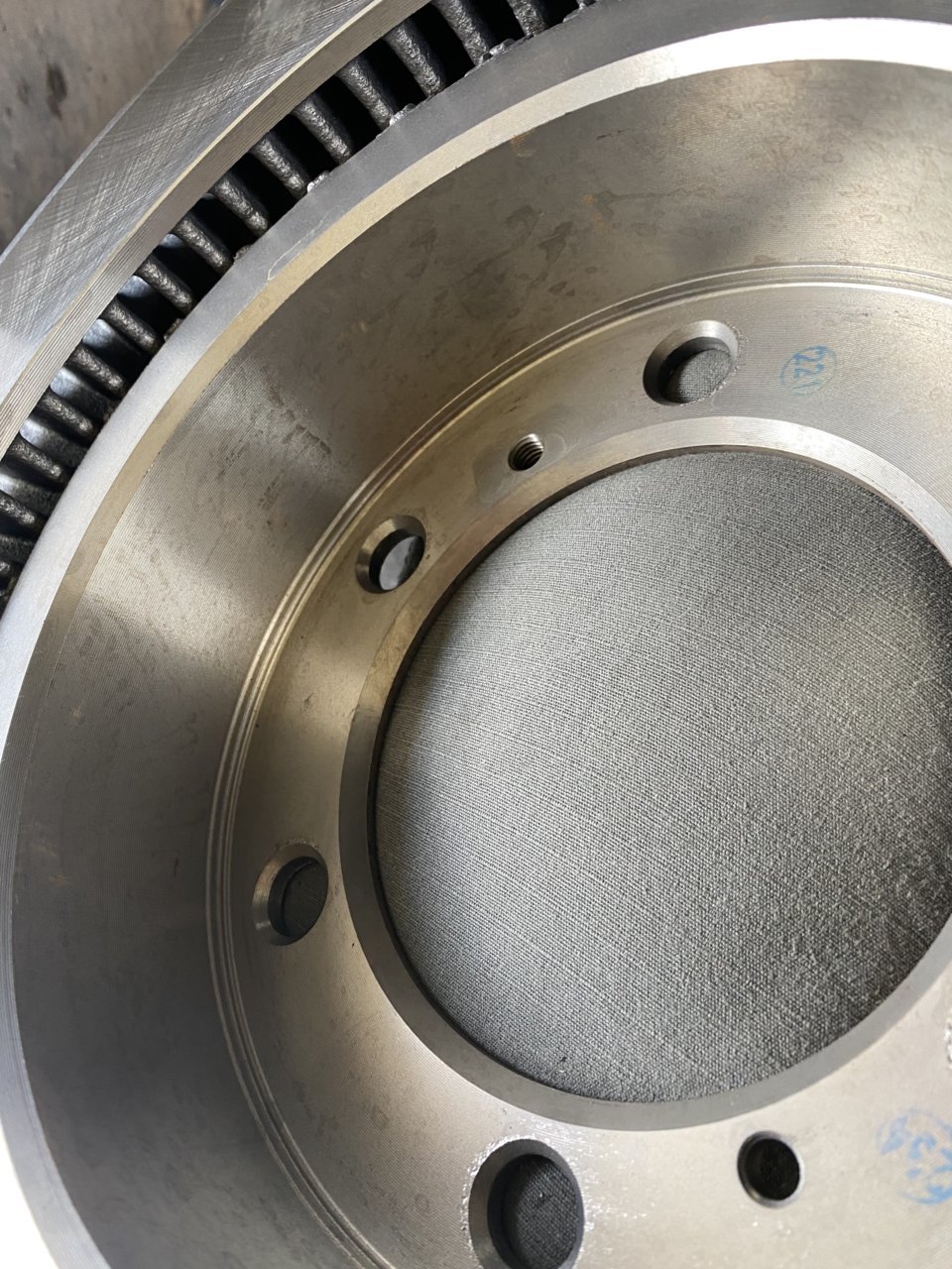

    Ok guys I just completed my BBK upgrade. I went with oem 2014 T4R rotors and I noticed it wasn't hub centric exact fit maybe about 1/16 of a inch +/-. So when the wheels are off and bolts also I can wiggle it a bit. Looking into the rotor removal screw hole I see that my rotor and hub are meeting/seated together when I put on the bolts snugged. When wheels and bolts are back on it feels firm and no play when trying to wiggle jiggle wheel. Test drove it after job was done and no noticing if anything was wrong with it. So my ? is, Should I even be worried about this or is it fine ? And what would be a fix for this or it'll just fine. Any help would be appreciated.
  17. Aug 15, 2022 at 8:14 AM
    #437
    Midship909
    Midship909 Well-Known Member

  18. Aug 15, 2022 at 11:20 PM
    #438
    8TaCo8
    8TaCo8 Member
    Apr 9, 2017
    #215775
    22
    HI
    '13 4x4 Tacoma DcLb
    brake cleaned it and wire brushed it. Here's the problem I found. So on the bearing hub faceplate there's a lip that sticks out about 3/16" and 1/16" thick in height all the way around then it drops off or steps off the rest of the hub. When I test fit rotor on backwards it sits perfect on that lip, when put on the right way because the rotor face is 1/4" thick and beveled/chamfered in the inside of it, it catches by a hair or two which doesn't help at all so I guess I'm screwed lol being that I bought the rotors like 3 months ago and only did the job yesterday thinking everything going to work and now dealer wont take back or replace cause of time held onto it and its been used already.
    Now is there anyway I could fix the problem beside looking for another set of rotors ? As of now I just centered rotor with shims and pulled them off when I mounted and torqued the wheels.
    sorry dont know how to set pics lol
  19. Aug 17, 2022 at 6:11 AM
    #439
    dually
    dually Low and slow
    Jul 29, 2008
    #8205
    3,299
    Interstate underpass
    '16 Inferno SR5 DCLB
    Any competent machine shop with a lathe could turn down that inside for you. That would be the best method.... I wont share the second method I have in mind...:spy:

  20. Aug 17, 2022 at 10:45 AM
    #440
    ACEkraut
    ACEkraut Well-Known Member
    May 11, 2014
    #129627
    4,581
    Aaron
    Durham, Maine
    2014 DCSB TRD Off Road
    Your close up pics show some rust build up. The wire brush may not be aggressive enough to take the extra rust off and clean up the surface enough. I would have another go at cleaning it up a bit with something more aggressive. Really you have nothing but time to lose by trying it.
