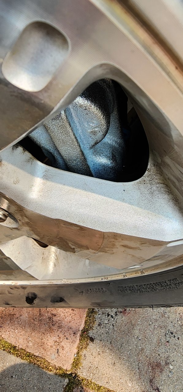

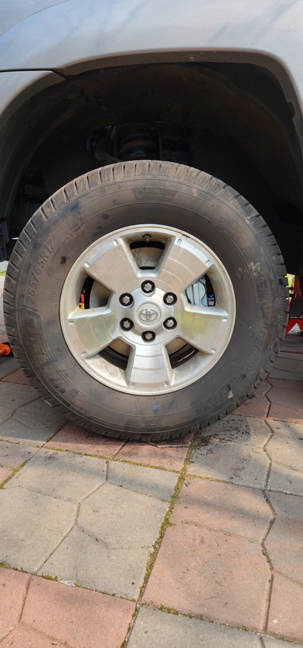

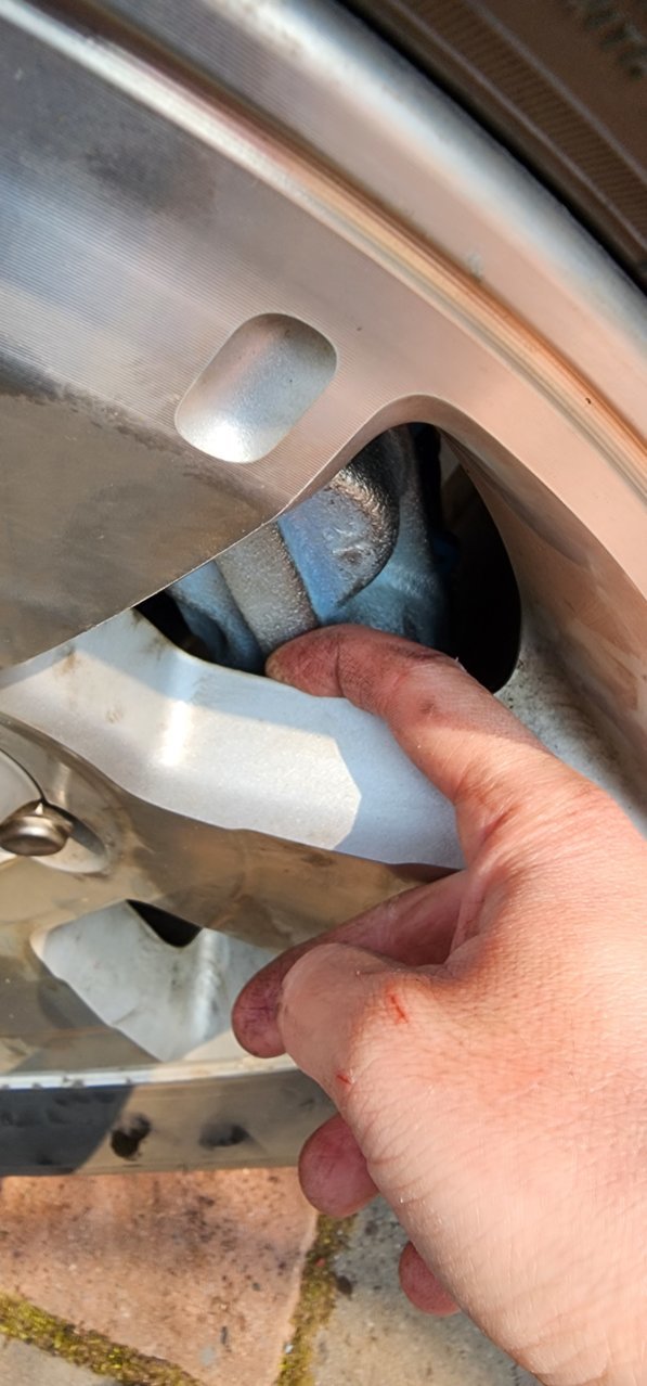

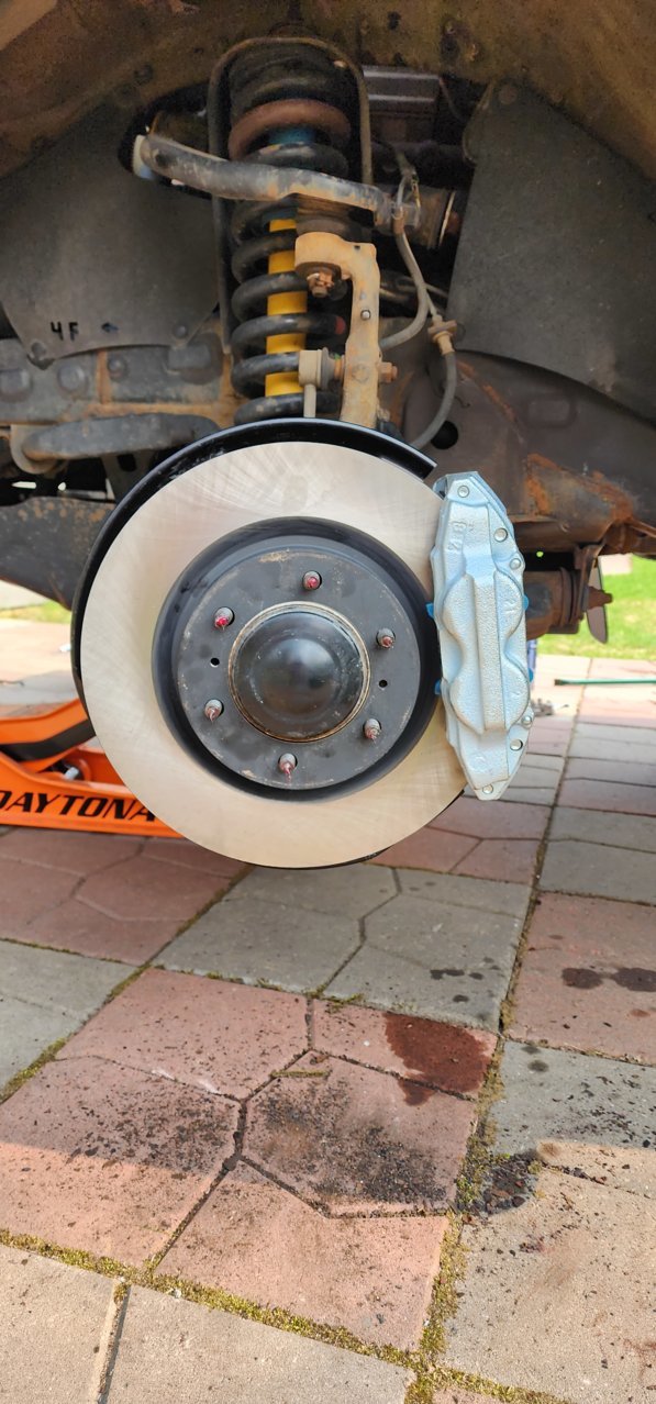

    I want to give a shout out to everyone in this thread for all the information. Absolute THANK YOU! I've read the entirety of this thread through and through twice, and skimmed it more than that. I've been a lurker for years, and finally decided to join, possibly to help others along the way.
    I've purchased all parts beforehand, and finally tackled the job couple days ago. All parts were OEM from either McGeorge or another Toyota dealer that shipped parts. Parts I ordered were the splash shields, rotors, calipers for both sides.
    I also did the tundra master cylinder + brake booster as well, so quite a bit in one go.
    I will echo what user @truckinducks posted, I have factory 17" rims and they fit without any scraping. My 17" rims are original to my 2015 TRD sport DCSB when I first bought the truck from the dealership. That was my biggest concern, not knowing if it'll work with factory rims and needing spacers. Photos below.
    Photos of the calipers against the rim. There's about 1/2 - 3/4 inch of space.
    Great upgrade and I'm loving the break pedal feel. Just need to break them in more to see how overall performance will look like in the long run.
