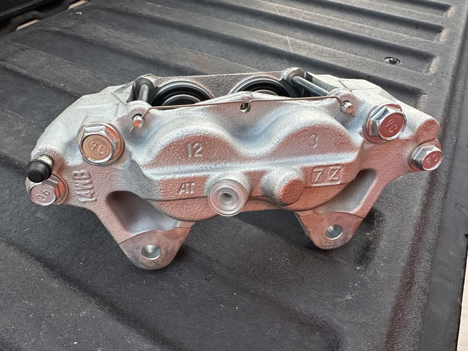

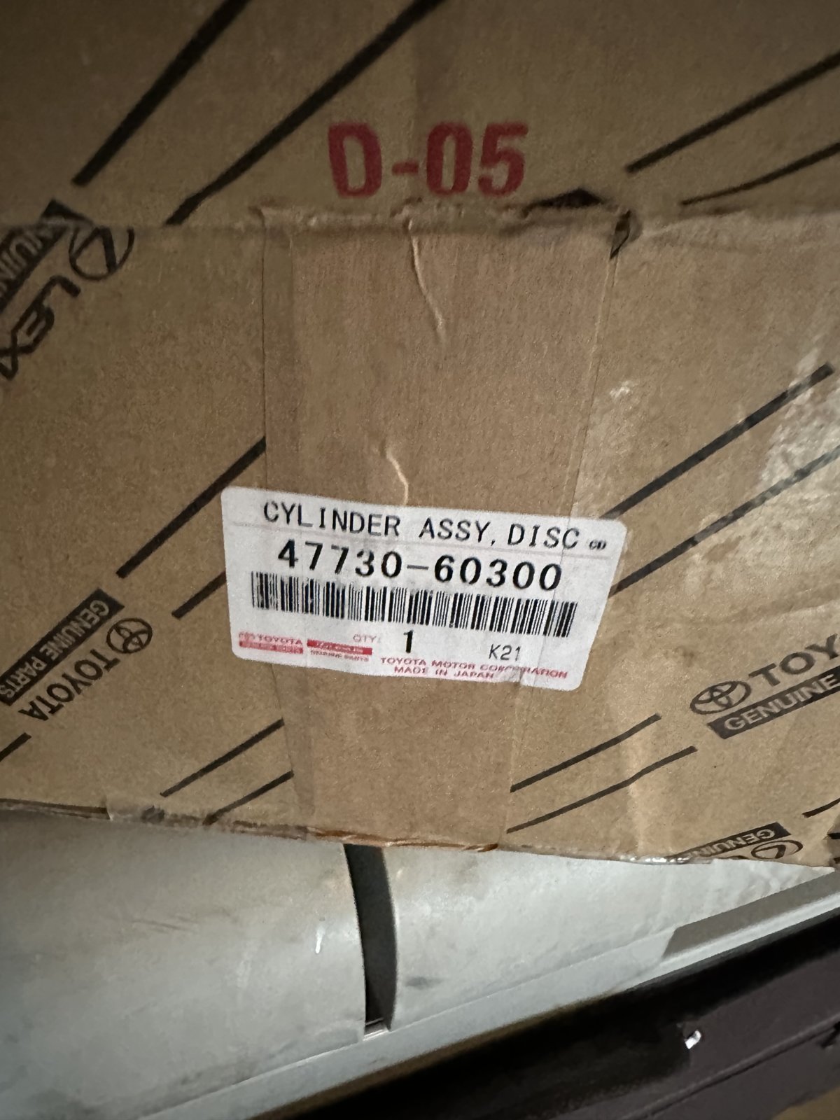

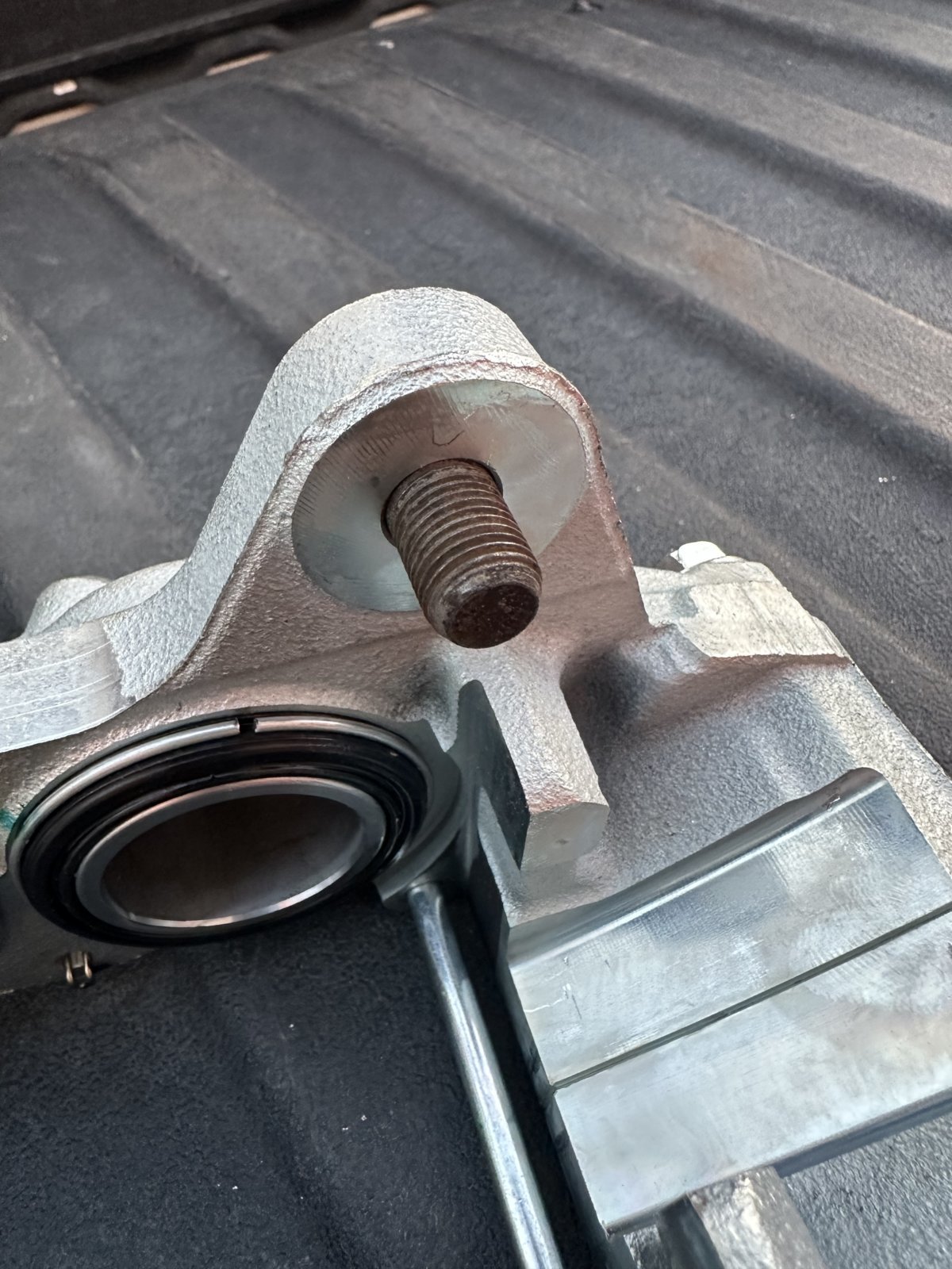

    Received brake calipers. Stamped 14WB but correct part number and bolt size
