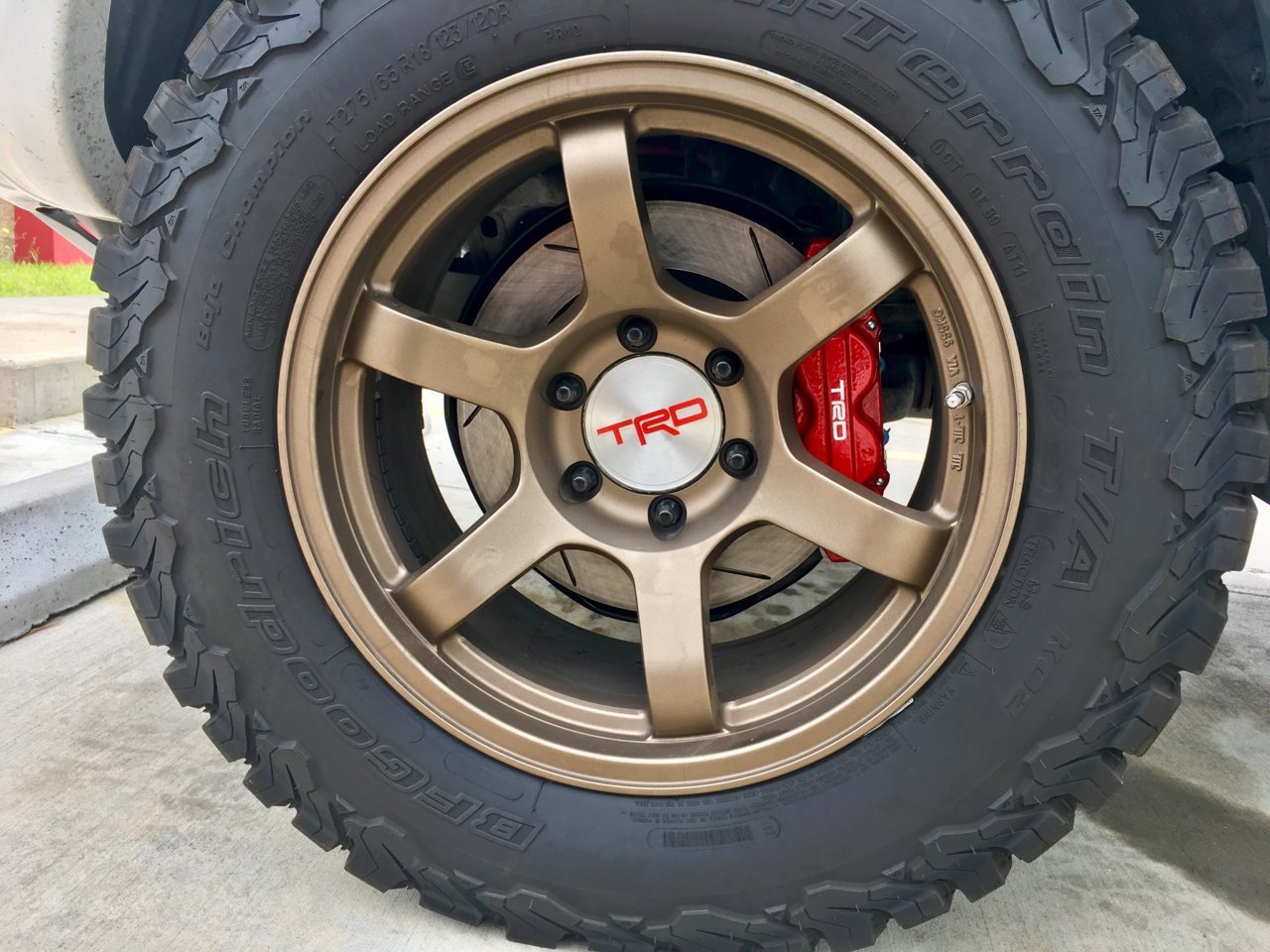

    Thank you for your write up! Another upgrade completed:

    Sick! Looks good. What pads did you go with?

    OEM pads for the time being... I may upgrade to something else when these need to be replaced.

    Gotcha did the same thing. Nice to see how the difference is. Did you update to stainless likes?

    Yessir I did. Purchased front and rear SS lines from LRO
