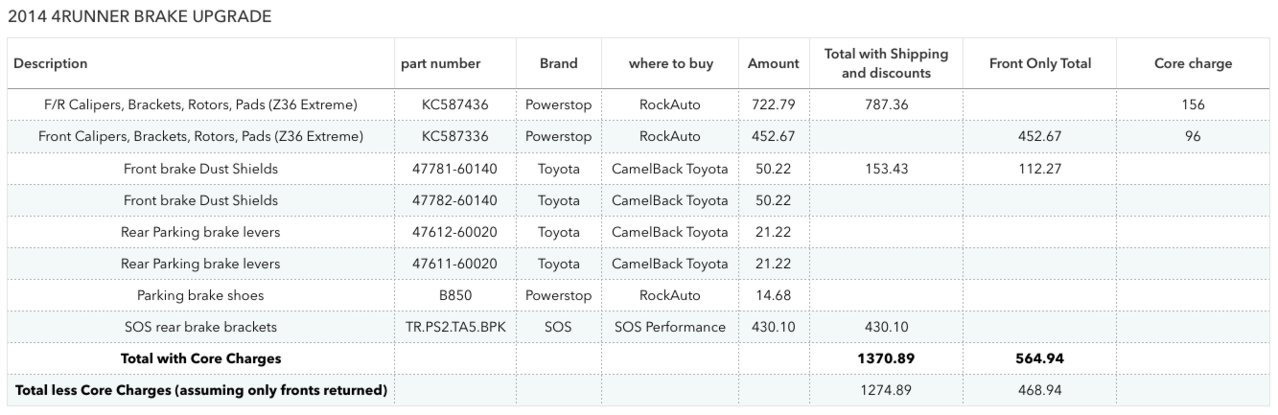

    Along with lots of elbow grease, brake cleaner, dremel sanding discs, sand paper, primer, color paint, clear coat and some small decals I cut out at work
    -Stop Tech Slotted rotors
    #126.44174SR
    #126.44174SL
    eBay for $98 each shipped
    RockAuto has these for a little cheaper shipped (I found out after the fact)
    -EBC Green stuff pads
    #DP61657
    eBay for $68.56 (AnythingAuto)
    -2014 4Runner Calipers
    #14WA
    eBay used for $100 (pretty lucky)
    -2014 4Runner Dust Shields
    #47781-60140
    #47782-60140
    @gunny1005 (Camelback Toyota) $89.93 shipped
    -Carlson Caliper Rebuild kit (2x)
    #15392
    eBay $19.92
    -Carlson Disc Brake Hardware kit
    #13600
    RockAuto $4.15
    -Carlson Bleeder (they were bent when I got them from eBay)
    #H9411
    RockAuto $0.59 (they only sell 5 at a time, so about $2.95)
    @5678ta for this picture as well

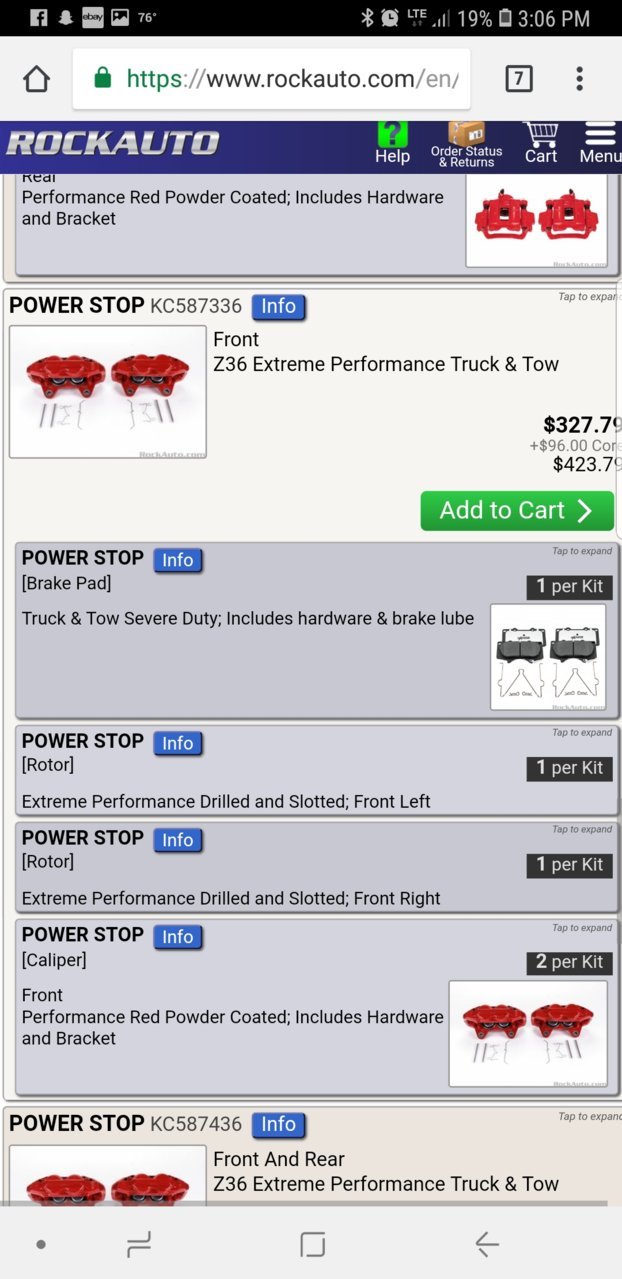

    Rock auto has a full replacement kit. Calipers. Rotors and pads for the 4runner. Do these look at all decent

    Checked there for my rotors. was cheaper for calipers and pads on toyota parts direct. Still free shipping all around.
