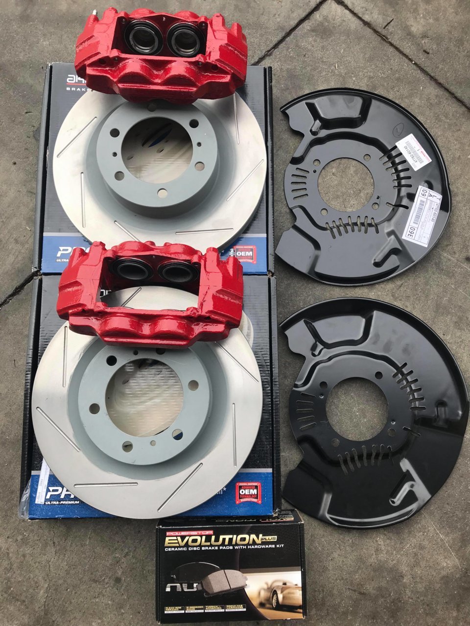

    I just finished by 4runner BBK.
    Cost on Parts
    CALIPERS - Remanufactured 5th Gen 4RUNNER (w/ core exchange) $134.00 FOR BOTH
    CALIPER PAINT - DUPICOLOR Caliper Paint - High Gloss $20.00
    ROTORS - AKebono Premium Rotors (custom slotted by a friend who does C&C) $96.00 for both.
    BRAKE PAD - PowerStop Evolution Ceramic Z17 Brake Pads(Has more bite then the factory Toyota Brake Pads) $30 (I have a wholesale acct)
    DUST PLATE - OEM TOYOTA $0.00 (DID NOT USE)

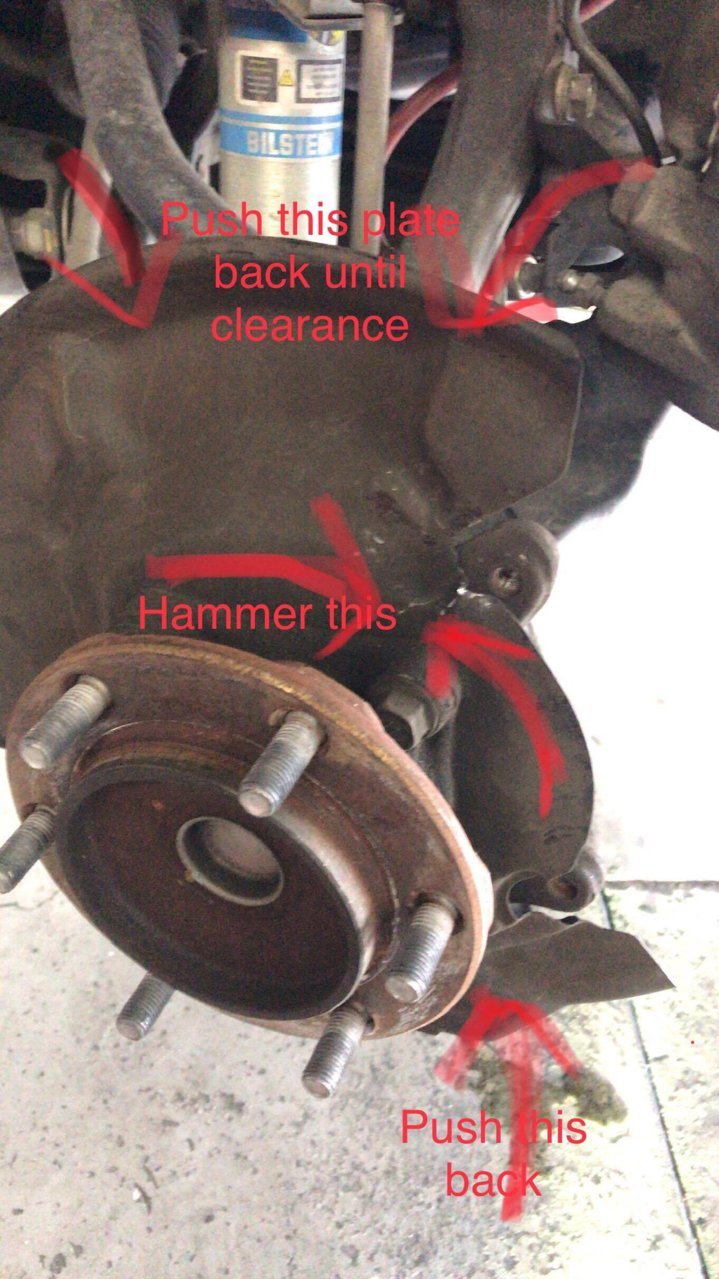

    It is not worth the extra $115 and extra 30 mins to replace the plate. The original can be modified in less then 5 mins for both sides. The outer edges can just be pushed back to allow clearance and the portion of the plate that blocks the upper caliper mounting hole can be cleared by whacking it 3-5 times when a rubber mallet.
    Stainless steel brake lines and hardlines - I already had the stainless brake lines and the hardlines can be reused with no problem at all. $0.00
    BRAKE FLUID - Brembo Dot 4 1 Liter $10.00
    Total for this BBK = $290

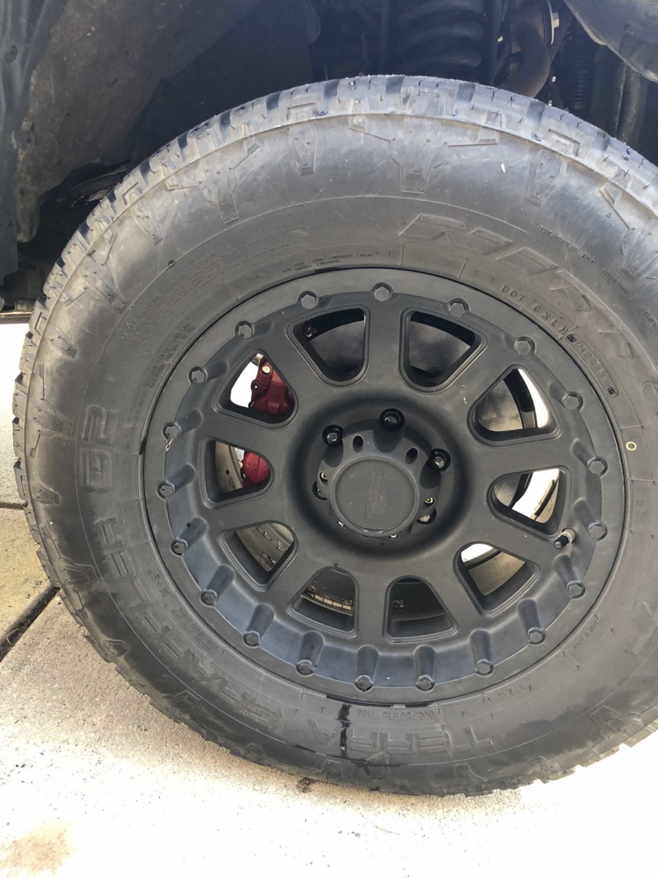

    Didn't take us long, my 19yo did most of the work. Brake upgrade and snorkel install in about 5 hours.

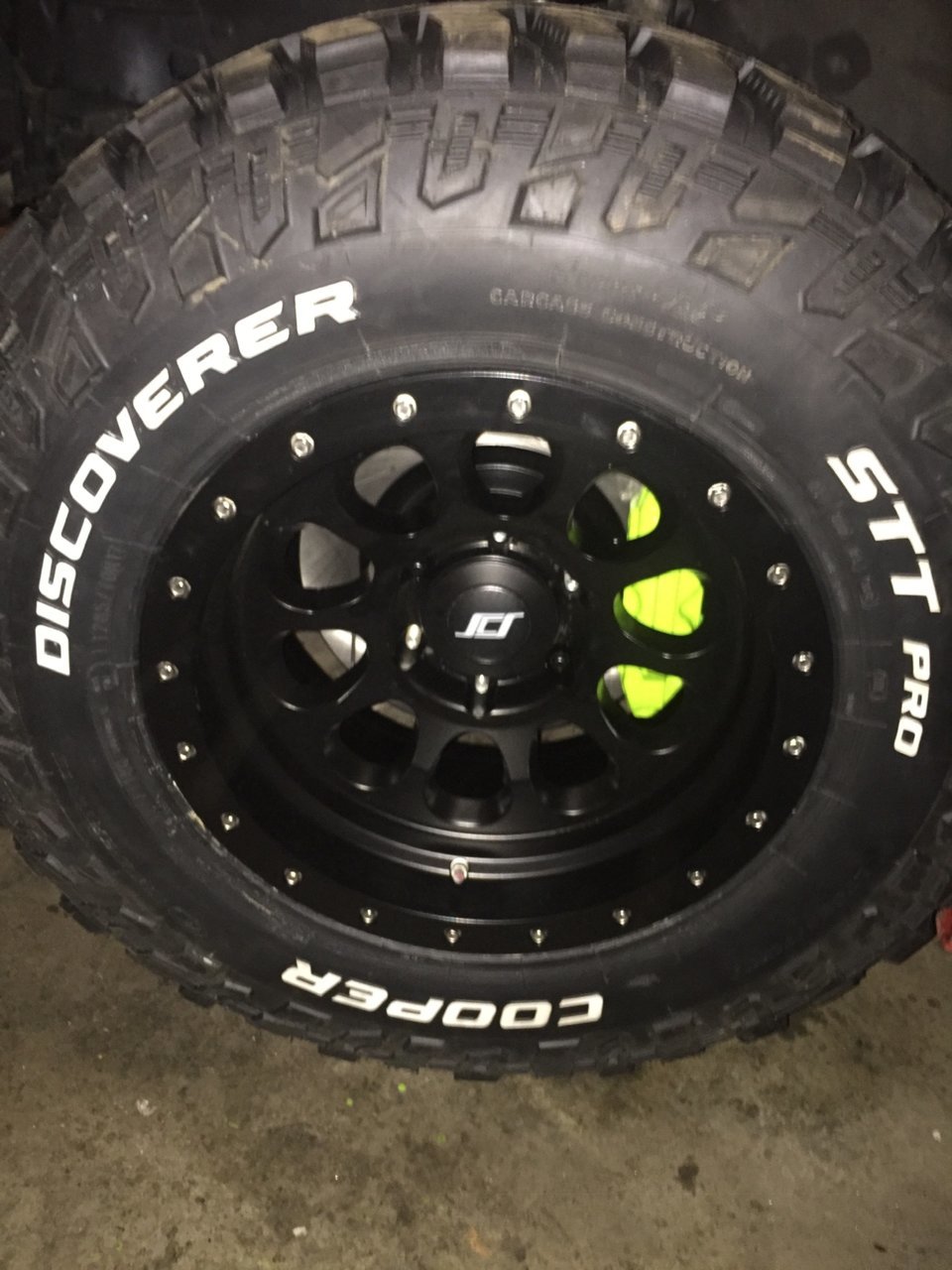

    Just got this upgrade completed this past weekend. No real issues with install and so far brakes feel firmer but really need to bed them in yet, but happy with the way it turned out.

    I like your caliper color choice. What did you use? It looks similar to the current color on the WRX STI Brembos.
    KCTaco77[QUOTED] likes this.
  13. Mar 25, 2019 at 12:51 PM
    #173
    KCTaco77
    KCTaco77 Well-Known Member
    Aug 11, 2014
    #135883
    232
    Kansas City
    2011 Tacoma 4X4
    3" Lift, AMP Running Boards and tailgate step, ANZO head and tail lights.
    I used the Lime Green G2 Brake Caliper paint that I got off of Amazon. Seemed to have good reviews so will see how it holds up, and they had multiple color choices. The paint is brushed on and kind of a pain to make sure you don't get any runs, but it is self leveling. After it cured overnight it looked a lot better than when I was initially brushing it on, put about a total of 4 coats on the calipers. However I would recommend getting a good set of small craft brushes since the brush provided in the kit isn't the greatest and looses bristles.

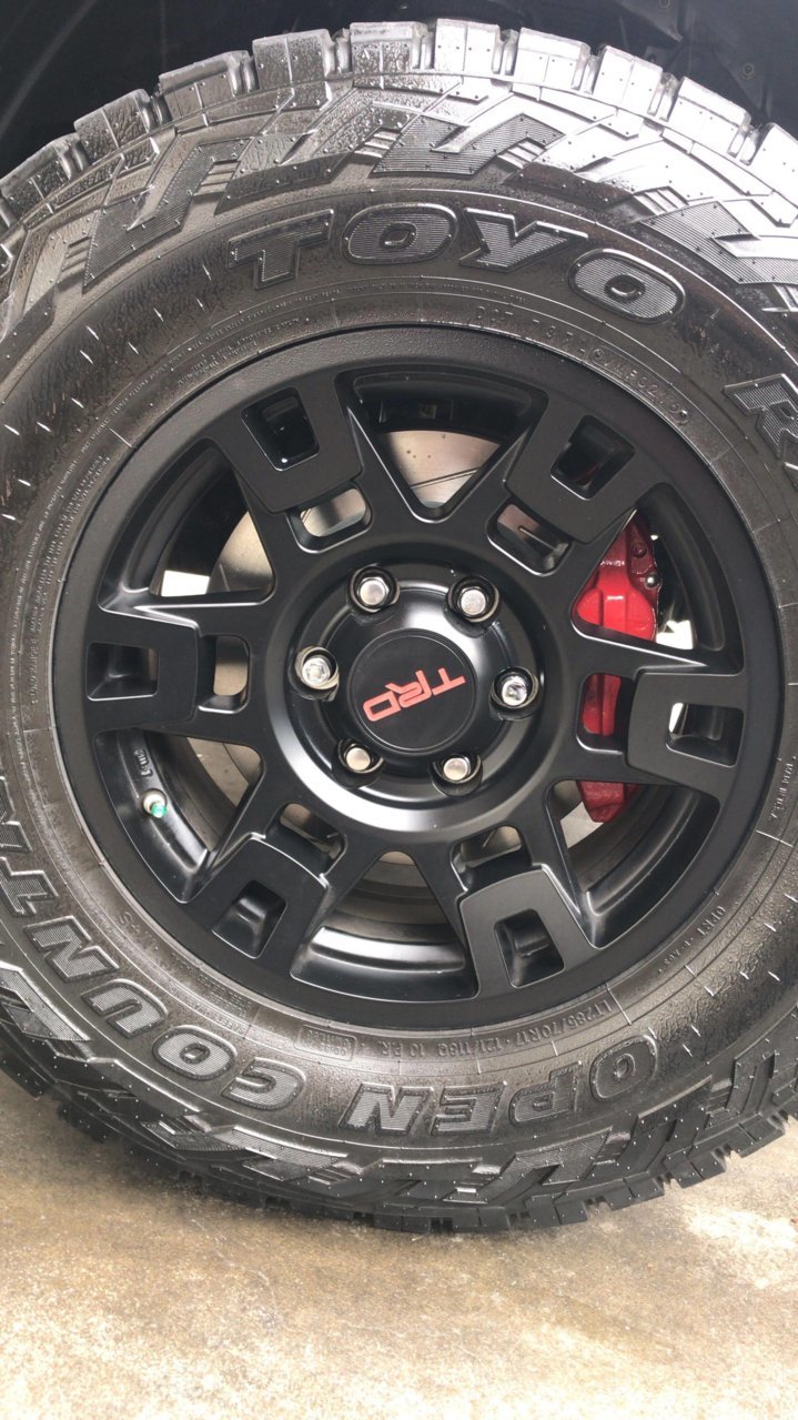

    KCTaco and 4x4Taco09, Thanks for the great thread. I installed my brakes on the truck this weekend. So far so good. I think this will be a good longterm upgrade. I like how I can still buy parts from the local parts store or Toyota instead of special order aftermarket parts that I feel I must stock spares. Attached is what it looks like with 18" wheels. I am now longing for 4x4Taco09's suspension set up. IMG_2175.jpg
