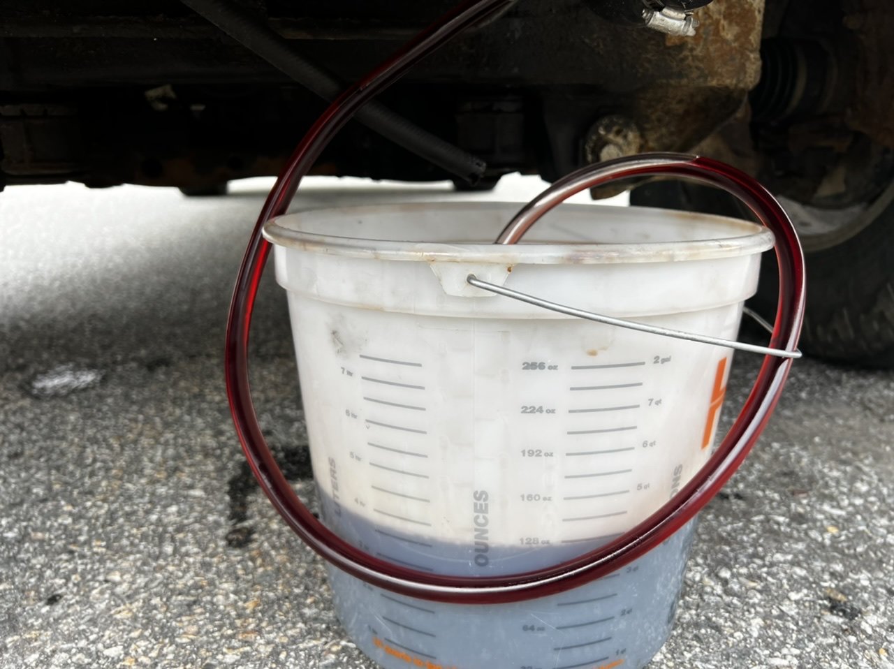

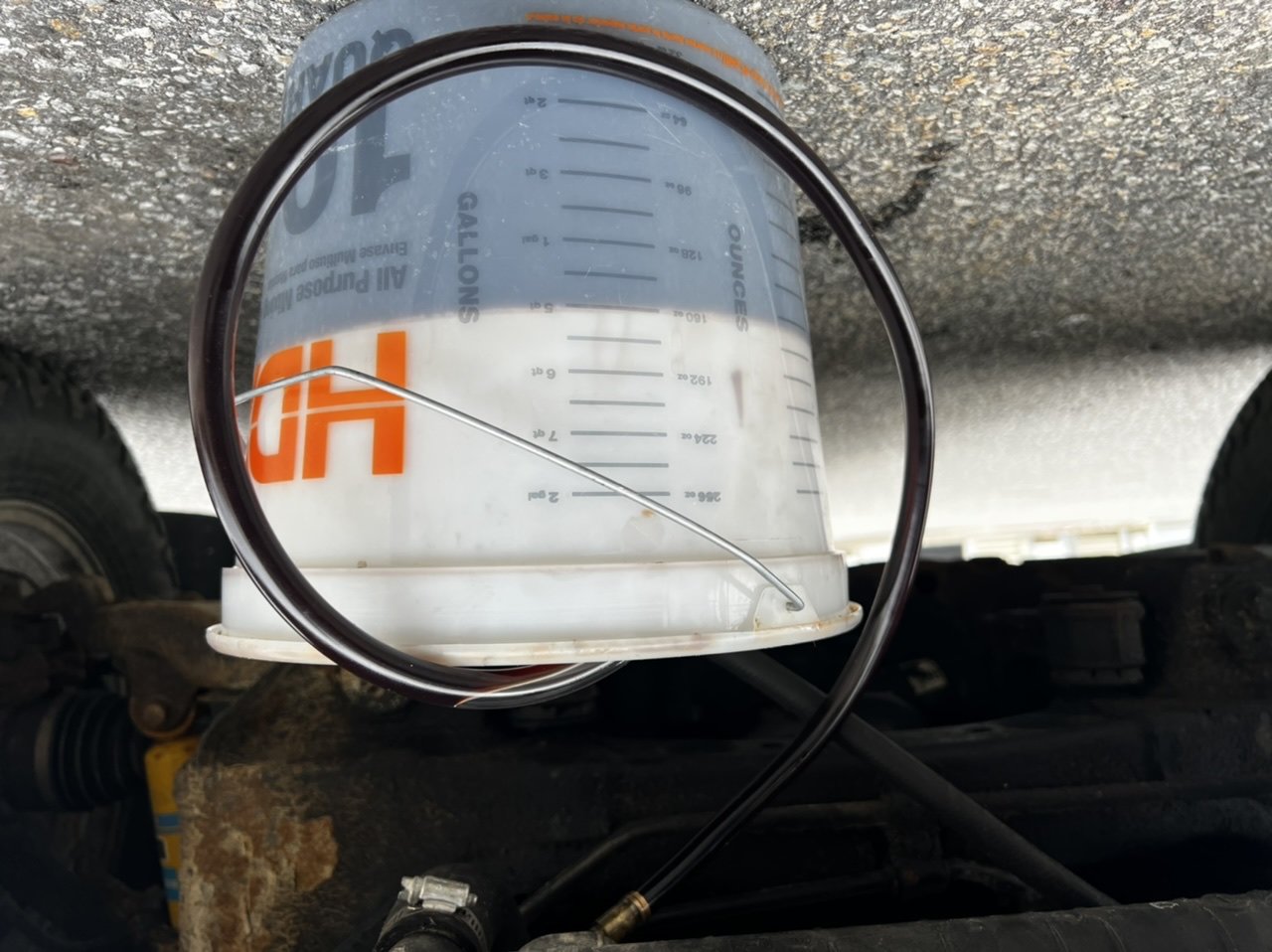

    I opted for the 3/8” inner diameter clear hose. I found it very easy to see when old fluid changed to new fluid in the process. The transmission on my 2001 automatic DCSB V6 took 3 gallons to replace. I replaced with full synthetic Valvoline ATF high mileage. The gallon jugs have graduated marks on the side which make titrating the fluids simple enough. the whole process did require my wife helping me out with starting the truck a few times, but it was simple and pretty satisfying seeing the maple syrup turn to ruby red ATF.
    22F5F2A2-B0DF-4FDB-9CCD-80B458DECF47.jpg 804E98A3-F1A8-4719-8CF3-187B23A8CD0F.jpg
    After 1000 miles of mixed highway/city/dirt road, I have noticed no big change in shifting. Sometimes I felt as though it didn’t hesitate as much at high speeds, but that’s probably my imagination.
    Using a scan tool I noted the ATF temp sensor ran 180-190F when warm on highways before the flush. After the flush, I actually had a difficult time getting it up to 180F in order to properly recheck the level. Now it runs about 160-170 when warm on the same highways carrying about 400lbs of weight in the rear. Testing was done at ambient temperatures of about 72F.
    In the absence of evidence-based consensus on this topic, I thought others might benefit from hearing my anecdotal experience. I wouldn’t hesitate to do this again. My dad recently bought a 2000 Land Crusier with spotty maintenance history and I plan on fully refreshing that transmissions fluid as well.

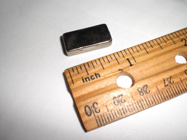

    If you do drop your pan......doesnt hurt to thro in couple extra of those tiny neo magnets ...
