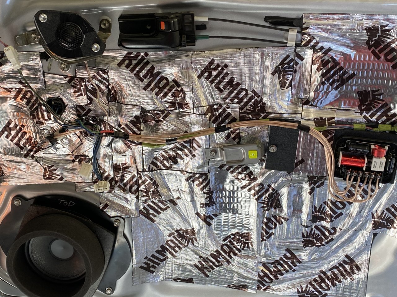

    I managed to mount each of my crossovers inside the doors by using some leftover pieces of ABS plastic as mounting brackets.
    2 years installed no issues
    soundman98 and CowboyTaco like this.

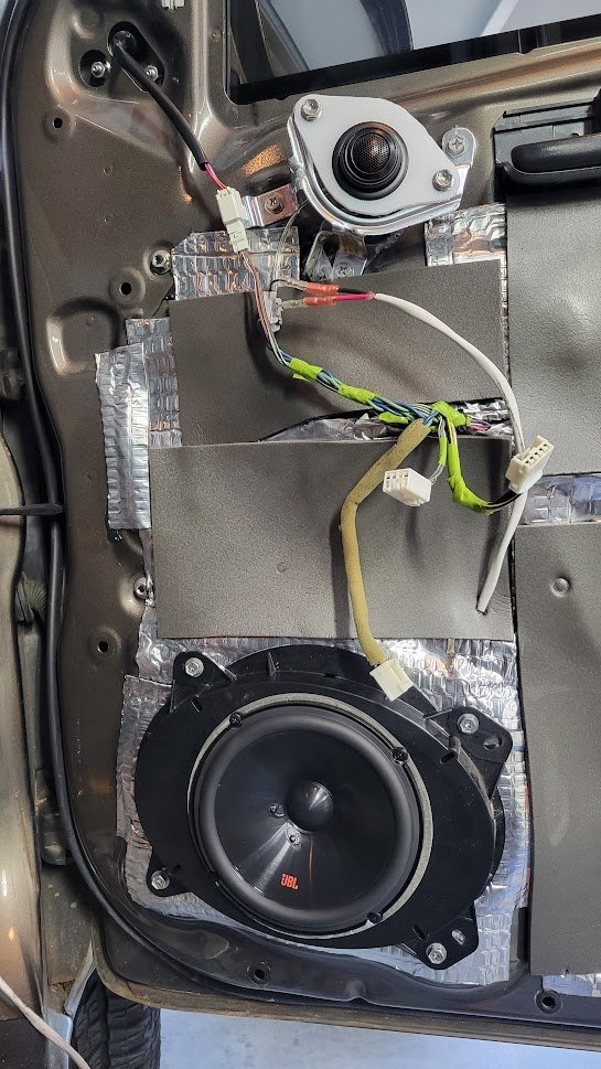

    So I wanted to mount them to the door as pictured above, but the speaker wire I ran when I installed the 6x9s wasn't long enough to reach there. So rather than run new wire all the way back to the amp, I pulled the wire back through the door and put the crossovers sort of up above and behind the kick panel. I attached it with some velcro to hold onto the carpeted piece up there. Between the velcro and pressure from the other stuff around it, I don't think they will move. Then ran two new wires into the door. The end result looks something like this:
    LZ7Swvh8bEBPSwjOE04soaJ8iW877AUx9EteND_n_54019f9ab34e6ddafea36a527e71b508d6e017da.jpg
    Tweeter adapters were made from a cheap walmart cutting board (under $2). I used the OEM tweeter as the template for the new adapter.
