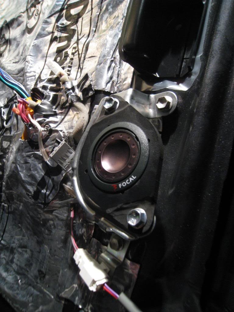

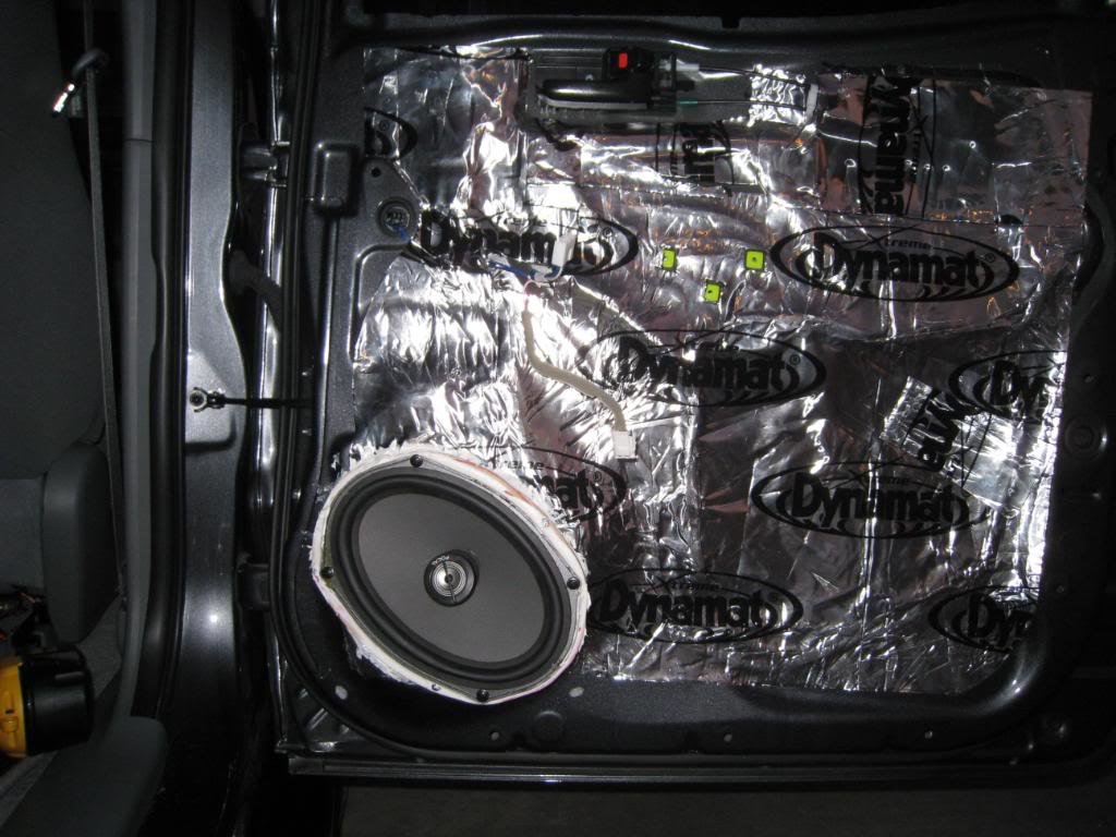

    There is a trick though ill let you in on a little trade secret here. Focal speakers function better in a sealed environment. If you dynamat the entire door to seal it like this:
    Then you can tune them to not only have crystal clear mids and hi's, but also a very decent low level that will surprise you. I put a pair in a single cab that only had the front components and no rear speakers and by sealing the door it sounded like it has a small 8 or even 10" sub in the back. And this is the same with my double cab too. I can turn my sub off and make my Focal's sound like full range system with great frequency range and still be clear.
