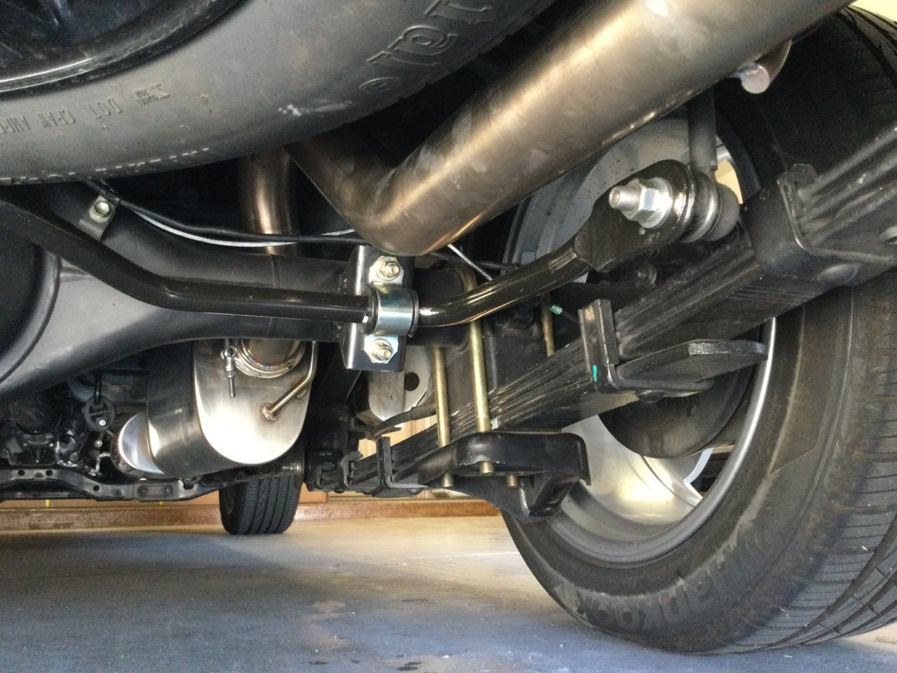

    Purchased them for the shipping cost and they were definitely heavy duty DJM welded steel blocks or definitely over built. Otherwise they been going for scrap metal. lol…
    These fairly light weight trucks don’t need that much over built blocks. I’m sure DJM uses the same blocks for a Toyota or a 1 Ton Ford, Dodge or Chevy…
    I used extruded aluminum blocks for the little bit of weight savings. Excuse the anti-seize on the exhaust, that stuff gets everywhere…I was coating the stainless V-ban clamps.

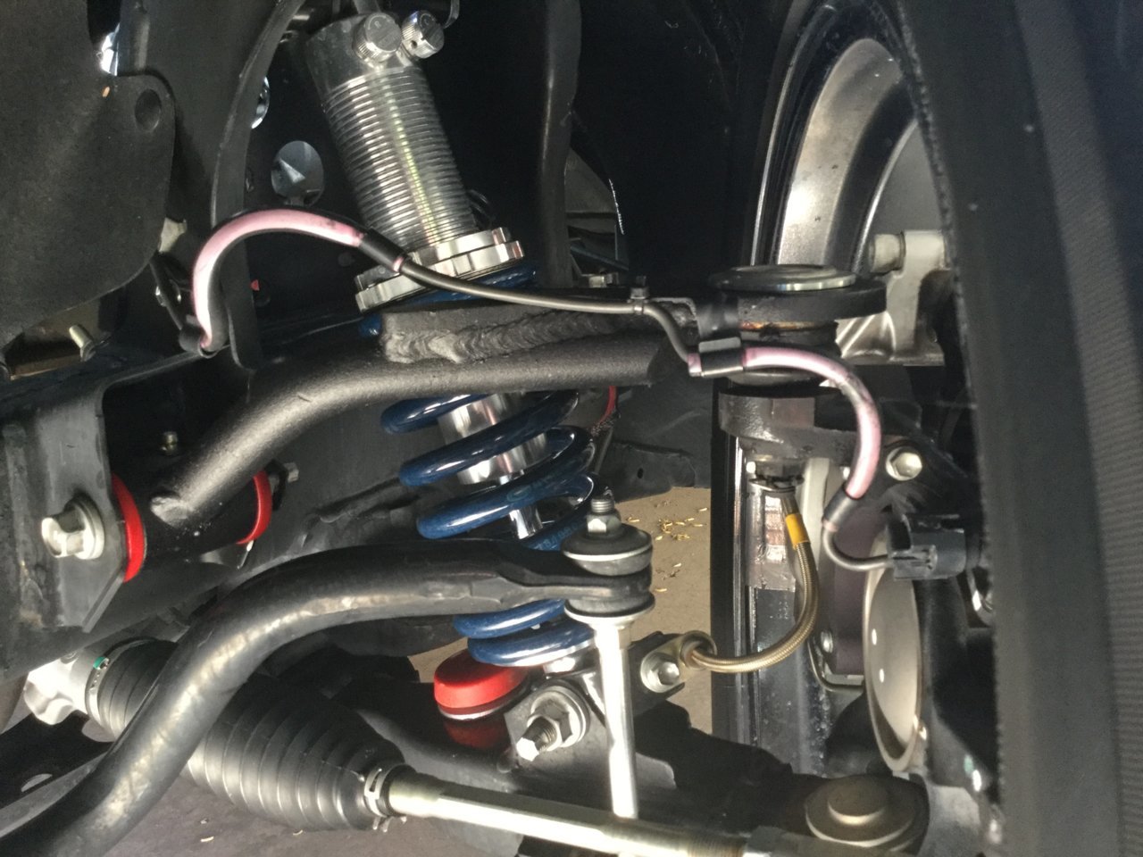

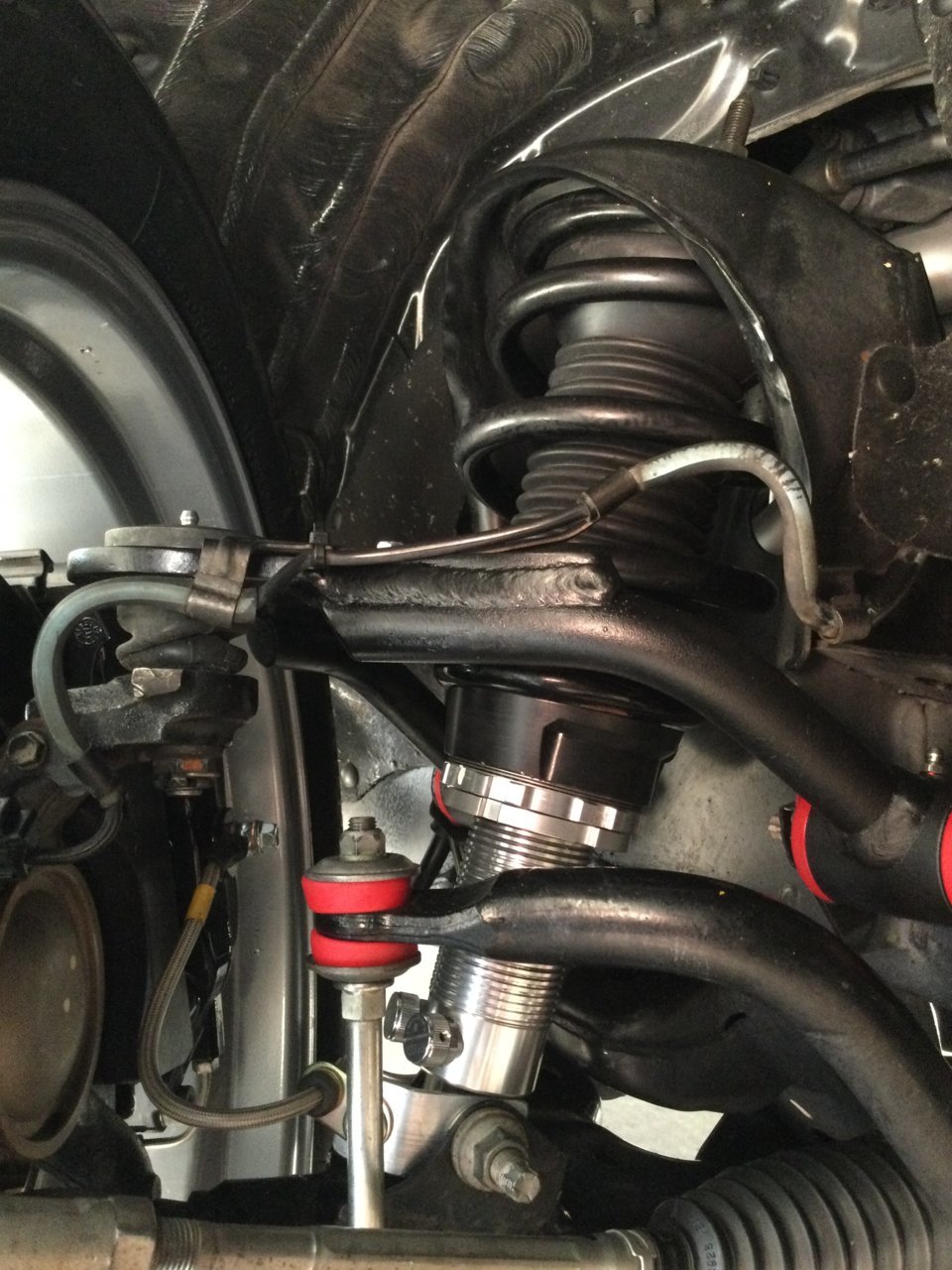

    @hayrider2.0
    I see that you fabricated your own coilovers. How do you like them and what kind of driving do you do. Im located in southern cali so I do take the truck to Angeles crest and it handles great but want better.

    @Slowtaco97 ,
    Well being you have a X-runner with the stiffer front OE springs and if you go to a aluminum LS the aluminum LS is probably almost as light as the 4.0L 1GR but I really don’t know. But what I do know is I tried a set of factory X-runner springs with the kit that SOS sells and I’m still using the bottom mounts / spring perch’s. They coil-bind the bottom of the spring or shorten the spring to make the spring stiffer! I had them in a 15 SR-5 Access Cab with a iron block 2TR with a POS Rotrex supercharger and a steel tool box at the front of the bed.
    And out of all the vehicles I have ever owned this was the stiffest ride I have ever owned. So my advice is if you know a welder that can fabricate some upper shock mount go for a 2.5” x 12” coil-over setup or do what I now have. I can PM you my number and I can explain better. Before I was hayrider2.0 I was on here as Hayrider and somewhere I explained more detail about the front and rear shocks.
    Be careful on the rear shocks you purchase because bottoming out a shock will kill it! I like the Viking’s because they have more lengths to pick from. It’s kind of a pain to adjust but they go from the shock is blown out / not working to who welded in a steel poll to the shock mounts!
    I would be happy to help with what little I know from trial and error mostly errors!!!
    :anonymous:
    Also for the front if you only want to go about an 1” to 2” lower than you are now you can get away with just the upper DJM mounts. But do yourself a favor if you buy the DJM mounts contact Kathy at DJM and either buy their upper ball joints or have Amazon deliver ball joints to them. Take my advice because I have taken their upper arms to shops to have ball joints pressed in and have wasted 3 ball joints. The holes can be not so round and DJM can clean up the holes before pressing them in. I’ve purchased 3 sets of upper control arms from DJM. Just be nice to Kathy and she will press them in for NC. She really is nice if you start off on the right side of her.

    Look at the picture of the kit. The stops with the hole in the center. I had a part number now I can’t find it. The funny thing is that they say don’t use it as a bump stop. The hard part was finding the flat allen head bolt it’s either a 8mm or 10mm I need to mic the bolt.
    https://sosperformance.com/products/tr1520-15-front-2-rear-lowering-kit-fits-xrunner-2005-2014
    I would consider the U-bolts and blocks in the above link. Some and some don’t have drive line vibrations with tapered blocks. There’s all kinds of blocks on FleBay and Amazon. I need to know more about the suspension before I can recommend the shocks and lengths!
    Also so good information on coil-overs here!
    https://www.tacomaworld.com/threads/5lug-coilovers.541417/
    And one last thing I’m using Viking C208 front shocks. If you use the standard coil-over 2.5” springs I would use the 12” springs but I really doesn’t matter because this photo below is with 10” springs.
