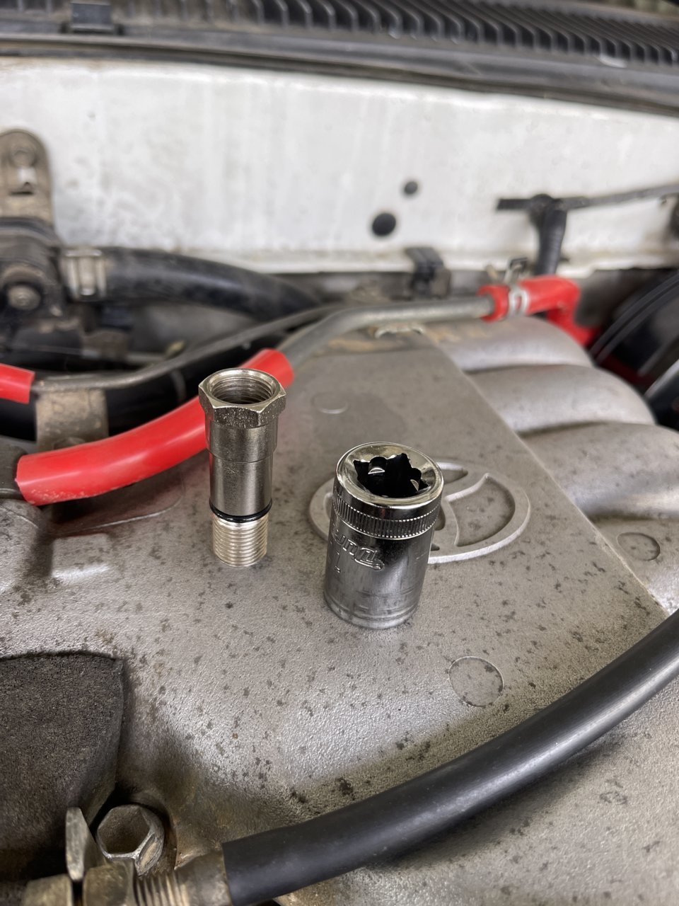

    Little bastards. Threads don’t look very destroyed either. Thanks to everyone who put in helpful replies anyways.

    I've never had to put a socket on a compression tester or adapter. They should go on by hand. If it doesn't your threads are already screwed. Chase them first. The o-rings do the sealing. If you needed to get the adapter a little more snug on the hose do that first, several tight wraps of electrical tape for insurance and twist it down into the wells. Finger tight at most and that's on the rubber hose so not much.
  4. Aug 9, 2022 at 9:34 PM
    #24
    Nessal
    Nessal Well-Known Member
    Dec 30, 2012
    #94081
    1,433
    Texas/Bay Area
    2003 V6 4X4 TRD DCAB
    I'm trying to figure out how it got stuck in the first place. I have a very similar comp tester and I screw in the hose tight to that 17mm adaptor and then I hand turn it as a whole unit into the spark plug tube.

    I’m really not sure either. The threads on the adapter did look a little dull but not enough to cause cross threading. Either way, I’m a little nervous to try it again tomorrow lol.

    I had a compression tester get stuck in a hole like that. The crimp got loose and the hose was just spinning. Can't remember exactly but I think I pulled the hose off, jammed a big slotted screwdriver in the adapter and got it to come out

    That’s what I tried at first but the threads wouldn’t fully spin on all the way. When I turned the engine over the compression literally popped the hose off flying. I’m starting to think maybe it’s just the threads on that particular #1 cylinder plug.

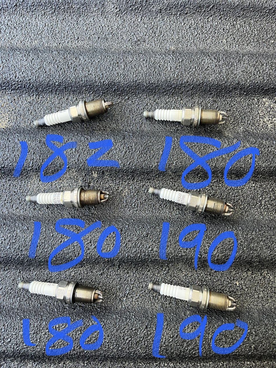

    Update!
    Went at it again today. Didn’t use the pesky adapter this time and just threaded the hose on by hand. I’m pretty stoked with these results. Motor is at 293,000.
