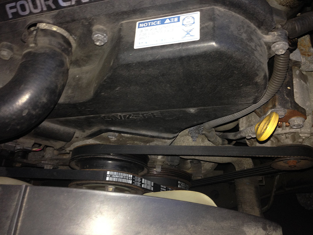

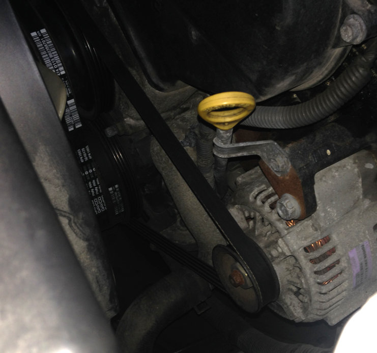

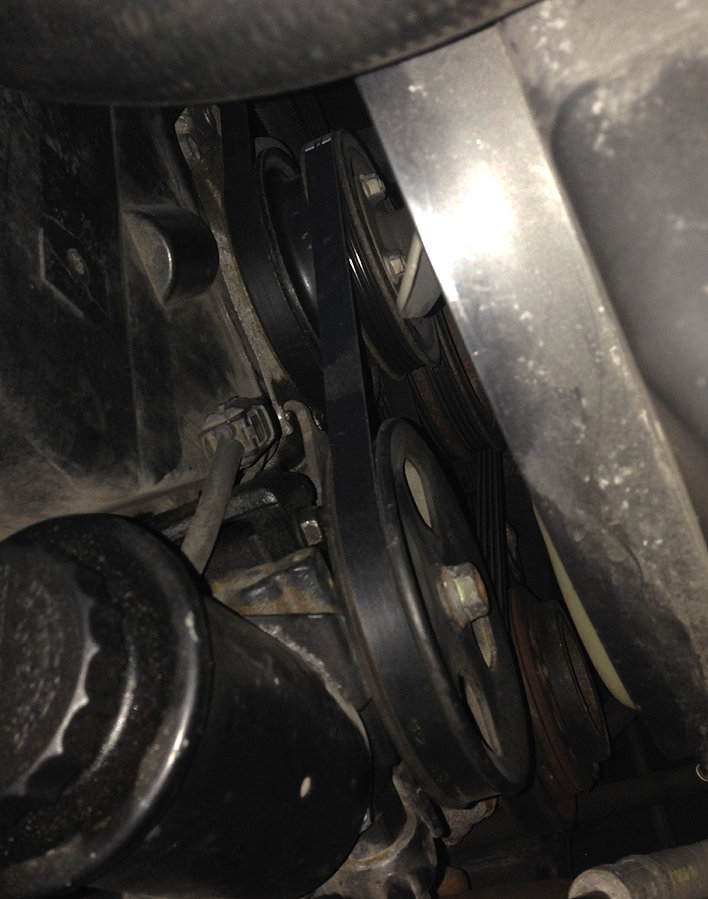

    Drive belt, power steering and alternator belts changed at Firestone complete autocare about 6-8 months ago. They were changed because they were initially frayed and tearing.
    Ever since the belts were changed I notice a slight heated rubber/almost burning smell coming from the front grill area even after driving for a short distance of a few miles.
    I brought it in again a couple days after they changed the belts and they claimed they tightened the belts a little and they also said they didn't think the pulleys were seizing but I STILLhave my doubts because of this smell...
    Every few weeks I open the hood to check on the belts and they still look newish, I don't notice any major wear but then again I have driven the trunk less than 3,000 miles in the last year.
    I am concerned that the pulleys are not rotating as smooth as they should and therefore causing the belts to heat up more than normal. I remember as a kid we had an old Kirby vacuum and the belts would sometimes overheat and break.. Its kind of like that smell just not as strong/bad or intense.
    Its possible there is just some oil burning but it does have a distinct rubber smell.
    The truck has 201,000 miles on it and its likely the pulleys are original to the vehicle.
    Has anyone else had this issue? Firestone wants me to take it in again. Is there a more exacting way to detect if the pulleys are turning as smooth as required?
    I just don't want this problem to lead to a messed up engine and more costly repairs. I understand Firestone is not an expert on Tacoma's so I figured I'd run this buy Tacomaworld for any input.
    Photos here:
