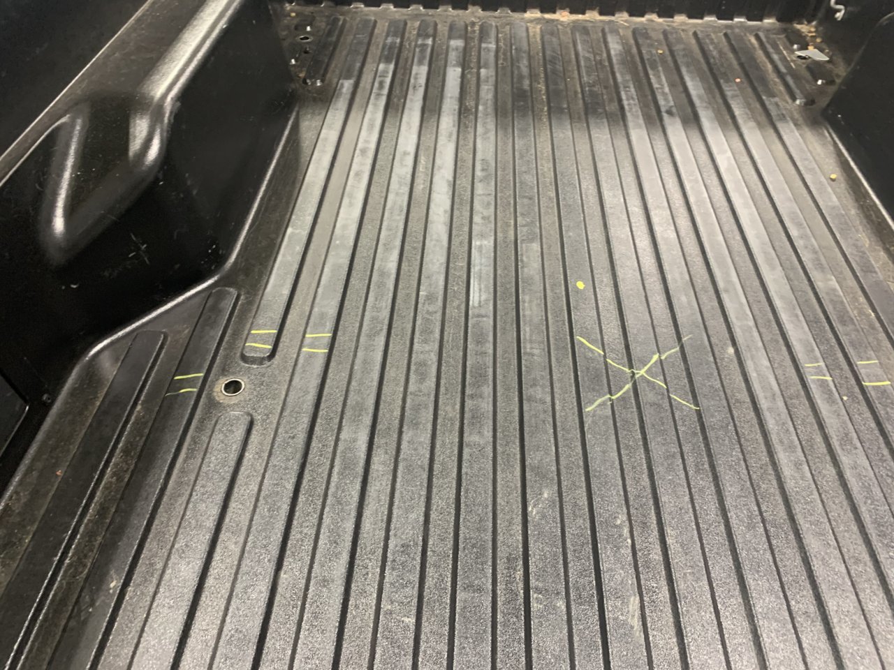

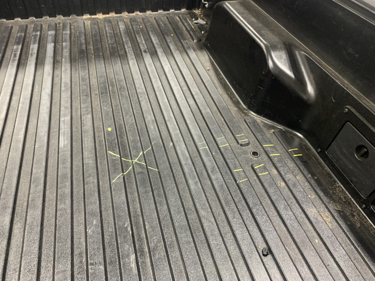

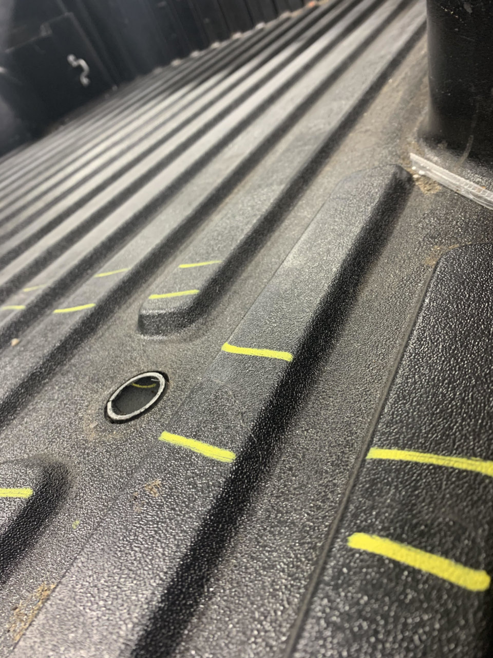

    Hello all ... an update!
    Took the truck to multiple body shops (6). Quotes ranged from 2500 to 3500. Insurance gave me 2500.

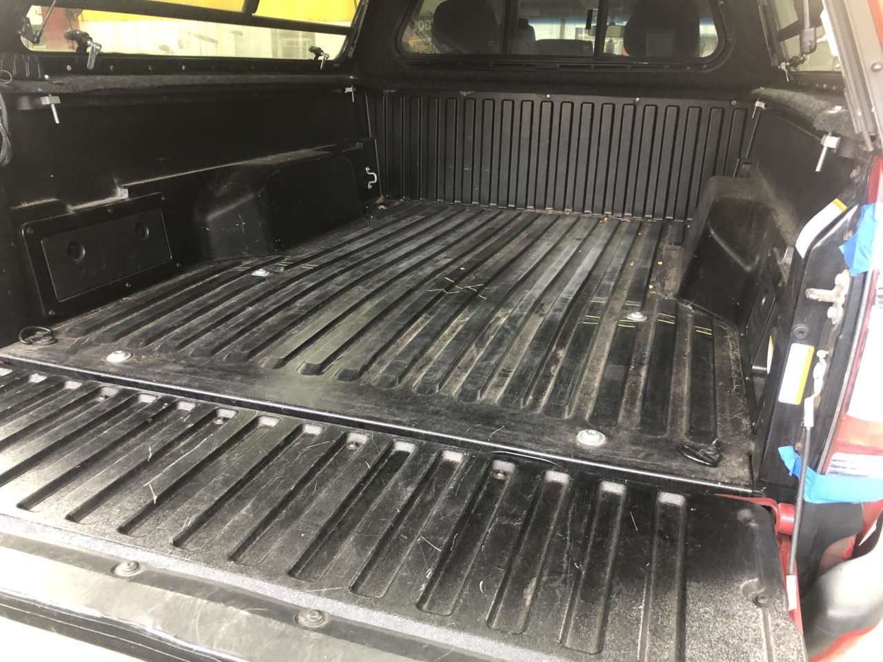

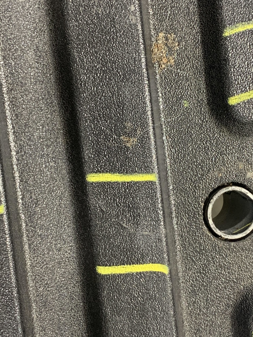

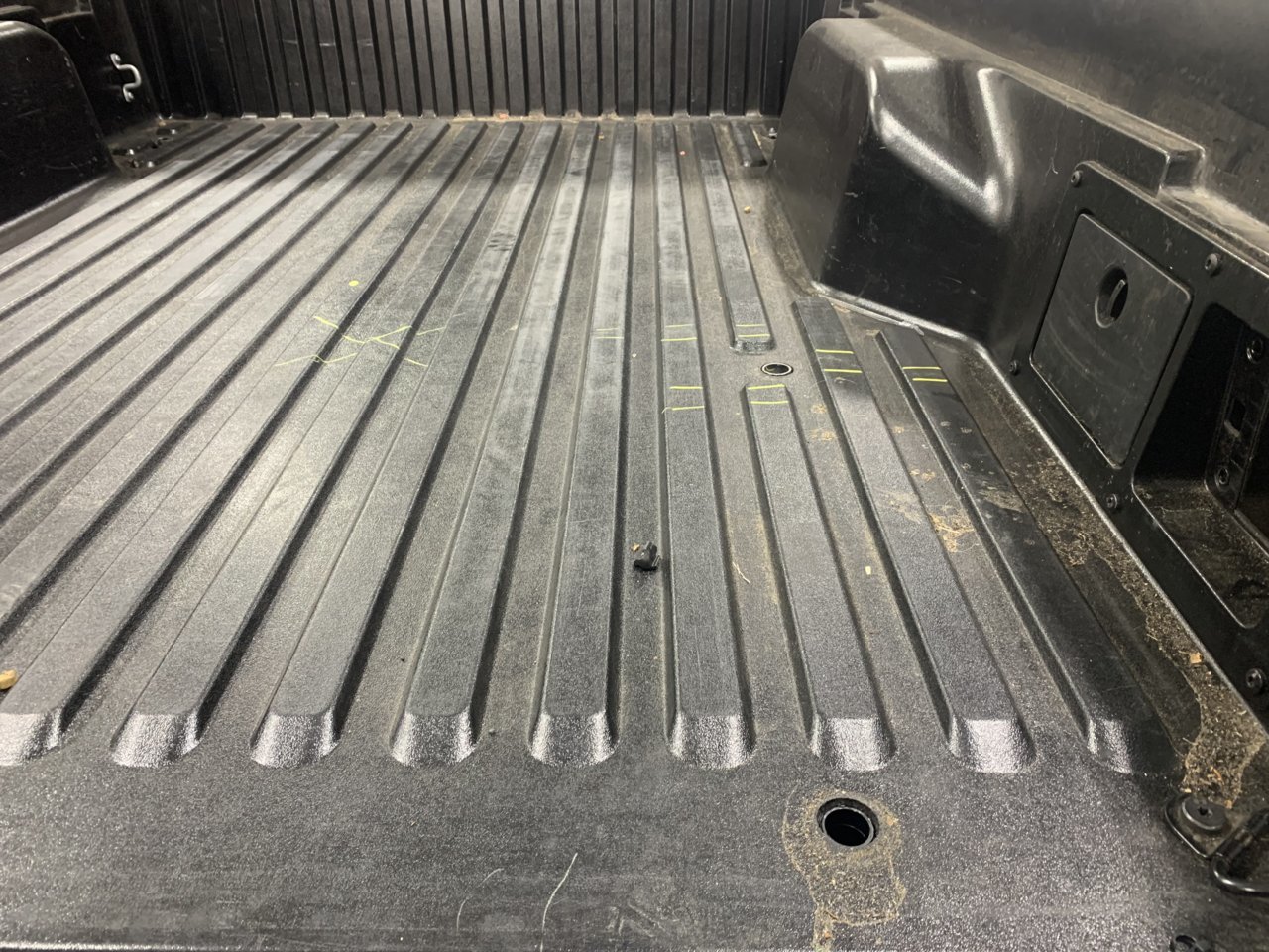

    Body shop took it apart and is claiming the bed is "cracked" or has "bumps" due to frame damage. Has anyone heard of this? This is causing the estimate to skyrocket to $21,000 (includes frame replacement). That totals the truck :(. I am absolutely trying to save this truck.
    Has anyone heard of the frame coming up so high that it messes up the bed at the location shown? I personally don't see any bumps.
    P.S. I also have a white dog with long hair, so some of that is definitely dog fur.

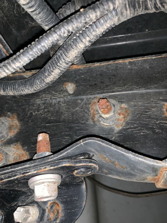

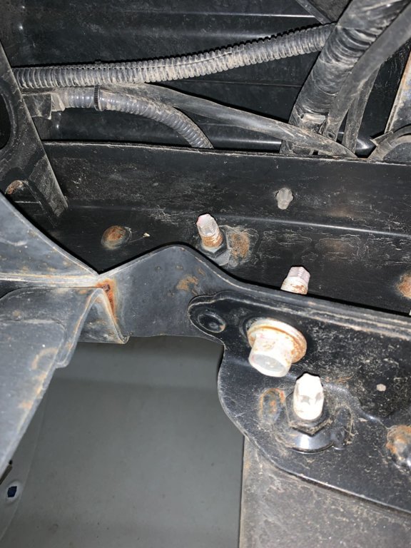

    Yes. I got rear ended in June and my frame had similar damage but until the bed is taken off, it’s hard to know if the frame deformation is just at the hitch area or additional closer towards the cab. On mine, just the downward bend of the frame and furthest rear bed bolts caused the visual bed bend and gap change where it meets the cab. Once the bed was removed it fiberglass popped back straight.
    here’s mine:

    Were they able to straighten your frame?
  14. Feb 24, 2020 at 8:48 AM
    #94
    EdinCincinnati
    EdinCincinnati Well-Known Member
    Mar 11, 2013
    #99457
    2,434
    Ed
    Ohio
    2014 4x4 TRD OR
    yes...you can still see a small curve in the lower horizontal just in front of the hitch but it’s straight.
    I just removed and self installed a rear steel pelfreybuilt bumper and all the holes were perfectly aligned.

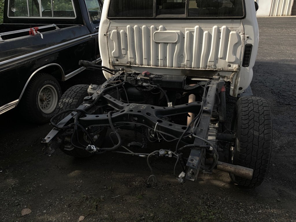

    They are claiming that straightening the frame is not an option because it is a "diamond frame," meaning that it is not only bent but twisted. So now the frame can only be replaced, which honestly is what I preferred anyway.

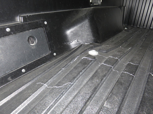

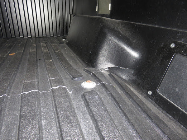

    The bed is fiberglass composite. The crack lines show white fiber. Happened to me earlier. Mine was a higher-speed collision (police estimated 50 mph), so the bed damage was more noticeable. I got a new 3rd gen after the ordeal.
    NEnq2d7WpeuPULXrVoxv1ckMmfzSUXO2YayI5faF_24f784de0609038d1d5acdd2834a0a874aabd00e.jpg ZYoskWXeviNe4cEeo7YZlIu0OAqv2UvH2k9d2_5e_601ce96b9c35f45f46f853c04f51c76674b3d6c2.jpg
    Why are you against totaling the truck? Frame replacement means the truck is basically disassembled and put together again by Mechanic Bob. All it takes is one pinched wire or flaky connector pin (out of the ~200 that are disconnected) for you to have electrical gremlins forever. This along with cracked vacuum hoses or contaminated fuel/coolant/refrigerant lines. Example: BlueT's 4WD didn't work correctly after frame swap: https://www.tacomaworld.com/threads...thanks-toyota-for-frame-swap-problems.415761/
