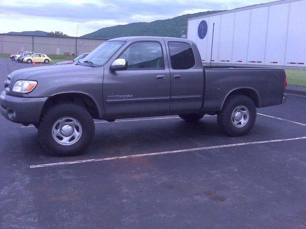

    05 Tundy rockin the Billies on all 4 corners. The spacer lift will give a rough ride. would stick to your guns about the Billies. Keep in mind there is a backorder (again). Another option is the OME route. They gain lift by using a different coil.
