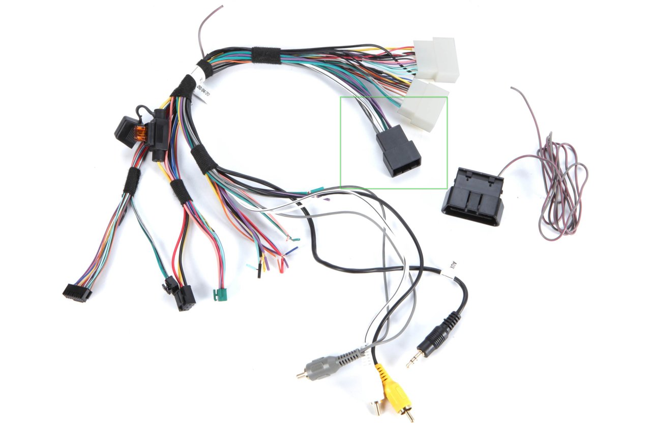

    Looks simple enough, looking at that unit it looks like it takes high level inputs so you would want to tap in behind your headunit typically into the rear left and rear right speakers. But in our trucks we have 6x9 up front and 6 1/2 in the back so I would opt to tap them into the front left and right speaker leads since it should be a full range signal.
    If you don't have the JBL system, this should be a breeze. Pay no mind to the other harnesses here, the black harness would match to your speaker harness on the back of the radio and the whites and greys would be your wires to tap into:
