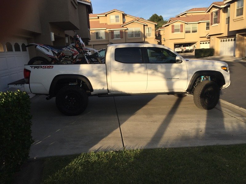

    MZ202
    The fact you’d like to run 18” wheels leads me to believe you’re not going to really offroad this truck more than a dirt logging road.
    Therefore I believe the 5100’s will be a good choice being that they are the same valving as the TRD off-road, how ever give the ability to be run at a higher front height obviously. Nothing crazy is going to change up front handling wise.
    I pulled the front sway bar out of mine with 5100’s and even that didn’t do much in the way of making the truck handle different (in any negative way).
    Photo attached - fronts at one notch below max setting. Rear 1 inch block.
    Fronts not at max, due to not having to worry about cv’s
    Rear 1 inch block cause when I did the lift people were going Crazy about rear diff howl and ‘problems’ therefore kept it lower to prevent any dealership back lash if anything happened to mine.
    Just being Cautious. Lol. Next year I’ll re-lift the rear.
