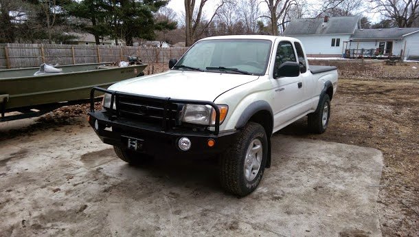

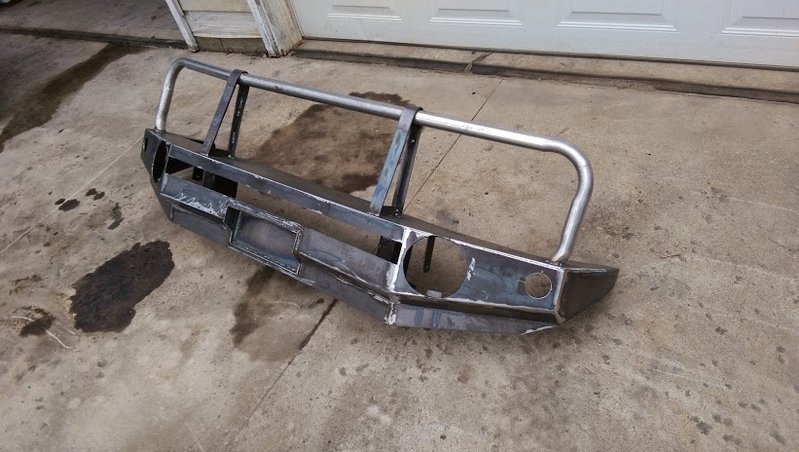

    I hear you. Your reasons are the exactly the same I built my ARB clone.
    I copied everything I could, but opted to drop down a size in sheet steel for weight savings. I'm running original TRD springs and only ended up dropping the front end 1/4" (give or take). Could be more now, but its not enough for me to go out and buy heavier springs.
    My intention was never to prevent damage when I or if I contact a deer. I only wanted to protect the radiator enough to reduce the chances of a puncture. Basicly, I just wanted to increase my chances to limp home. I fully expect front end damage when the time comes.
    I think my home made Australian 'Roo Bumper looks great and I expect it to serve me well. Unfortunately, I can't tell for sure until I have a deer/car interaction.

    Wow, you built that bumper on your gen 1? That looks great!
    I would really like to build my own, but I don't have the skill or finesse to do it :(

    here is a better pic.

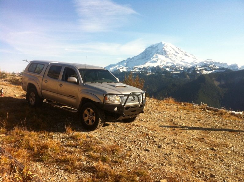

    I had my ARB on stock springs and shocks. The ride wasn't bad except that I bottomed out (nosedived) a fair amount and corners were sometimes sketchy. With adjustable bilsteins I would say you could make up for any loss in height.
    I will link some pictures when Photobucket is back up..
