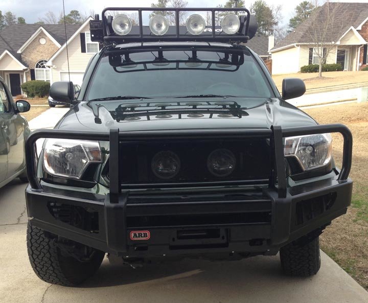

    I should start off by saying that I have a 2012 DC 4x4 and I have done some write-ups on the Baja Racks Roof Rack and the lighting that I installed. As with most of my projects, I was assisted by my brother in arms DAC.

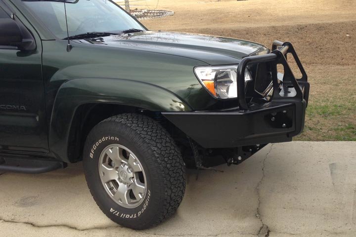

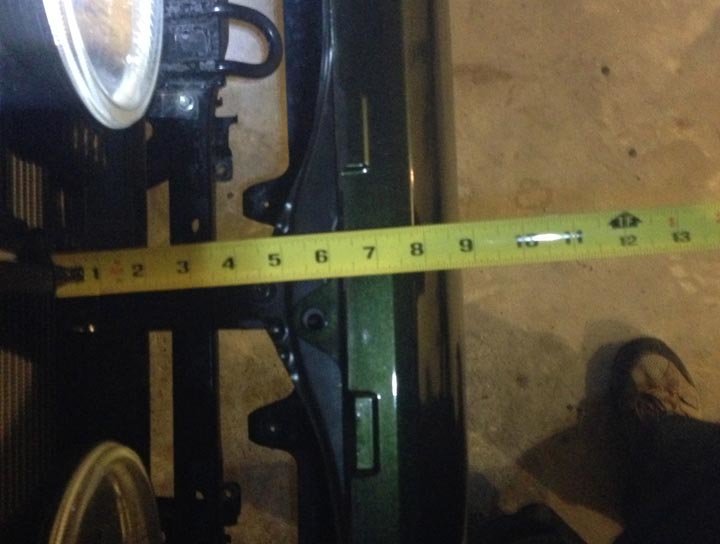

    Due to all the hype about how far the bumper sticks out I decided to measure the original bumper from the support behind the grill. I will make this same measurement after I have completed the installation for comparison.
    So, at this point I would like to say that I have several issues with this bumper:

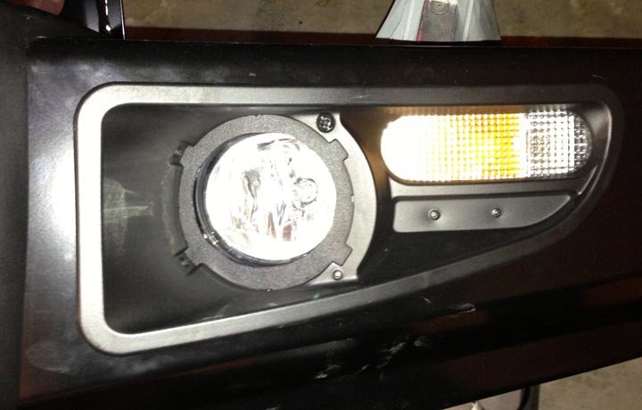

    The lights supplied with the bumper are the turn signal lights. There are no fog lights with the bumper and ARB wants you to buy their lights for another 300.00. I decided to do some fabrication and use the fog lights from my original bumper.

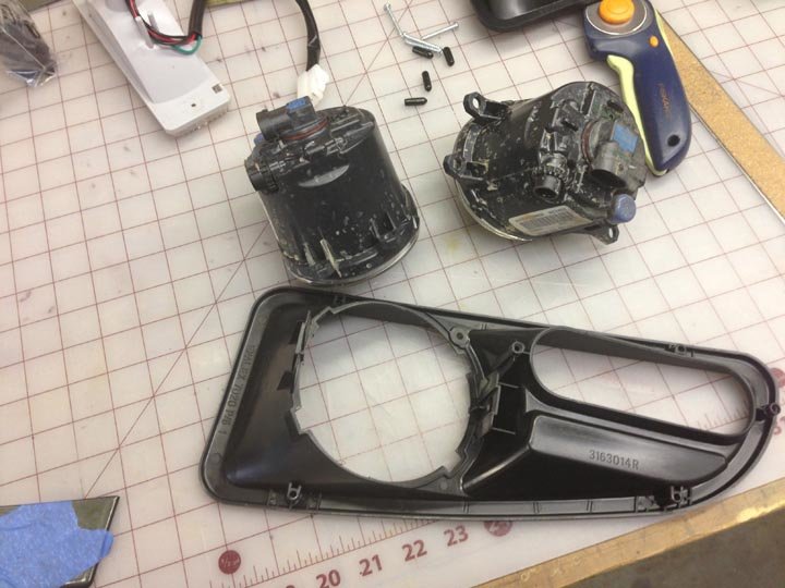

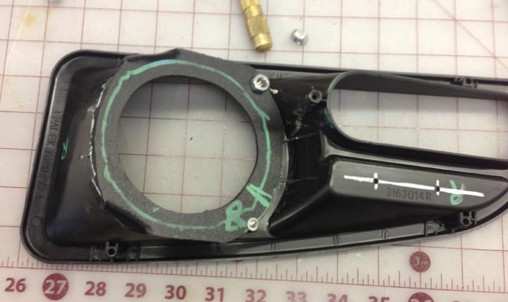

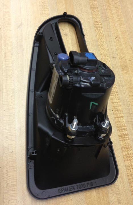

    Obviously the ARB mounts would not work with the Toyota fog lights so here is what I did.

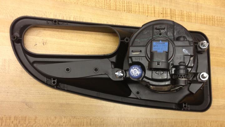

    First, I removed the two plastic mounting brackets that existed on the ARB light surround.
    I made a bezel out of some Kydex but I guess you could make it out of metal or some other plastic, or even fiberglass.
    I then made 2 metal brackets from 18 gage steel, for the bolts I would use to mount the lights.
    I cut off one of the plastic mounting clips on each fog light.
    I decided on the bolts I would use and wedges them between the metal brackets and the Kydex.
    I secured the Kydex and the metal brackets with rivets.
    I painted everything with flat black spray paint.

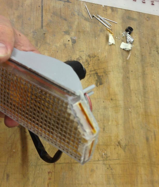

    I also realized that I would have to cut down the turn signals that are included with the bumper so that the fog lights fit.
    I filled in the opening made from cutting down the light wall with clear silicone. I let the silicone dry for 24 hours and then cut it out so that the lens cover could be removed and still seal up.
    I then installed the light surround. For the fog lights, I had to splice in about 18” of wire so that I could run the fog light wires against the inside of the bumper and connect to the fog lights. I check the aiming of the lights and everything was good to go. I have not finished wiring the turn signals yet. I zip tied the fender liners to the inside of the bumper and took the truck for a spin.

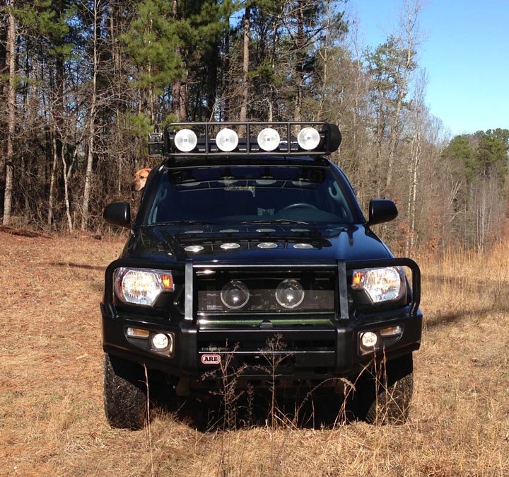

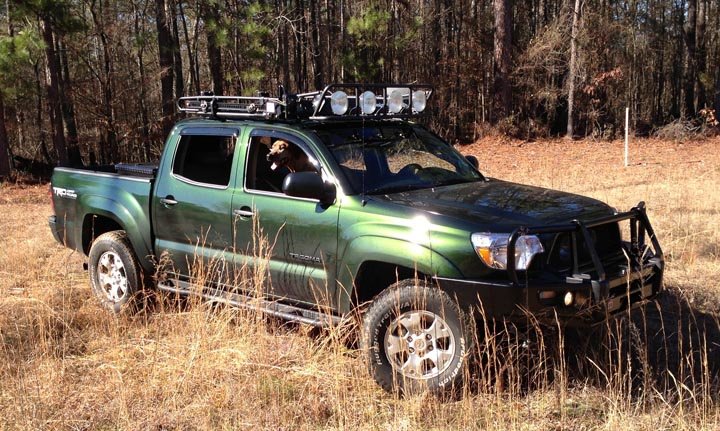

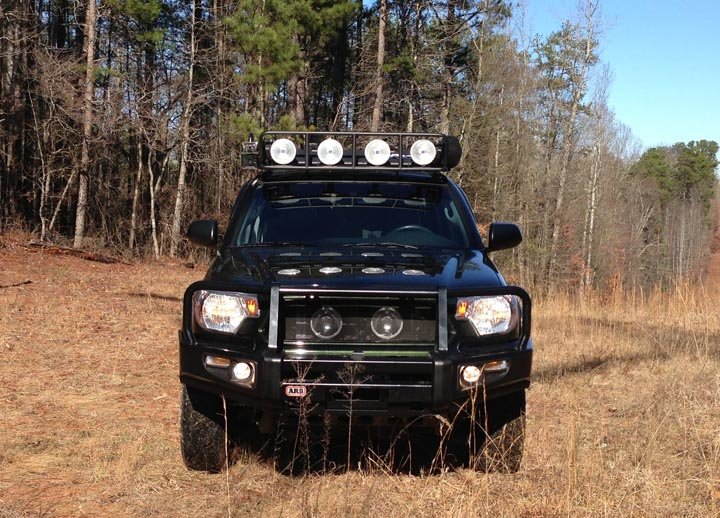

    I had to get my first 5000 mile service today so I drove on to a power line cut and took some more pictures.
    I will have more pictures once I install the winch this weekend and finish wiring the turn signals. I will also remove the grill and get the bumper measurement of how far it sticks out.

    The included turn signals are very cheap looking in my opinion. these things are rectangle and the openings are oval which looks good on the outside but on the inside of the bumper it looks like some crap that I would do to get by with what I have on hand. Additionally, the way that ARB wants you to wire these turn signals it so splice into the the existing turn signals. I think this another cheap approach to the issue. I am considering how I am going to wire these lights and I will let you know what I decide.

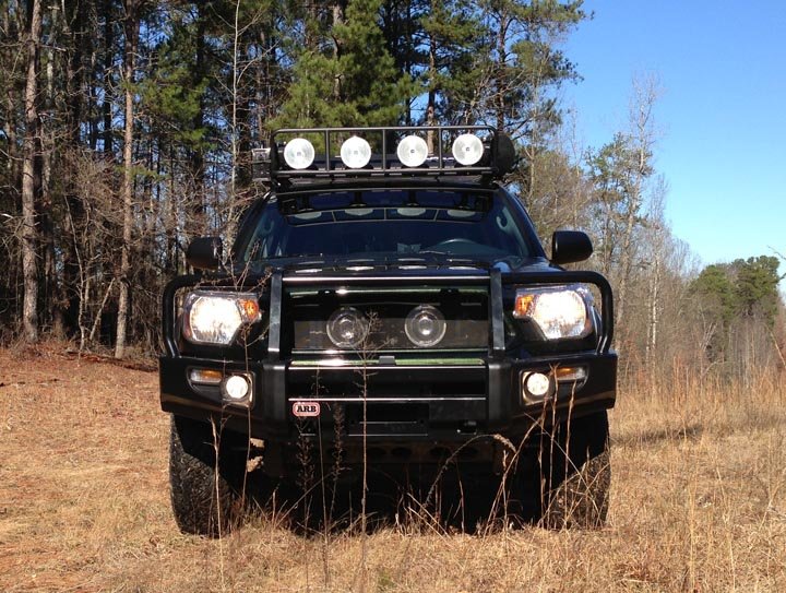

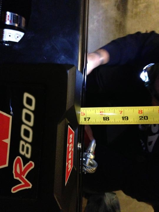

    Ok, so I have the winch mounted and I took some more pictures since we had to pull the bumper back off.

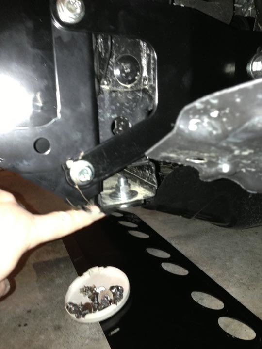

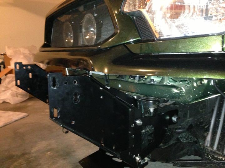

    In this picture, I show the measurement of the bumper from the support behind the grill. As you can see, it sticks our about 17” and the original bumper sticked out about 9” so the ARB adds 8” to the front of the vehicle.
    This picture shows the mounting bracket, I am pointing at the angled bottom that gave me such a hard time to get flush.

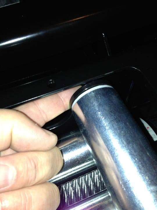

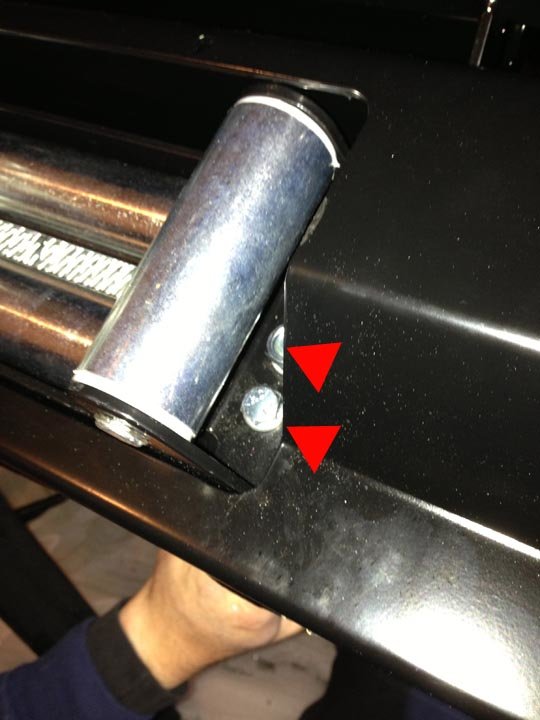

    I had to drill mounting holes in the bumper for the winch fairlead. After the fairlead holes were done then I had to drill out the 2 bottom winch mounting holes into the fairlead. These had to be done with the 2 side rollers off the fairlead.
    Putting the rollers back on the fairlead once it was mounted was difficult due to the tight area you are working in.

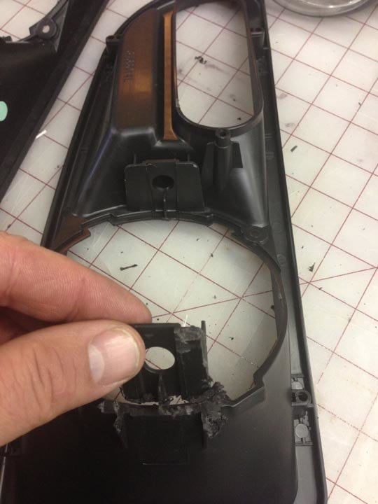

    Here is a picture showing the cut original bumper to give you an idea of how much of it is used to fill the gap.

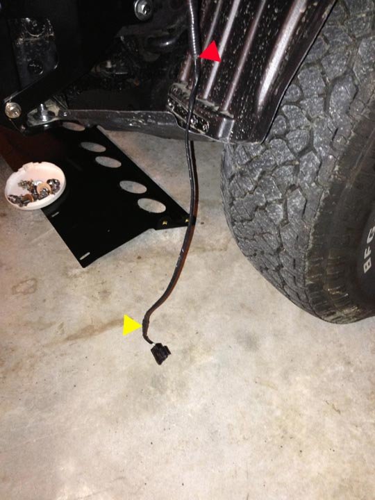

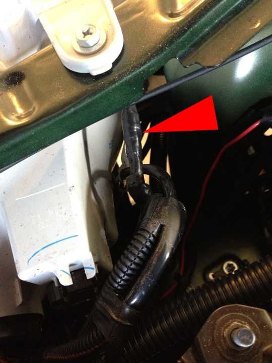

    In my previous post I said that I had to splice about 18” of wire into the fog light wire harness to give it enough reach to connect to the fog lights and be able to secure the wires with zip ties to the inside of the bumper. The area between the red and yellows is the added wire.
    Lastly, here are two pictures of the light surround to show how I finished them out. The first picture is the light surround. The second shows where the rivets are (red arrows) and the yellow arrow show the gap that is visible. this gap is because to how the fog lights had to be mounted to ensure the proper aim.

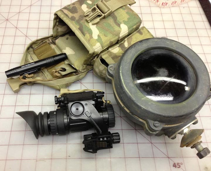

    Awesome job with the kydex mounts maybe Ill see you up here around bragg at some point. Nice truck!

    Really, IR LED's? Driving with night vision? Thanks for the laugh :)

    MWall, I am not sure what you mean by "the laugh"

    What I notice in your second pic is the bumper not lining up with front wheel well. Why can't you slide it back to fit flush, it looks 2" too far out? Time for a little more cutting.

    Treddy, ouch more modification! Actually, now that you mention it. I am not sure how the bottom section of the grill mounted and I am too lazy to go pull it back off too night. I am wondering if the grill and the molding under the headlights attaches to the factory bumper. If this is the case, I am curious how other plate bumper manufacturers overcame this issue? I will look at it tomorrow and let you know.

    #55669
    8,450
    Some Toyotas
    Round tires
    Want a halo mount or two for those NVGs?

    BuzzardsGottaEat, if you are giving them away, I am always interested in NVG BII, but if you are selling them, thanks but I am fully kitted out. If you are selling them and need some help on where to sell them, shoot me a PM and I will see what I can do.

    Ok, so I looked at both the molding under the head lights and the grill and they attach to the frame so the cutting of the bumper is not “technically” required but there are some issues.
    The way that the ARB bumper connects to the mounting bracket is by 4 bolts for each side. When you put the bumper on the bracket it will rest on the top of the bracket and then you have to lift it about ½ inch to line up the bolt holes. So drilling new holes would not be that big of a deal; however, the biggest problem I can see is that the mounting bracket will not allow you to slide the bumper back (towards the rear of the vehicle) because the inside of the bumper rests on the mounting bracket. To allow for the bumper so be slid back you would have to cut the desired slide depth from the mounting bracket. This is the only real issue I see. You will still have a gap under the grill but you should be able to position the ARB bumper to minimize the gap. Also if you really want to bring the ARB up to just under the grill, then you would need to cut into the side fenders to allow the bumper to come up.
    Well I hope that address any questions about fitting the bumper without cutting the original bumper.

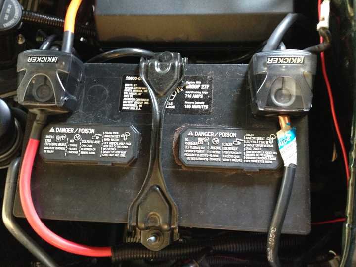

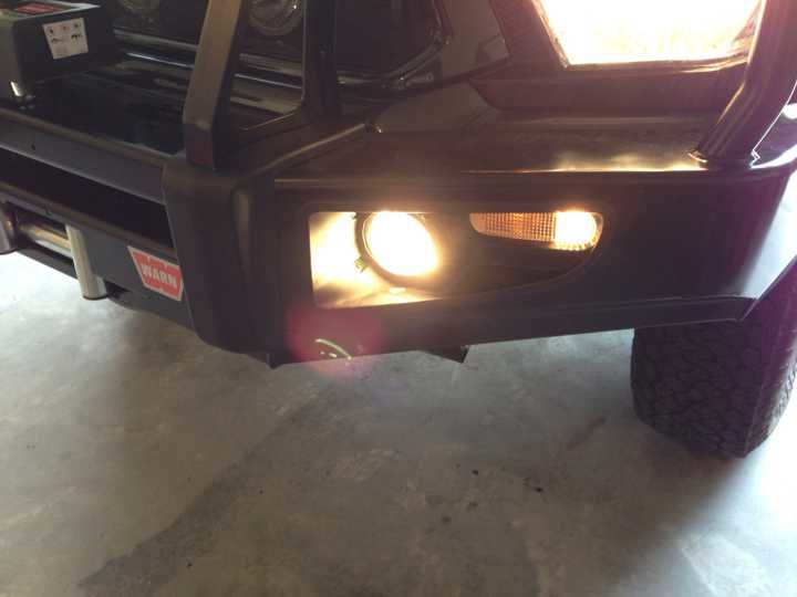

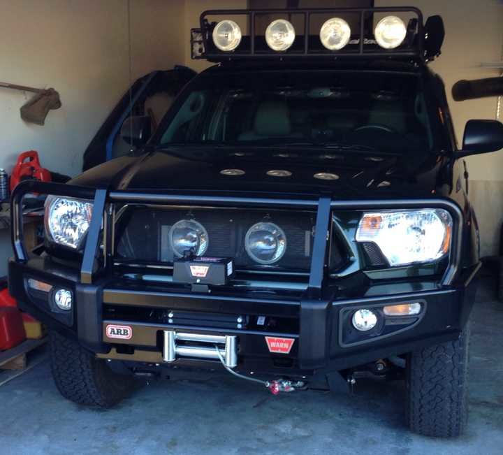

    So I finished the wiring of the lights and winch Monday. In this picture you can see how I spliced into the light wiring harness.
    If you have had the opportunity to check out my build you would know that I went a little crazy with the roof rack lighting. This has left me no ports available on the back of the kicker terminals. So I cut out the copper loops on the ends of the winch 4 gauge wires. I bent them and sanded them so that they formed a “C” shape to wrap around the battery terminals. I then modified the kicker terminals so that the winch wiring would come from the front of the vehicle and sit under the kicker terminals.
    Another picture of the working fog lights and ARB lights.

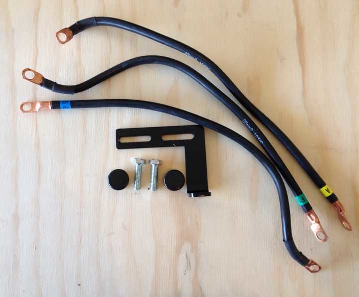

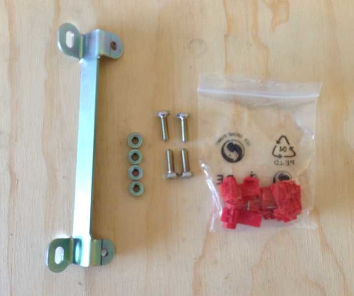

    Here are the left over parts from the ARB kit, it’s a license plate mount for the bumper and two extra winch mounting bolts. Also you can see the bag of in-line splices that ARB wanted me to use.
    Here are the left over parts from the Warn Winch. There is a control box mount to mount it to the top of the winch (ARB provides their own) and the 3 control wires (ARB provided), as well as two black plastic caps.

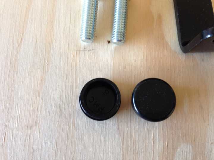

    I have no idea what these caps are for and the instructions do not address them at all. If you know what they are for, please let me know.
    And here a picture of the finished front end.
