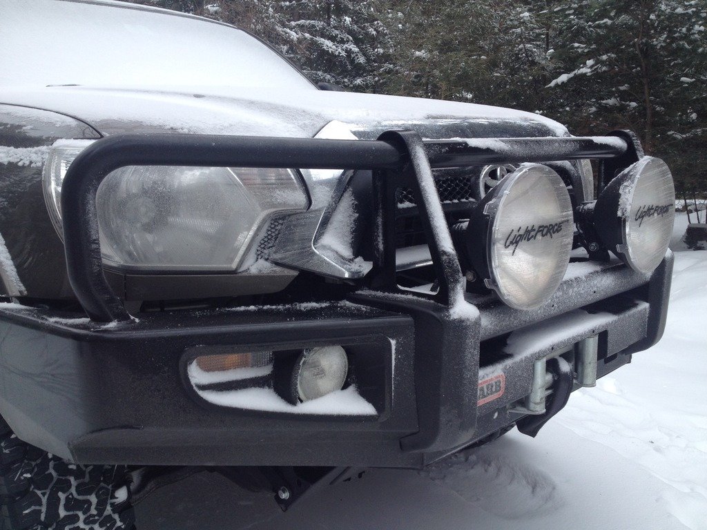

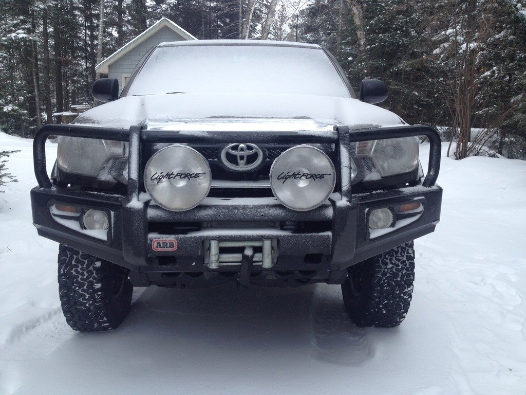

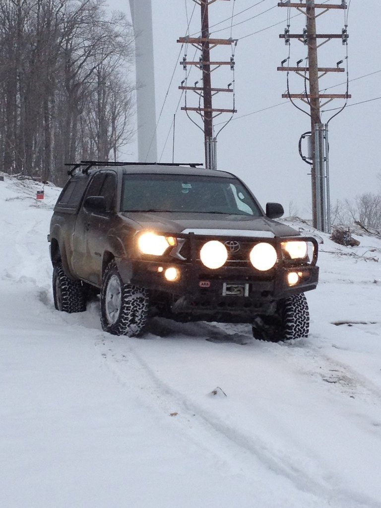

    You should be fine with the ARB on factory coils with the 5100's. I'd set the spring perch on either the second (.85") or the third (1.75") notch to compensate for the added weight.
    FYI, a 05-11 ARB fits on a 2012+ just fine. Only difference is a slight gap below the grill. No need to cut/retain the factory bumper cover, and doesn't stick out nearly as much. :thumbsup:

    NMW, that looks auesome! Could you post some closer pictures of the gaps around the grill?

    Sure! I'll take some close up pics tomorrow in the daylight and post them up.
    Thanks!

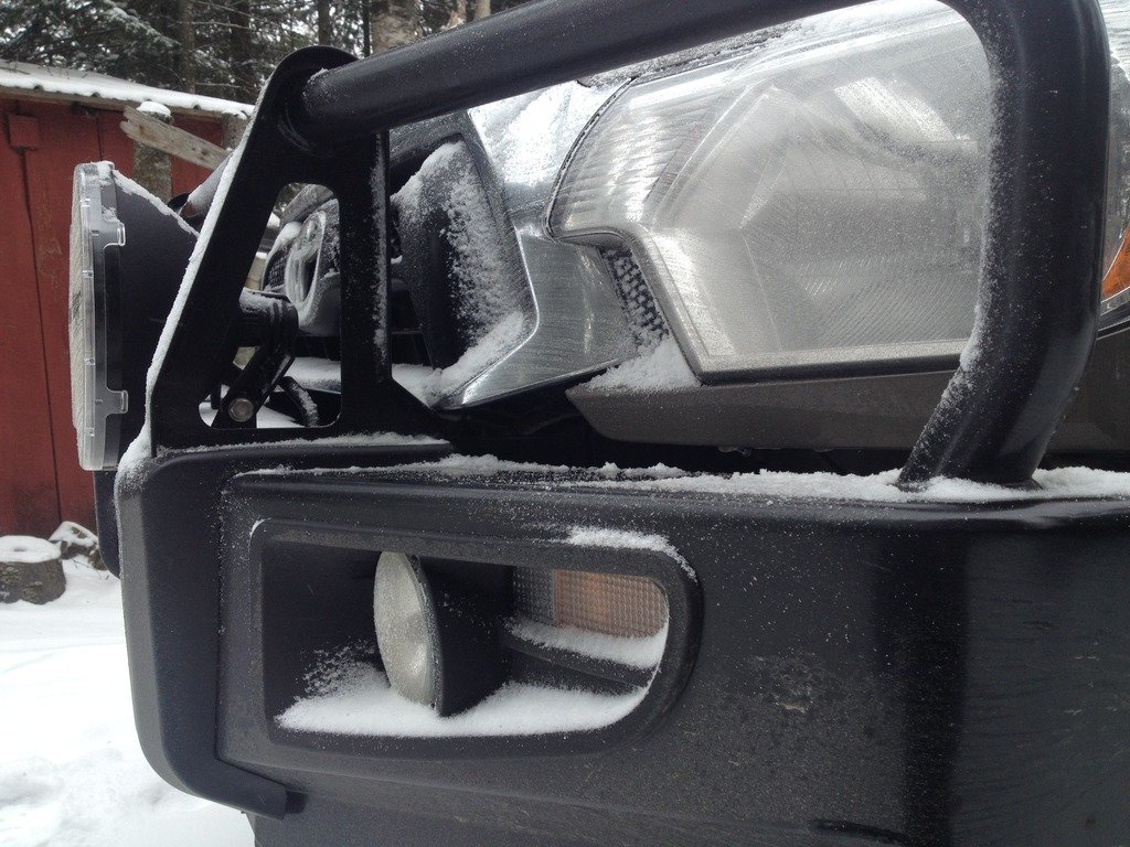

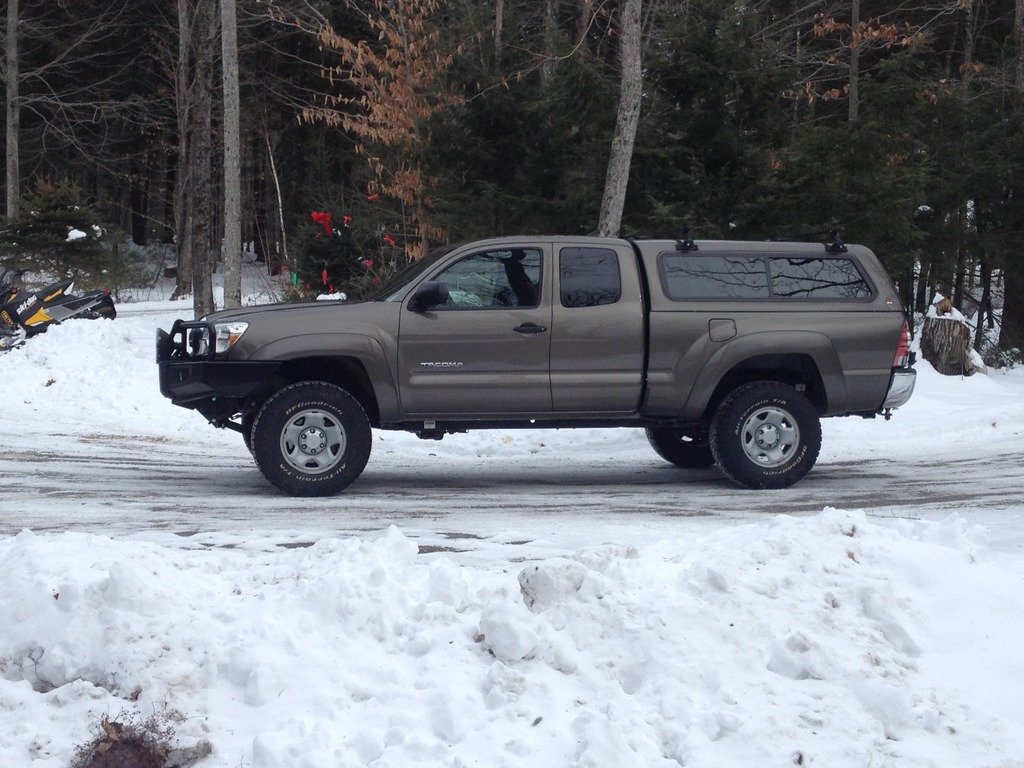

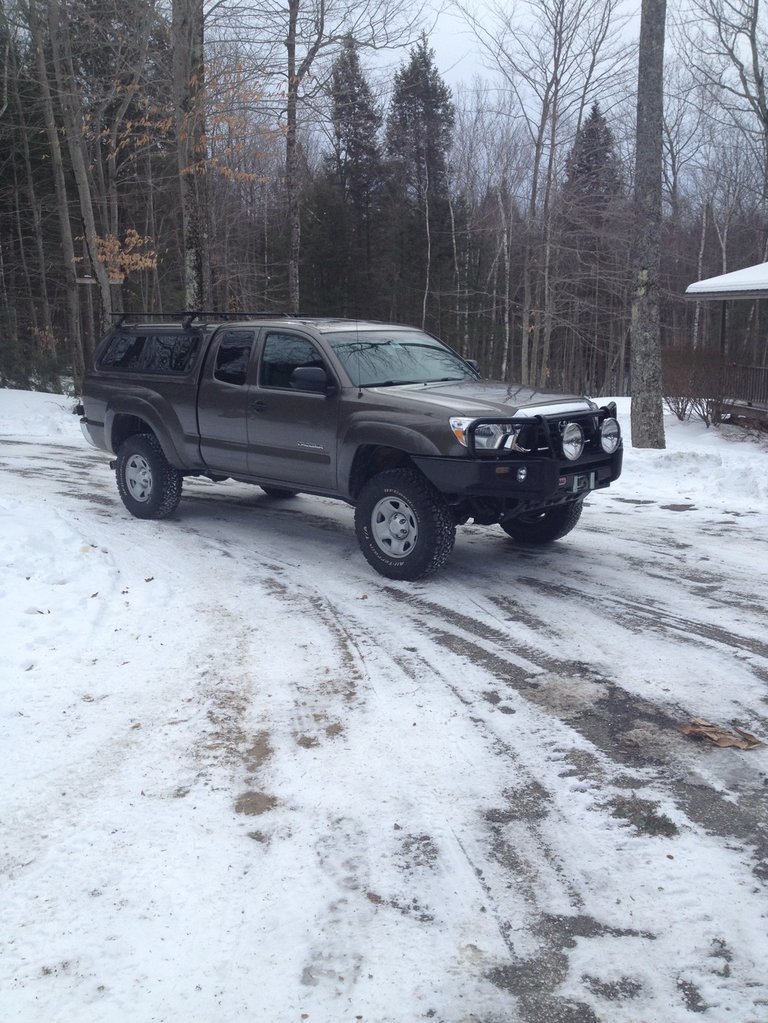

    Sorry for the delayed response. Here are some close up pictures of the 05-11 style ARB on my 2015:

    The gap isn't bad at all. I think this looks better than the newer style that sticks out further and leaves a bigger gap unless you trim the existing bumper. Time to start saving up for mine...
