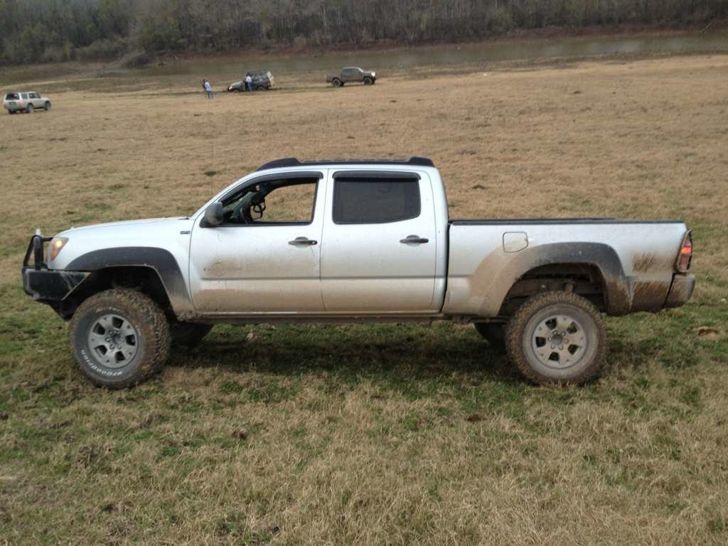

    This is a pure speculative post as my 285 BFG AT's have quite a good bit of life in them left, but here's the deal, over time of course my 285's are starting to look small to me and I feel like I need to go a wee bit bigger. I think I should be able to clear 295's with no problems but y'all let me know what you think.
    Front set up:
    5100's @ 0" with OME 886's supporting an ARB with warn M8000 winch, didn't have to trim at all anywhere to clear 285's and have a ton of room in all directions
    Rear: 2" block, 1.5" aal, OME N182's, I'm 100% confident they'll fit in the rear
    Wheels: OEM OR wheels with 1.25" spIdertraxx spacers
    So what do y'all think? I doubt I'd have to do the CMC but if I did it might be a deal breaker

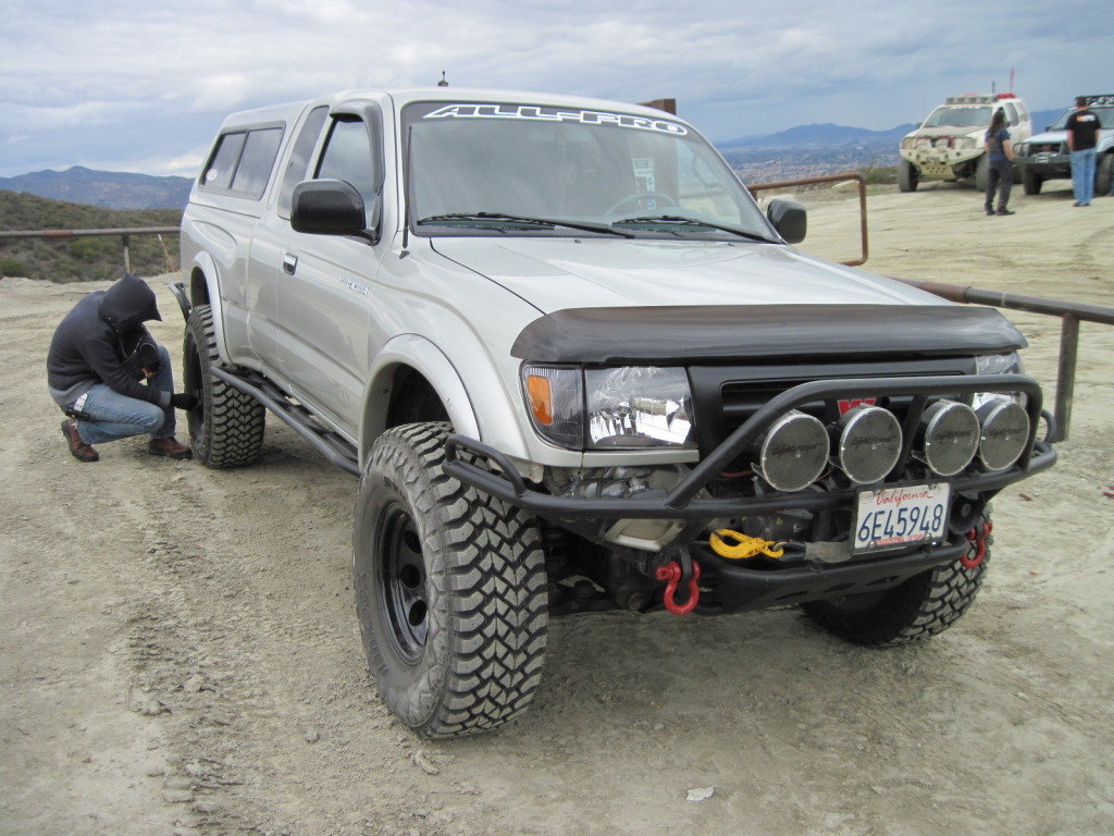

  5. Feb 24, 2013 at 11:19 PM
    TacoDell
    TacoDell Truck ~n~ Tow
    Jun 20, 2008
    #7448
    1,381
    SoCal
    '00 Tacoma SR5 4X
    Donahoe CO's, Deaver leaf paks, Lockright Locker, All Pro body armor ( sliders, front and rear bumpers ), All Pro under belly skids, Warn M8K w/Masterpull synthetic line, Dual Optima battery system, 4 ea LightForce Striker 170 offroad lights, 8 ea wired rock lights, and plenty more I'm sure
    I roll 295 Hankook RT03's on muh first gen.
    They measure 33.6" T (33.3" mounted)
    and 11.6" (ish) in width
    I traded up to these from 285/75/16 KMII's
    like these better...
    the RT03 295's only come in "D" load.
    whereas my KMII's were "E"
    ride is good...
    considering the 295's are bigger and a beefier tire construcion
    so tho' the ride is good on the hwy...
    It's not really much better the the 285 KMII 10 ply's were.
    What nets muh preference over KMII's... ?
    Off road... they do better in mud and snow
    On road... they offer better traction on pavement, rain or snow
    good price - onlinetiresdotcom

    i dunno man, those 285s look small on your truck LOL. be the guinea pig, ill follow if they fit. cause my stance is about the same as your. a little over 3" up front and more like almost 4" i the rear.

    yeah im bumped up a little further i think, everyone cant believe those are 285's because they look so small :(
