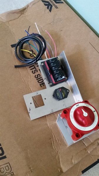

    Aux fux box, wire heavy gauge off the battery, 5 fuses with relay, 5 more just fused, all of them constant on. Ran one to the back of the truck for my bed LED (eventually to be upgraded/improved), others are switched in the cab for front lights, aux reverse, CB, etc.
