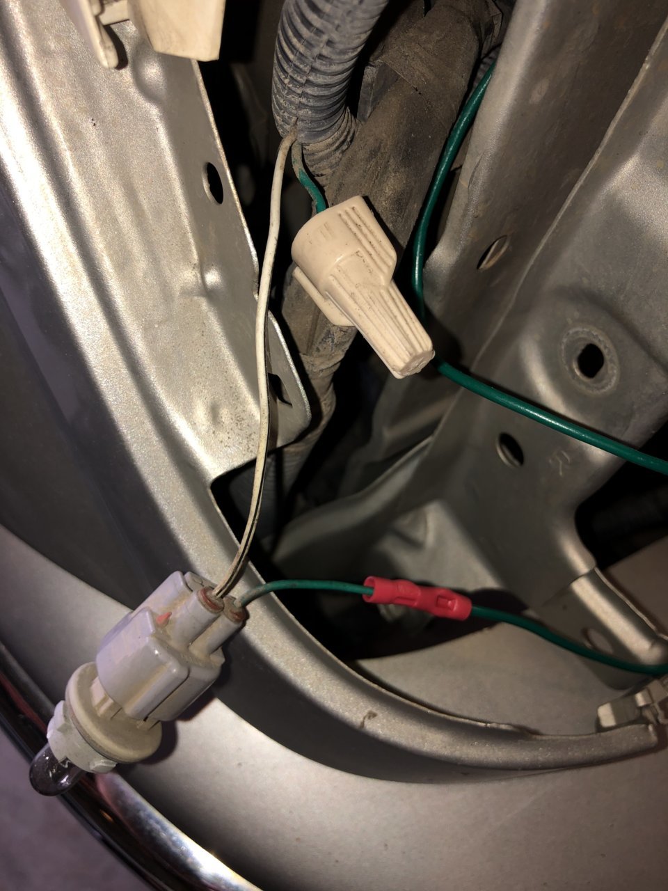

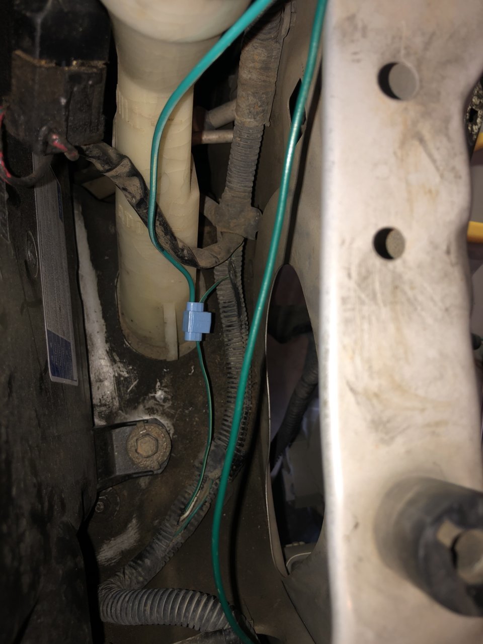

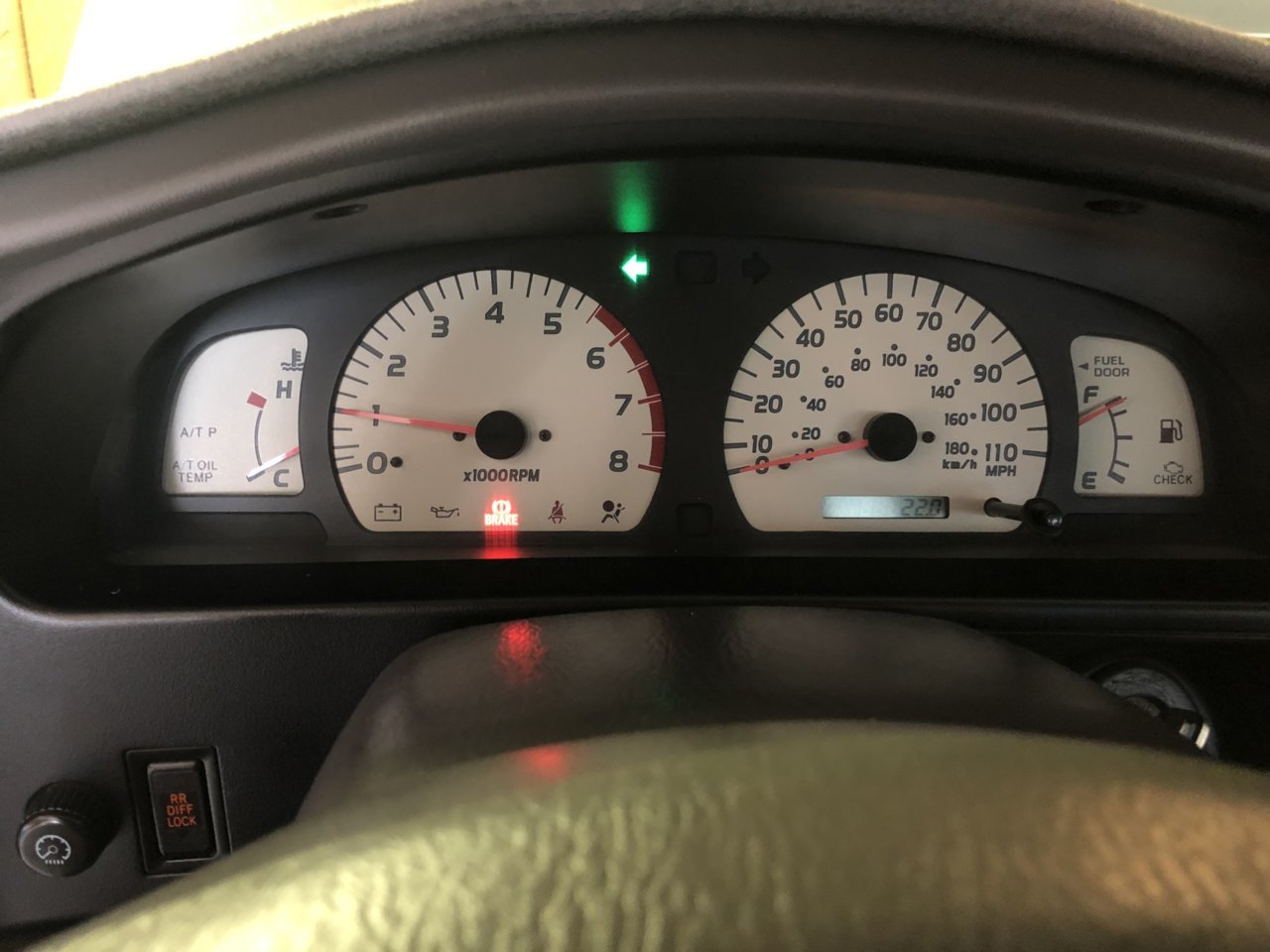

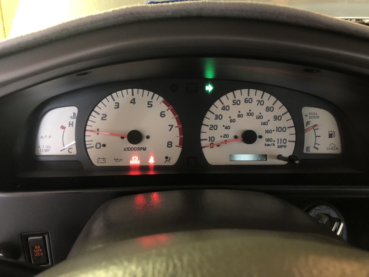

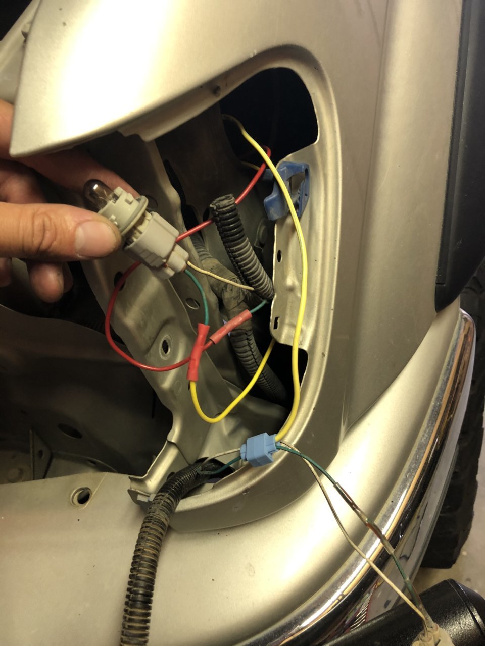

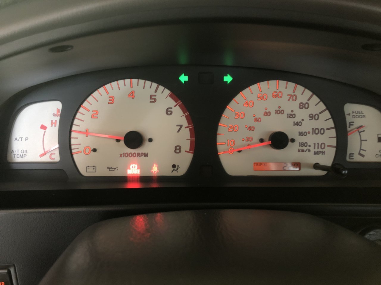

    I realize this is an old thread, but maybe someone can point me in the right direction. I finished with the install, but I’ve got some gremlins to work out. I completed the install in accordance with the video and the schematic that was in the video’s description, but it didn’t work as advertised and I’m leaning towards operator error.
    My side marker lights are now completely inoperable and my turn signals only work when my parking lights/headlights are off. Inside the cab, both turn arrows are illuminated on the dash when my parking lights/headlights are on. Does anyone have any pointers?3ECA6E86-16DE-4C2F-9525-4038D3159D3C.jpg0AC40ED6-CCFC-4998-A970-321BF5FB4AC2.jpg7BD031DF-B53E-4866-B032-A0FBF31AAA02.jpgD2B1C42E-1321-4131-8D2E-12978B483C5C.jpg757ED9AB-315D-43D3-88B7-10577558FB23.jpg02CC32CD-6E5B-4C04-8947-A84FB5ED7E23.jpgBBC066FC-5976-4BF9-9AC1-877E9AB4875C.jpgBA6162A4-AB2A-48ED-B41E-D24B855CEE32.jpg

    Disregard, fellas (not that I received any inputs). I’ve decided to apply the KISS (keep it simple stupid) method thanks to this source:
    https://youtu.be/IxxQh4Pxjkc
    It definitely works for the conversion and replacing the electronic flasher eliminates the hyperblink issue.
