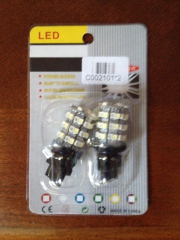

    First, get your 3157 bulb. I got these switchback LED bulb pair for $7.29 shipped from an ebay seller in New Jersey.

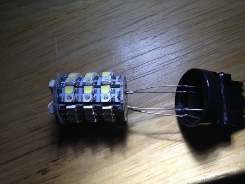

    next, straighten out the 4 pins and pull out the LED tower assembly from the socket.
    once the LED assembly is out, you can see the ground wires are tied together, and one wire for white (dim) and one wire for amber (bright).
    For CK bulbs, the inner pair of wires are the dim, and outer pair of wires are bright, with the two ground wires on one side (one on inner edge and one on outer edge of the side). All you need to do is identify which is white and which is amber, then reposition the wires and push it back out of the socket and bend them again.

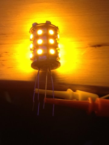

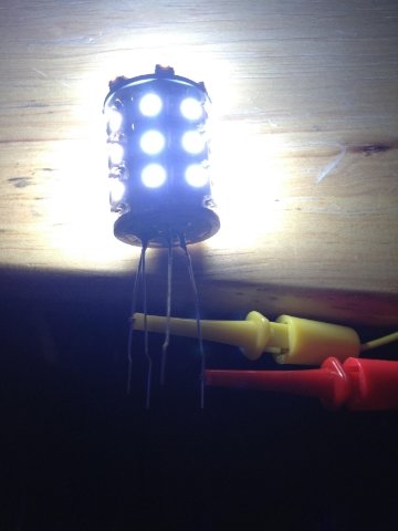

    you can use a 9v battery or any 12v adapter. remember which wire is amber and which wire is white.
    arrange the wires like this
    amber--gnd--white--gnd

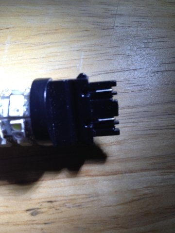

    and insert back into socket. you may need to twist and position the LED assembly so the wires do not get in the way of the socket. It may take a few tries, but you will eventually find the right position. Make sure you do not short any of the wires together (except for the two ground wires).

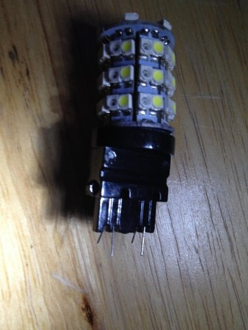

    This is the finished product. The wires may be a tad shorter, but that is ok, the contact is closer to the edge anyway.
    Before you plug in to socket, do one last check to make sure white and amber wires are not shorted to anything.
    looking at the above picture, the top (outer edge) wire is amber, the lower (inner edge) wire is white. On the other side, the top (inner edge) and bottom (outer edge) are both ground wires.
    I had to sand down the left and right edges of the socket a little bit (I used a dremel) since the socket is a wee bit too wide to fit into the light bulb socket. Once I got it in, it works perfectly.

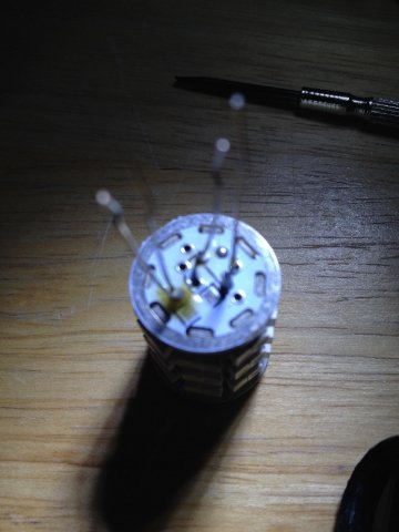

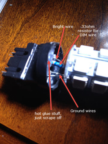

    I got another pair of regular 3157, amber only. These use 27 5050SMD, which is brighter than the 60smd switchback white/amber LEDs. On the bright connection, all 27 LEDS are on full brightness. That's equivalent to having 81 3528 LEDs used in the 60LED bulb for which only 30 are for white and 30 for amber, so it should be at least twice brighter. The DIM connection simply wires a 33 ohm resistor in series, all 27 LEDs still light up, but dimmer.
    with this bulb, the LED assembly is glued to the base using the hot glue gun stuff, so it is relatively easy to pry off with a small flathead screwdriver. This is what it looks like
    same as before, all that is needed is switch the two inner wire positions, then when bending the wires, bend the 2 ground wires to the same side of the wedge.

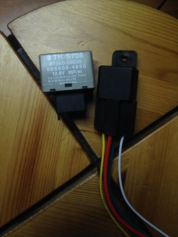

    I also got the 8 pin LED flasher relay and a regular relay I am going to use on my DTRL mod. Also got the add-a-circuit in the mail.
    got them all from ebay
    Toyota 8 pin LED flasher relay $8.75 (I literally got this in one business day, mailed from NJ on Saturday and got it in CA on Monday. US mail is fast)
    relay with socket $5.94
    add-a-circuit $1.29
    I'll wire these up this weekend. I might wire a truck bed LED strip as well. I got an RGB LED strip with remote control for under $10 from ebay.
