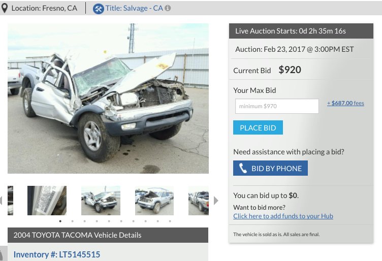

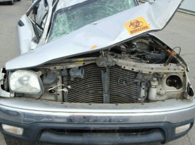

    Here's one of the ones on DashHub I saw (way too damaged) but it was interesting because it has Biohazard stickers on it. I don't think the driver walked away from this (from the obvious Biohazard warning). Point is, 1st gens on DashHub start at $900 dollars and most are in really good condition.

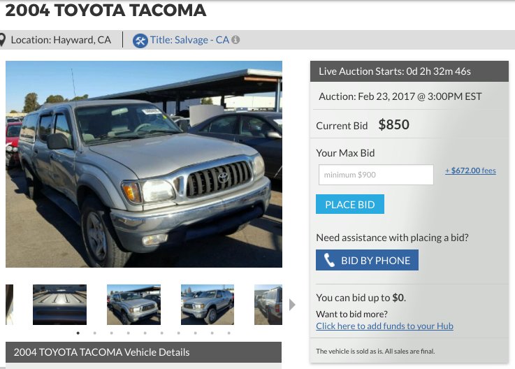

    Here's a good example. '04 Doublecab v6. Only 122k miles and it looks pristine. Starting bid is $850.

    How did the owner of this truck manage to damage it like this??? I mean, look at it... the front bumper is intact, but the radiator support member is pushed in and it looks like a telephone pole fell on the passenger side. How do people end up in these situations, honestly?

    I have a strong suspicion that no one in this truck made it out alive. I don't remember if it was this truck or not but I remembered seeing a speedometer and steering wheel covered in blood. It honestly looks like something fell on top of it.
