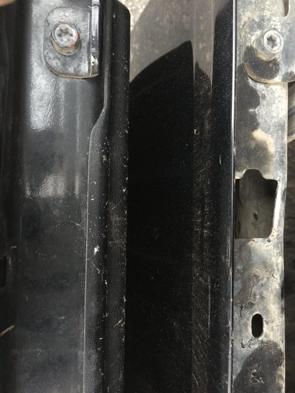

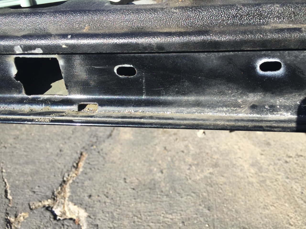

    Has anyone here done such a thing? I know it sounds odd but the camera ones have three additional holes on the bottom. One for the wiring harness and two for clips to hold the harness away from being crushed.
    I should have this completed by tomorrow so I will post the AFTER pic. For now, here are the BEFORE pic.

    Good stuff. Not sure if I understand though.
    My truck came with a camera and I was a beta tester for Pop-N-Lock for the one that splices into the door licks so that when the car locks, so does the tailgate.
    I have to recreate the openings on the bottom of the tailgate so that I can pass the harness up into the tailgate. The OE camera has a good sized connector that connects to the OE camera.
    I guess if I wanted to make a shortcut, I could just drill a hole, cut or unpin the connector, use a grommet to protect the pass through and the repin or splice the wires back to the camera connector.

    I think you're overthinking this, just put the wire in some sort of loom and run it through one of the drain holes (the drain holes were plenty large enough for the plug on the Pioneer camera). I installed mine several years ago and it's been fine, it doesn't pinch the wire or anything. Just use some wire ties/zip ties to help hold the wire loom where you want it so that you don't get a big loop of wire hanging out and call it good.

    Probably not necessary as this has already been done on this board.

    Anyone can provide sizes and exact location of the holes?

    I just drilled a hole on the far left side of the tailgate and you don't need any other holes.
