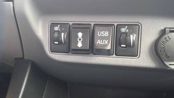

    Finished my install and found this spot for the switch.
    I had to use a dremmel to open up the slot (width) as the switch is about 2 inches deep and almost the size of the front.
    I recommend using epoxy for the window mount (the kind where you mix 2 kinds together). I tried it with rear view mirror "glue" and after letting it set overnight (the bottle said 4 hours) it separated right away. The gorilla glue epoxy has had no issues.
    Side note: I got the switch that you press once and it goes until the window is all open or closed. I thought it would then "switch" off. The actuater does turn off, but the switch stays in the "open" or "close" position, so in my mind it is still sending power. I just turn it to the middle position when done. Not a big deal, but was not what I was expecting.
