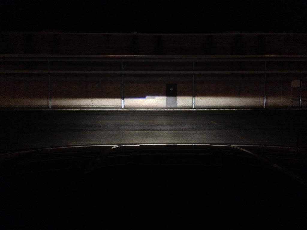

    Honestly my retro took me under 8 hours and I think it came out with a 9/10
    8638C30C-DA1F-440C-BE38-E5C631E87CF1_zps_8c83bfc4e46d8dd84d83b2a49ae8903d1e99923e.jpg
    I know what you mean though. It's scary, you can break stuff, mess stuff up, do things wrong. And then when you get it all put back together you can have wiring problems, bad bulbs/ballasts. But when you get all the kinks worked out. It's so worth it!
