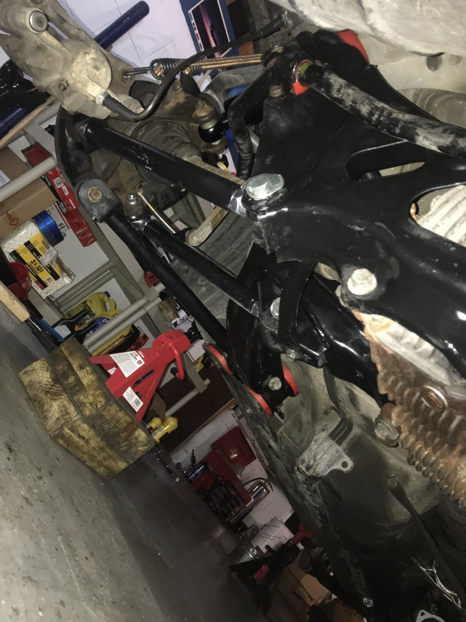

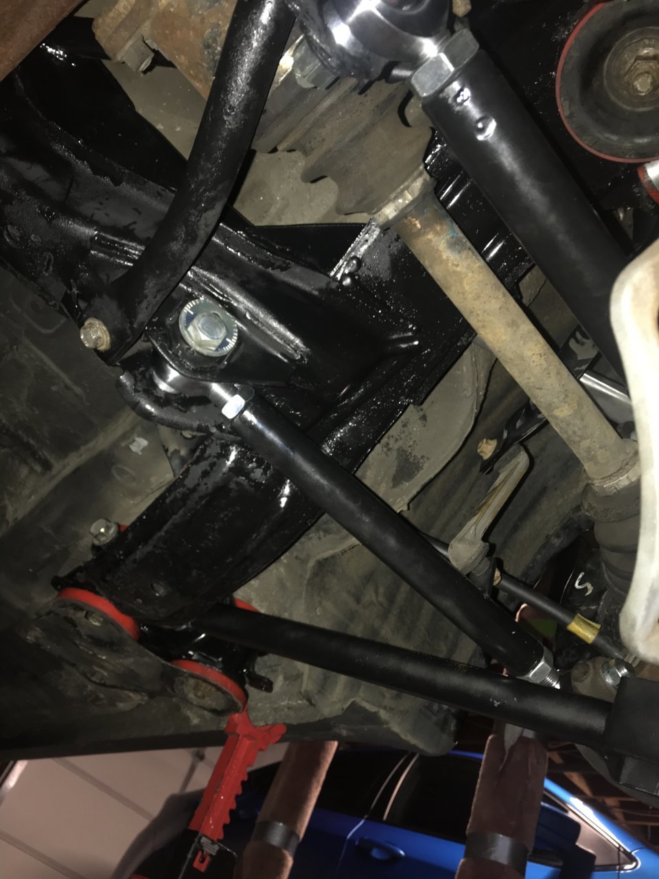

    Got my arms all installed last night hope to get my rear end all together except the exhaust but we shall see.

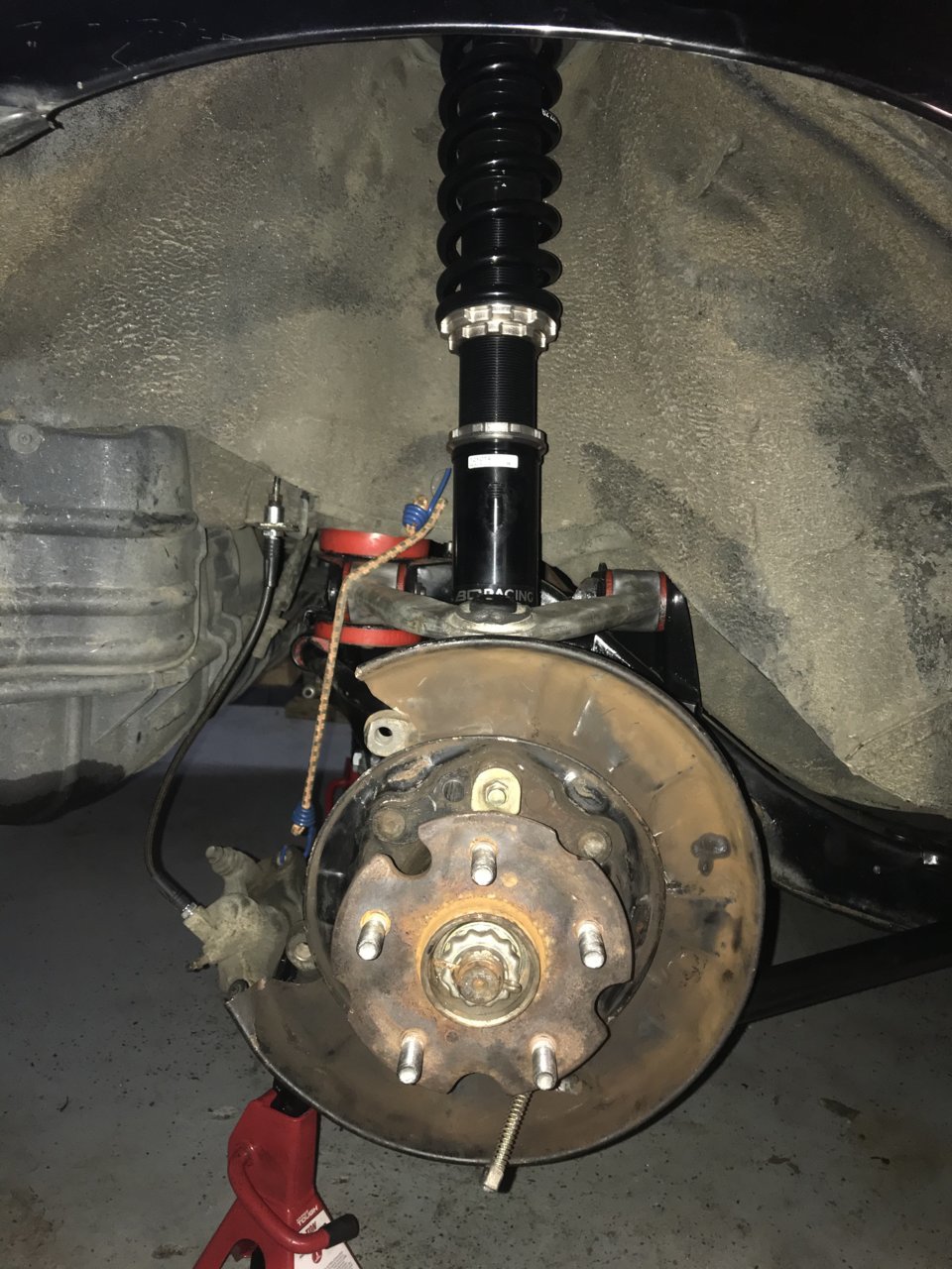

    Got the hubs back in and somewhat “aligned” At least the wheel looks straight. Definitely have to find a good alignment shop to get it dialed in. I won’t trust Firestone for this first one
    Tonight hope to get exhaust and take apart my rack and pinion, maybe mess with the rear brakes :notsure:

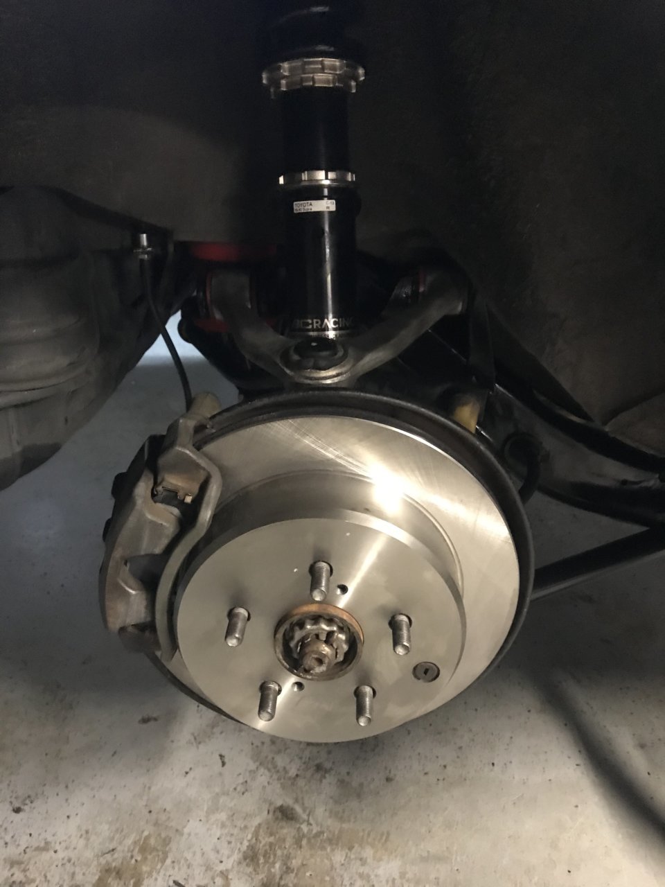

    Threw my rear brakes on, hopefully the ebrake works, looked a bit off when I put it back together but we shall see. I’ll need to break in the new shoes I put on it as well as pads and rotors. Should’ve just upgraded rear brakes as well but then I’d have to get them both painted and go down another rabbit hole. So next time!
    Also attempting to throw my rack n pinion back together! Wish me luck I can get it fixed :fingerscrossed: :pray:
    Edit: well I didn't fix it. The 2 tests (which I didn't do last time) is to make sure the oil seals worked and the second one to make sure the telfon and o-ring seal worked. Well it passed test 1 and failed 2nd test. Didn't know about the little o-ring behind the teflon seal so I think that's why my original rebuild failed. So I replaced that but in doing so I ruined one of the seals (the racks teeth getting pulled thru it) so once I got it all together it failed both tests due to that bad oil seal. Got 4 seals on order and hopefully I can pick them up tomorrow from the dealer....if not it'll be another week or two since I'm going on a work trip next week. :frusty: Can't fucking win with this damn thing.
    But I did get to bleed all of my brakes and the new double flares I put on seem to be holding which is great news! Will be monitoring them once I get driving again. Shipping out the wrong exhaust tomorrow so hopefully by sometime in August I can get my correct exhaust on, in the mean time probably gonna throw the old on back on just to break in the new stuff and fix any other issues that come up

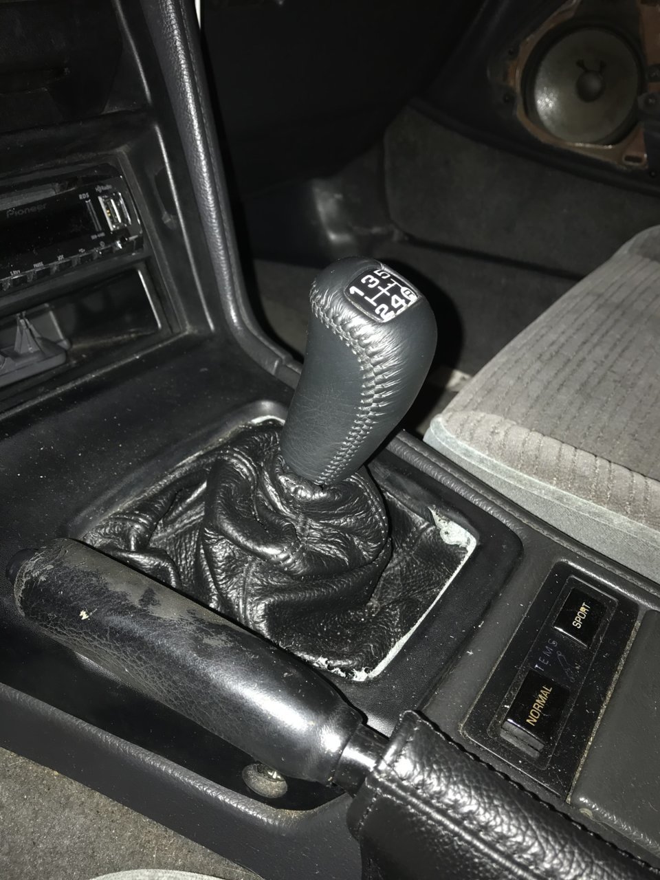

    While I wait for the last few parts to show up I snagged a modified stock shifter from a local guy. Basically just cut the stock one down by 2”. Figured for $25 I don’t have to mess my stock one up if I don’t like it
    Probably gonna keep this for a while, maybe I’ll switch to a short throw shifter and cut it down since I don’t like how high they are
