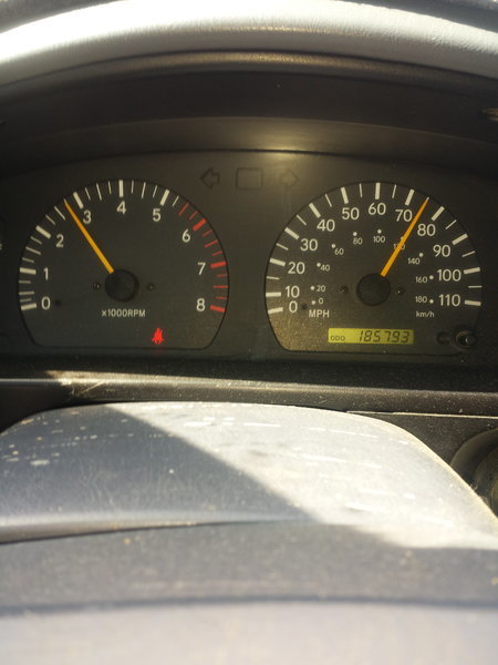

    #166714
    3,691
    Jeromey
    big bear lake, CA / lake havasu, AZ
    1999 toyota tacoma 3.4l v6 sr5 4x4
    Took this today, I am right at 2750rpm's at 75mph on 4.10's with 285/75's.
