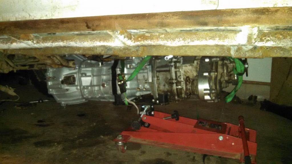

    So after going thru your build I saw this pic which I think may have answered one of my questions but wouldn't hurt to get a confirmation
    There weren't any plugs on those 2 "vents" on the top and the driver side of the bell housing?
    Also to get the input shaft seal is taking the bellhousing off required? I'm having conflicting info and would rather not if I don't have to.
    Here's pics of mine

    I assume you are talking about those rectangle slots? Nope no plugs. You dont HAVE to take the bell housing off to get the cover for the input shaft seal off, but it makes it alot easier and its and extra 2mins worth of work. I would do it because you can then get a torque wrench on on the cover plate bolts and it's one less thing to have to work around.

    Ok awesome, was freaking me out for half the day since I couldn’t find any PN to replace them.
    Yup got the bell housing off, now I have to get permtex or whatever that stuff is before I take it off. The FIPG stuff
