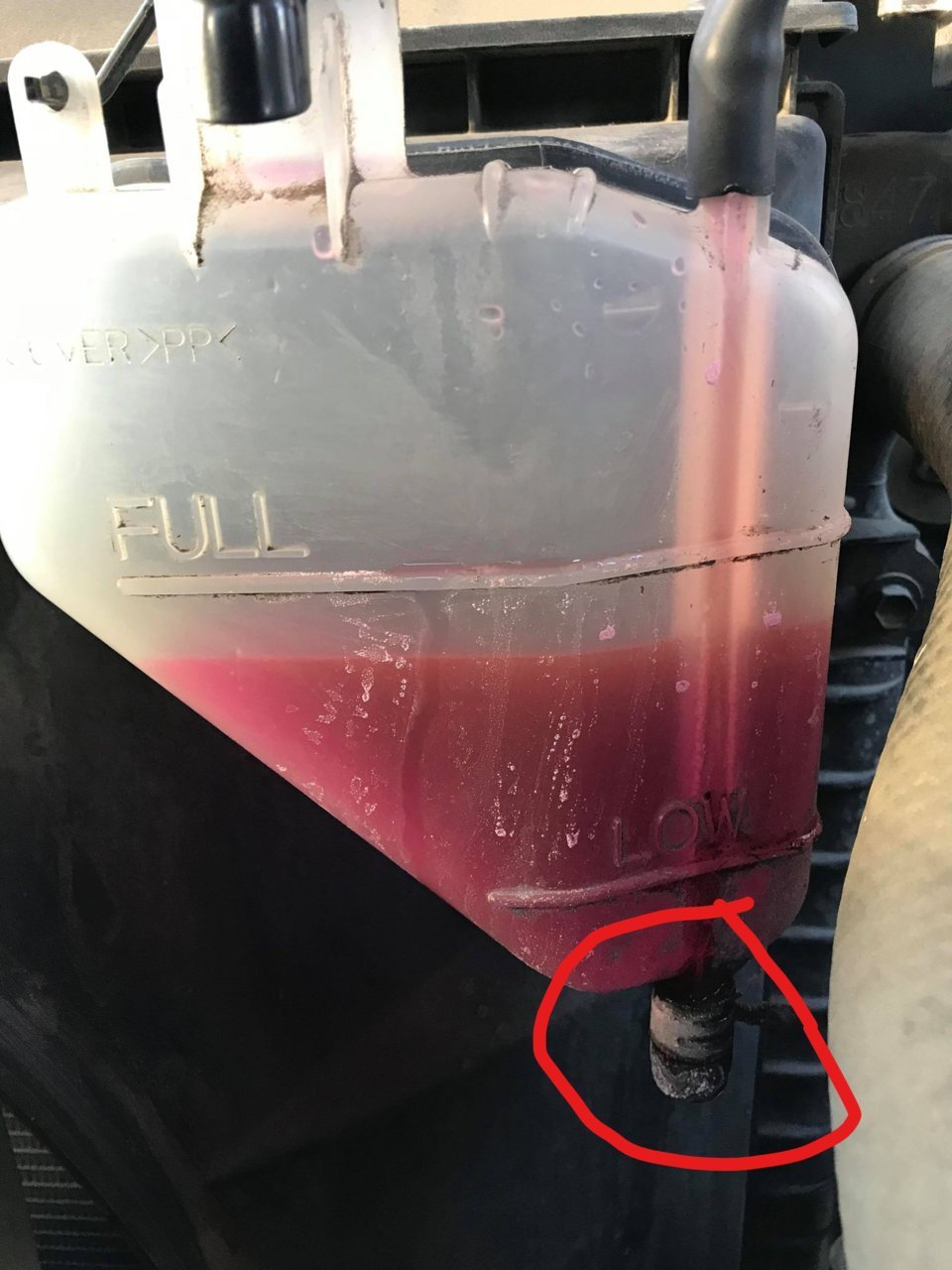

    Does anyone know where to find replacements for this rubber hose cap thing on the bottom of the coolant expansion tank?

    Does yours leak from this plug?

    Yeah, it’s cracking and starting to seep through slowly

    do you remember if you were smelling coolant because of the seeping?

    I'm having the same thing. Buying a metal screw clamp to re-tightened the top hose (there's some wetness and dried white powder on the outside of the reservoir apparently originating from the top hose entry), and a makeshift plug that's originally meant to be used as a bypass caps for the bottom plug.

    Update:
    Added metal clamp. Also, my bottom plug seems perfectly fine, so I guess I'll put it back and see if that does it.
    The rubber plug seems fine, no cracks, still flexible and rubbery.

    Unfortunately I had no luck. Fortunately mine was just a bit loose, so fixed it with a steel hose clamp.
    This worked because mine wasn't cracked.
    The most I ever found were options to buy the whole thing, reservoir included for over $200.

    Upon further inspection today: added about a quart of fluid to radiator... seemed like a lot, but no leaks while it sat. Ran engine till it got warm and then another 10 minutes. There was overflow fluid in reservoir (a good thing, I think). But the overflow hose at the top was also leaking some down the sides of the reservoir. Going to let engine cool, inspect, then add hose clamp. Hopefully this is the cure, and source of low fluid.

    I ordered the bottom plug , top over flow hose and a new radiator cap from an online Toyota dealer.
