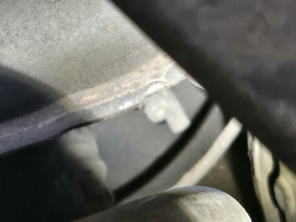

    I know this is years late, but for the benefit of future users' reference:
    I'm pretty sure you're supposed to loosen the little bolt at the end of the drain. That's how to make the coolant flow down the tube. I don't know what that bolt above it is for, but it's not necessary to drain the block.
