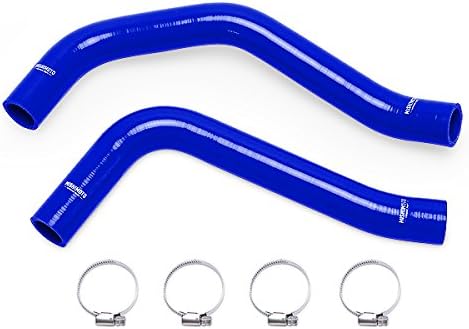

    This Mishimoto Blue Hose kit looks saweet but I'm having a hard time forking out $85 more dollars just for the blue vs the Gates hoses.

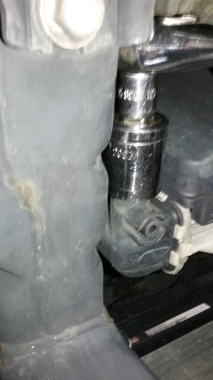

    A 22mm socket works great on the Drain Valve for the radiator.
    It fits right over the wings and helps getting it loose a lot easier.
    I used a 6-point socket.

    I canceled The Asian Red coolant order and decided to pay $6 more a gallon for the blue formula(same stuff differnt dye).
    Now I'm waiting on Amazon to confirm the cancelation on the Gates hoses so I can order the Mishimoto Blue hoses.

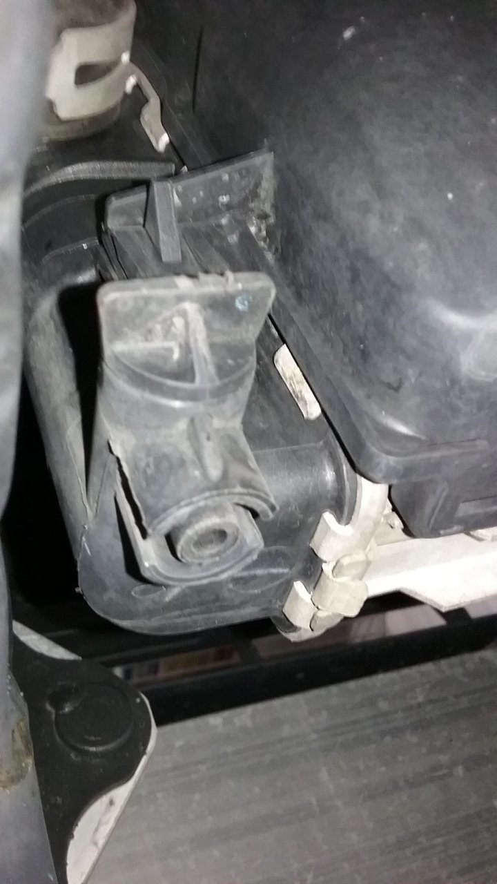

    That's how I do it. Just be careful when tightening. Easy to over torque it.
    Crom and TnShooter[QUOTED] like this.

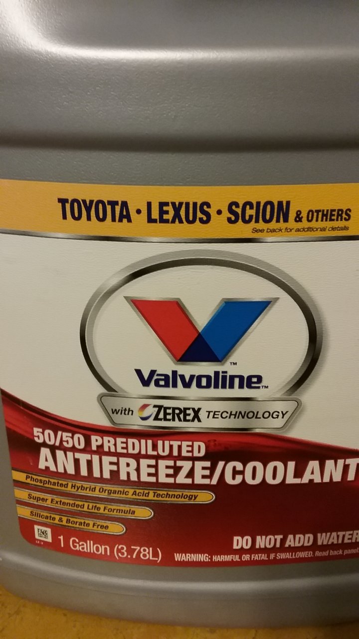

    My juice of choice. Walmart...$13.
    ABNFDC and Jacked Burton[OP] like this.

    Worm clamps can bite into hoses.
    Not sure why anyone would want a silicone rad hose. It's probably stiffer and seals not as well, requiring tighter clamping.
    Silicone hoses are often used for turbocharger related piping including intercoolers, TIP's (Turbo Inlet Pipe), and so on. Not radiators.

    Another vote against the silicone hoses, yeah the color is cool and all, but silicone hoses are more likely to tear and split and when they do it runs, speaking from experience here after installing a mishimoto kit on a Miata, they also fit a lot tighter, and the worm clamps as other people say caused the hoses to mushroom and or get tore up.
    They also don't have as good abrasion resistance as the fiber reinforced rubber hoses do. I'd stick with OEM or the gates hoses save the silicone hoses for race cars, ultimately the reason they exist is just to be lightweight and look cool, but if you do any kind of off-roading I don't believe it's worth it.
