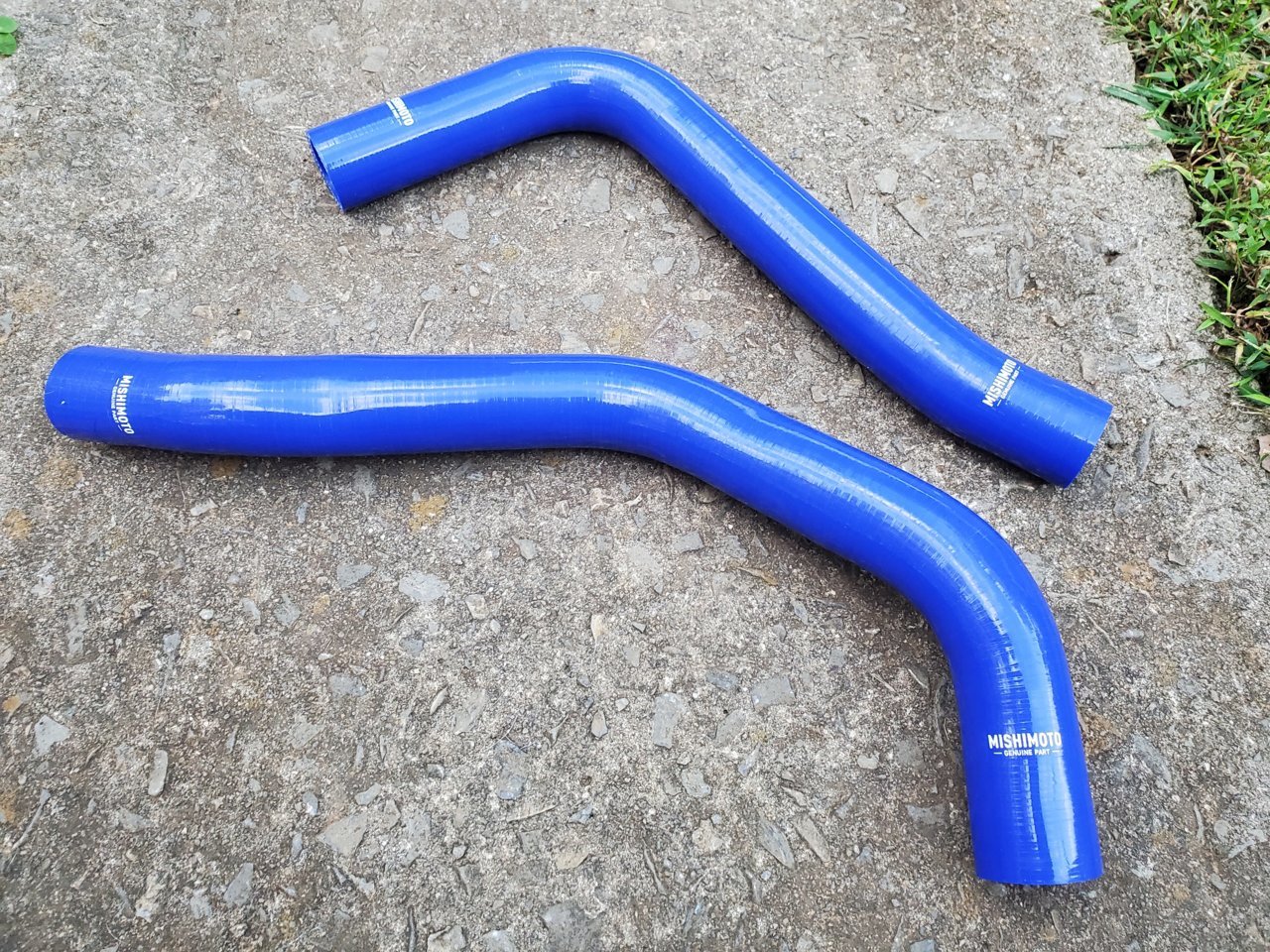

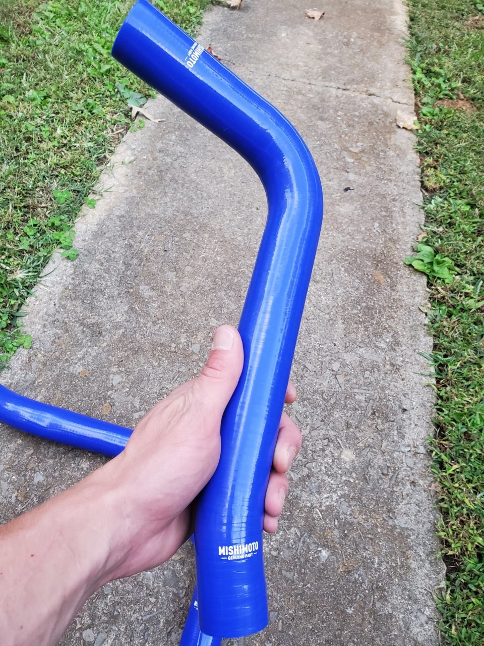

    Mishimotos arrived today.
    Much happier with this shade of blue.
