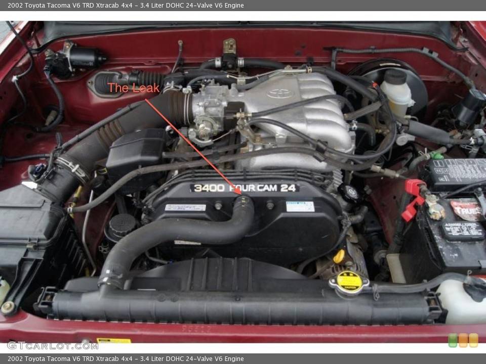

    2003 3.4. I'm getting a consistent leak from the upper hose where it attaches to the front of the engine.
    At first I thought I had the host clamp too loose, but I've tightened it up pretty good. So, my problem is something else.
    That piece that that the hose goes over has a little metal tab sticking strait up. Is the hose supposed to go over that tab, then get clamped, or is that tab a stop of sorts and the hose should go to that point, but not beyond? Or, something else?

    As I recall, the pump is about half way down behind the fan. That's not where I'm talking about. I'm talking about the top center front of the engine. Right where it says 3400. Hang on, I'll find a representative picture . . .

    Here's the problem:

    Yep, that's where I'm talking about. Do what i and others suggested about cleaning and report back
