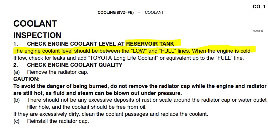

  5. Nov 28, 2022 at 5:29 AM
    gclyne
    gclyne [OP] Well-Known Member
    Aug 30, 2019
    #303714
    104
    Grant
    Indiana
    2004 TRD Off-Road- 3.4L
    My radiator was busted at the seams. I bought a Duralast radiator from AutoZone and did the swap yesterday. All seems to be good now. The Duralast radiator fit perfectly and is almost identical to the OEM one.
    @Area51Runner do you have a link to the Service Manual you could share? I've looked on Ebay/Amazon and the hardback is outrageously expensive.
    I'm going to tackle a full transmission service next. Oil Pan, filter, and all.
    Thanks- Grant
  6. Nov 28, 2022 at 8:03 AM
    Area51Runner
    Area51Runner Well-Known Member
    Jun 26, 2014
    #132748
    11,977
    Northern California, Bay Area
    02 3.4 DC TRD PreRunner 4WD SWAP
    I don't, sorry.
    There is a thread, might find what you're looking for there.
    https://www.tacomaworld.com/threads/2001-2004-tacoma-factory-service-manual.5696/
